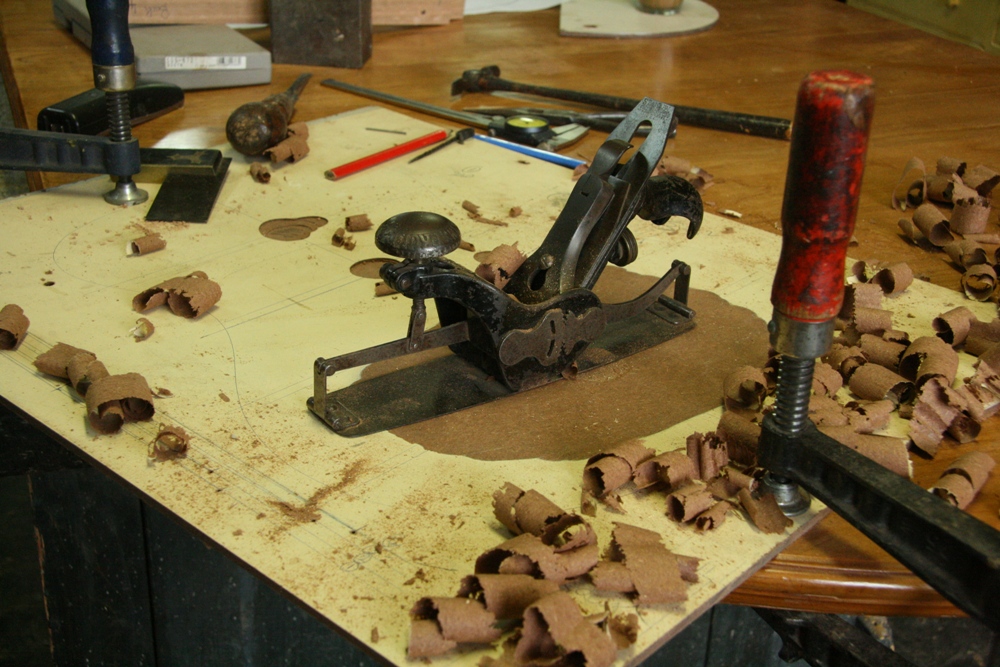

With all this dishing , and if you like tool shopping ,a good tool for the job is the Stanley 113 compass plane.
They turn up on ebay for between $120 to $200. I did the front and back dishes for my first build with one. With a curve ground in the blade as well as the curve in the sole they eat through MDF or as in my picture Masonite beautifully .
I routed a center point out first to the exact depth first and planed till I almost got to that depth and at the same time out to the pencil line at the edge. From there I went with sand paper.
For just a small one off you probably don't need it , something to think about though :)

:shock: :!: .......... Talk about shock'n the bjeezus out of a man Rob....First glance at the chocolate coloured shavings in that image and I thought you had gone berserk'n compass planed ur way right through a set of spruce and then on into the top of ur freak'in mahogany table. :lol:

auscab wrote:Stu,
Rob that is the same model I have. The beauty of the compass plane is when the desired radius is reached the plane stops cutting. In the past I've used it to make patterns for the router and spindle. Lately it's been used upside down in a vise to fit tone bars in mandos, set larger than needed because the bars aren't a constant radius.
