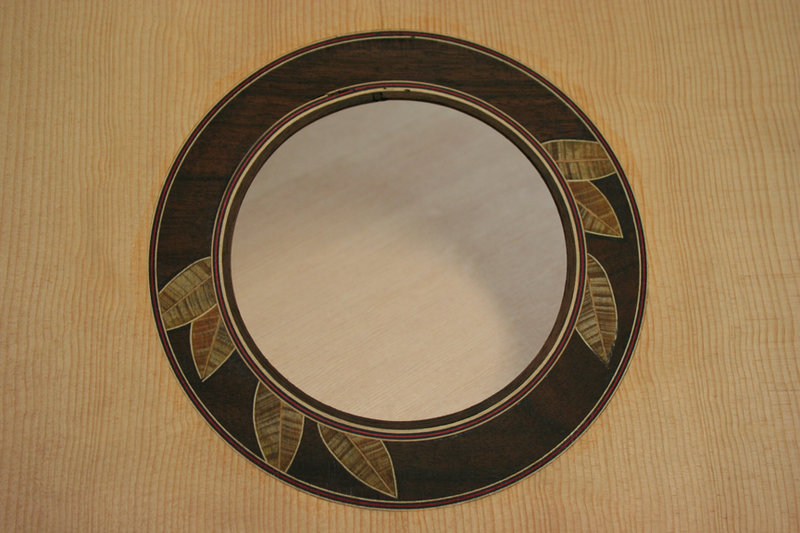

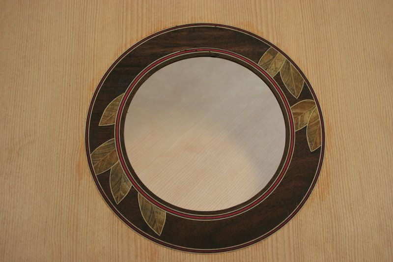

Hi Folks, here are some rosette i did recently for some new guitars that'll be on display ( for sale ) at the coming Osaka Guitar Show 2012. enjoy! :)

Nice! :cl
P Bill
Posts: 521
Re: Malaysia Spring
Post by P Bill » Sat Apr 07, 2012 10:06 am
They really take me away somewhere.
Re: Malaysia Spring
Post by Lillian » Sat Apr 07, 2012 1:35 pm
Those are beautiful. I look forward to seeing the whole package.
Re: Malaysia Spring
Post by Mark McLean » Sun Apr 08, 2012 12:33 pm
I really like those Jeffrey. What woods do you use? Can you tell us how each leaf is constructed?

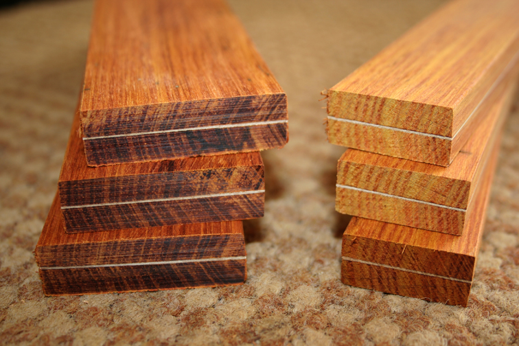

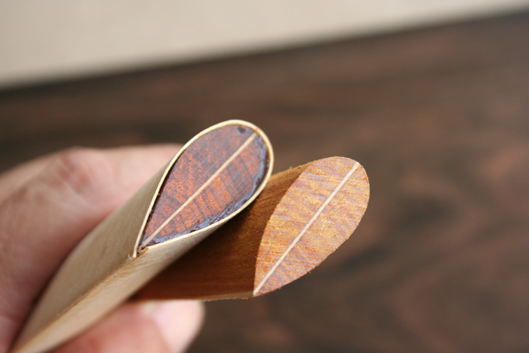

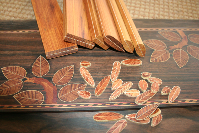

Here are some idea how to make the leaves, you can also use other wood which has striking cross grain, the wood i used for the leaves are pine( green ) and rengas ( red ). You can also laminate together other pieces of colour wood to make other pattern you like.
First you cut and glue book match blank with a maple veneer in between and later shape it like a leave and bound it with another layer of maple veneer. Cut into slices of about 2mm thick and use them like other inlay materials. For the rosette, I inlay the leaves and later cut to size of the rosette using a router. I use superglue to seal the pores before finishing. Hope the pictures explained what I'm trying to say. Enjoy!

Beautiful work Jeff (as always) and very kind of you to share this great tip with us. Must ask if you would you mind posting a version of your method in our tutorial section? It would be a simple matter of copying and then pasting what you have shown here into a new topic.
viewforum.php?f=5
Perhaps you could rename it " Making wooden leafs for inlay". That way anyone searching the word "inlay" may be inspired by your simple yet affective and very attractive method..I know I have been 8)
Re: Malaysia Spring
Post by Mark McLean » Tue Apr 10, 2012 3:14 pm
That is a brilliant technique Jeff. Thanks for sharing it!

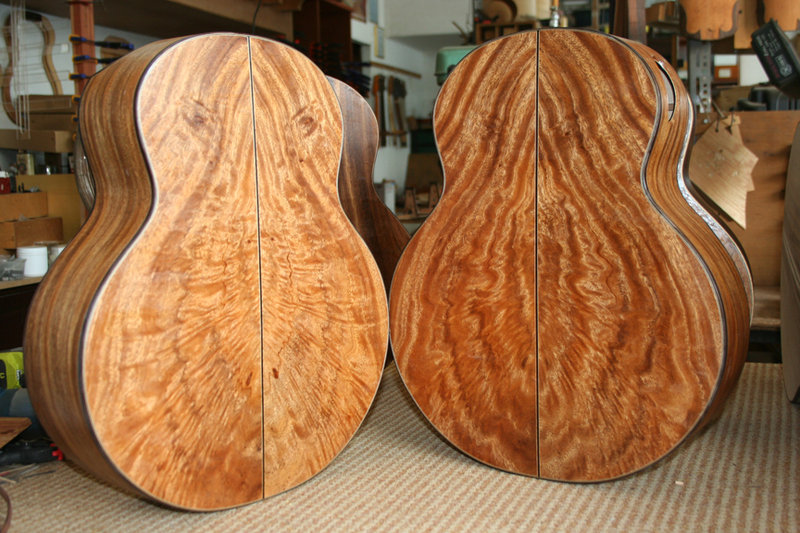

here are the backs.
auscab
Posts: 650
Location: Melbourne Australia
Re: Malaysia Spring
Post by auscab » Tue Apr 17, 2012 11:25 pm
Wow Jeff ,
wood like that must help out a sale , thats super stunning !!
