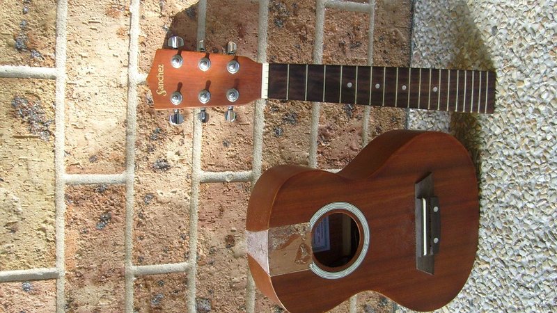

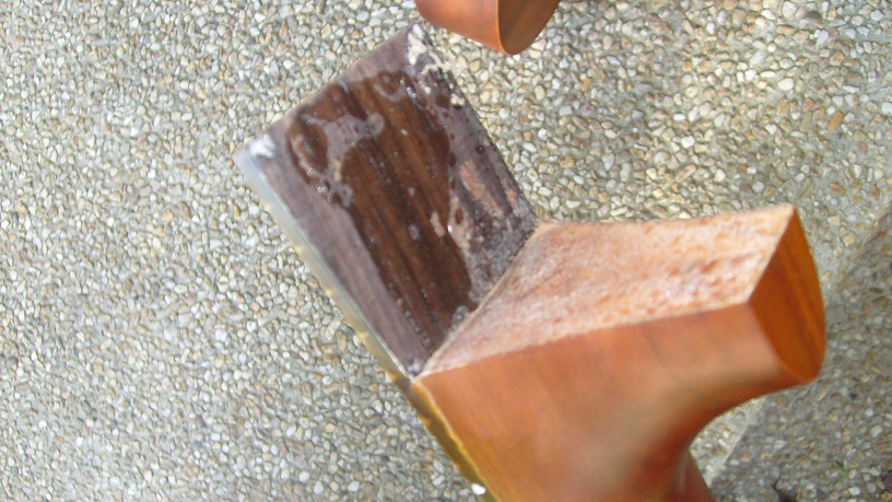

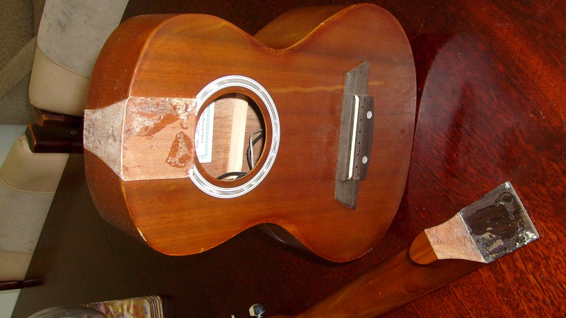

Hi All, I have been asked by a friend to repair this small travel guitar, this a steel string with a 17 ¼ “ scale length , he returned it to the guitar shop where he bought it and got the usual reply from the salesman that he had “subjected it to heat which caused the failure” this is only a cheap guitar, but I don’t believe that it is suitable for the purpose that it was sold , What do you think ? Also if I simply reglue the butt joint how long do think it would be before it fails again, opinions please.

Aside from regluing, could you hide a insert/bolt or dowel in the heel?
As for being suitable for the purpose I'd argue it's not. If it's supposed to be a steel string travel guitar it should be a little more robust and an afternoon in a hot car shouldn't cause it to fold it in half. Can't really blame the salesman unless he sells another while knowing of the potential for failure I guess?

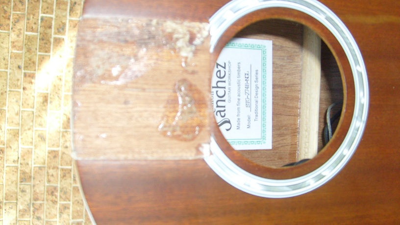

Tod, the label says "Traditional Design Series"....since when was nothing to join the neck on a traditional design... :shock:
Is that hide glue on there?....or just wishful thinking.

It just looks like a bad glue job, maybe a friday job.
Clean it / glue it properly and it will be fine. Doesnt need a bolt or insert, that being said nothing wrong with fitting one, martins are doing it now as a factory fit.
