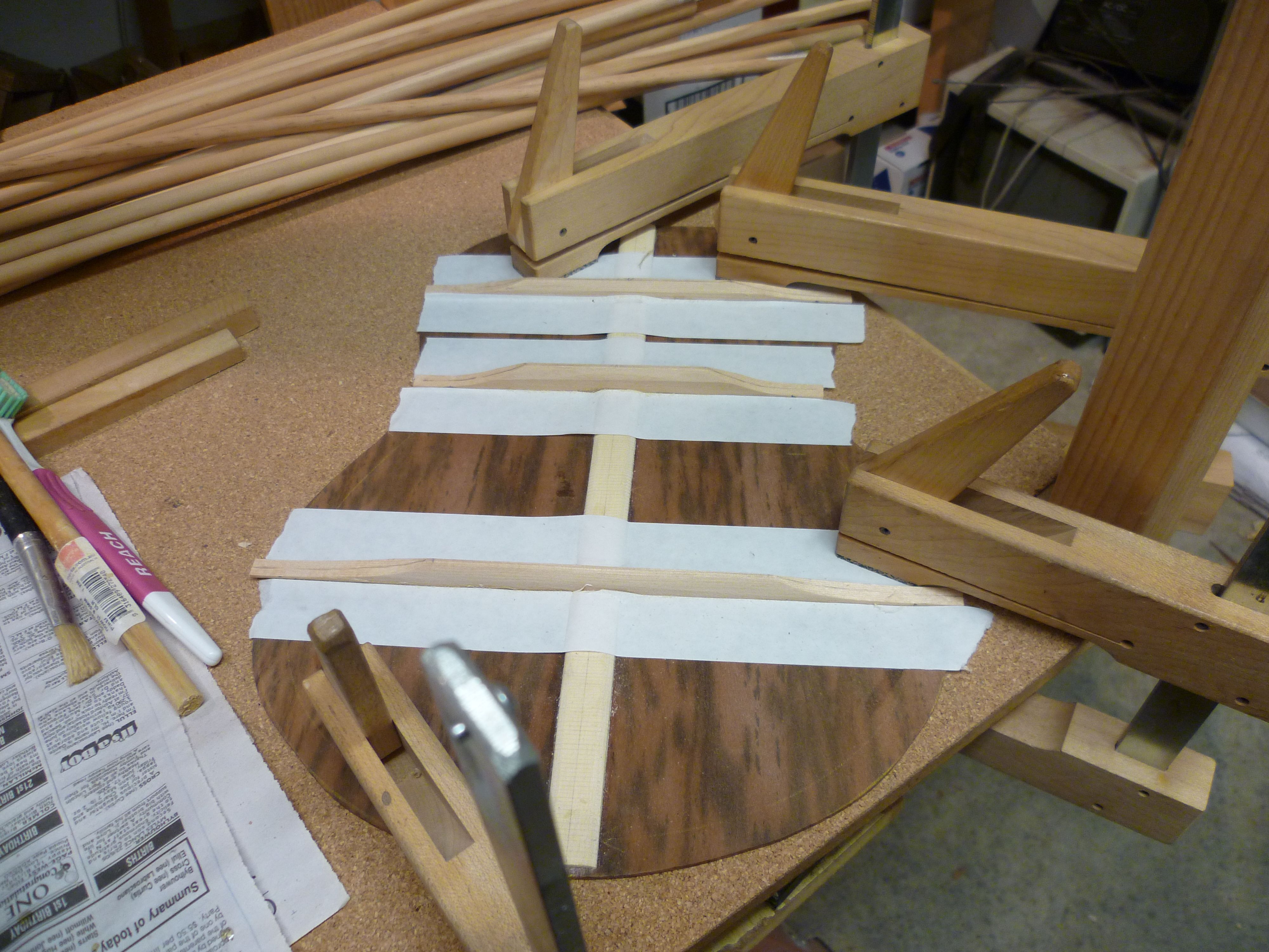

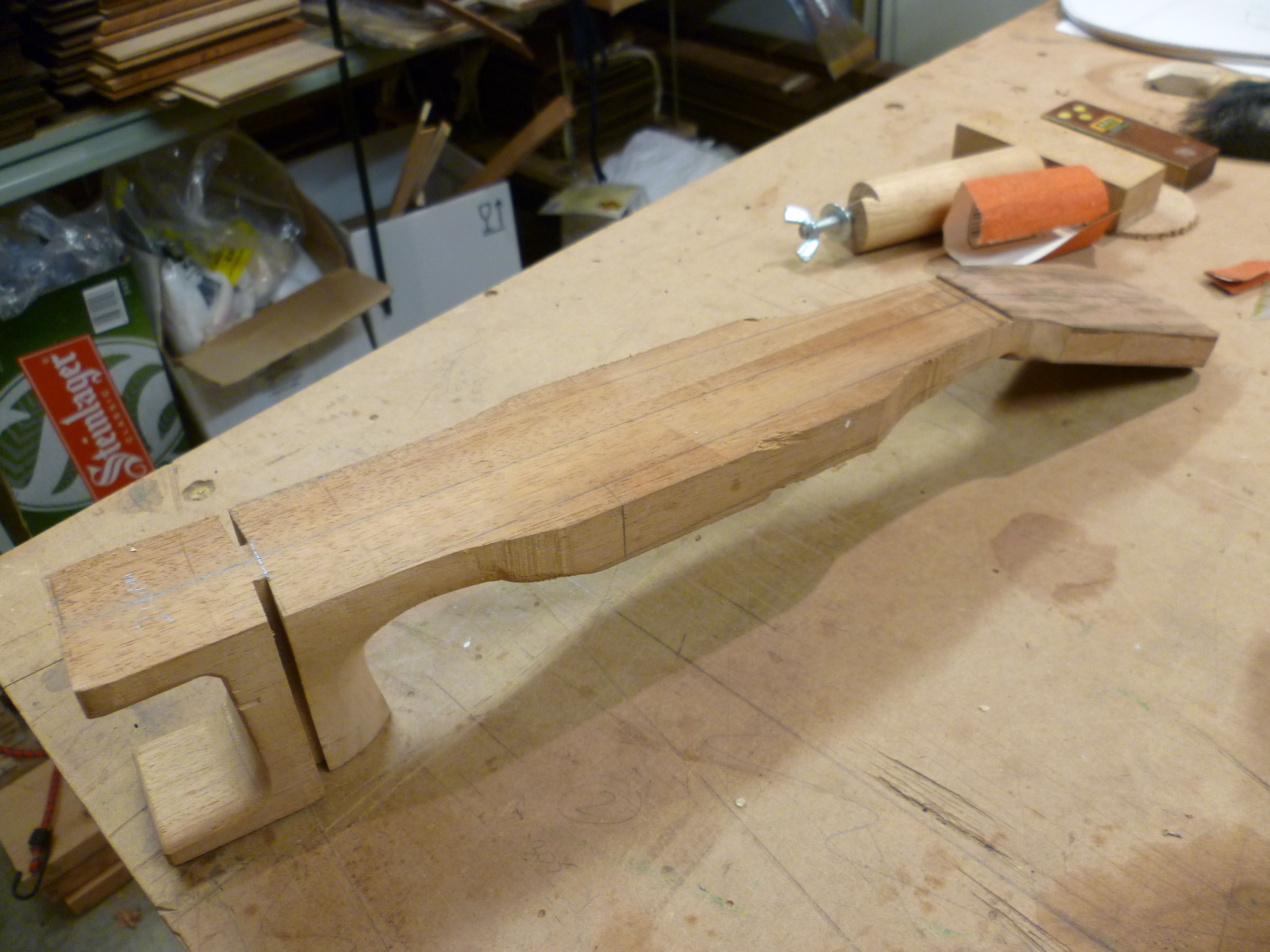

My sister plays uke and has often asked me when I'm going to build her one. With my return to work delayed for a few weeks I decided to get started on Steph's uke a few weeks ago. Not many pics but here's where I've got to. The Honduras mahogany neck was rescued from a failed steel string neck. The back and side set is Tiger Myrtle...from Tim I think. Top is bearclaw sitka. Fan braces are still a bit chunky and need some meat taken off them.

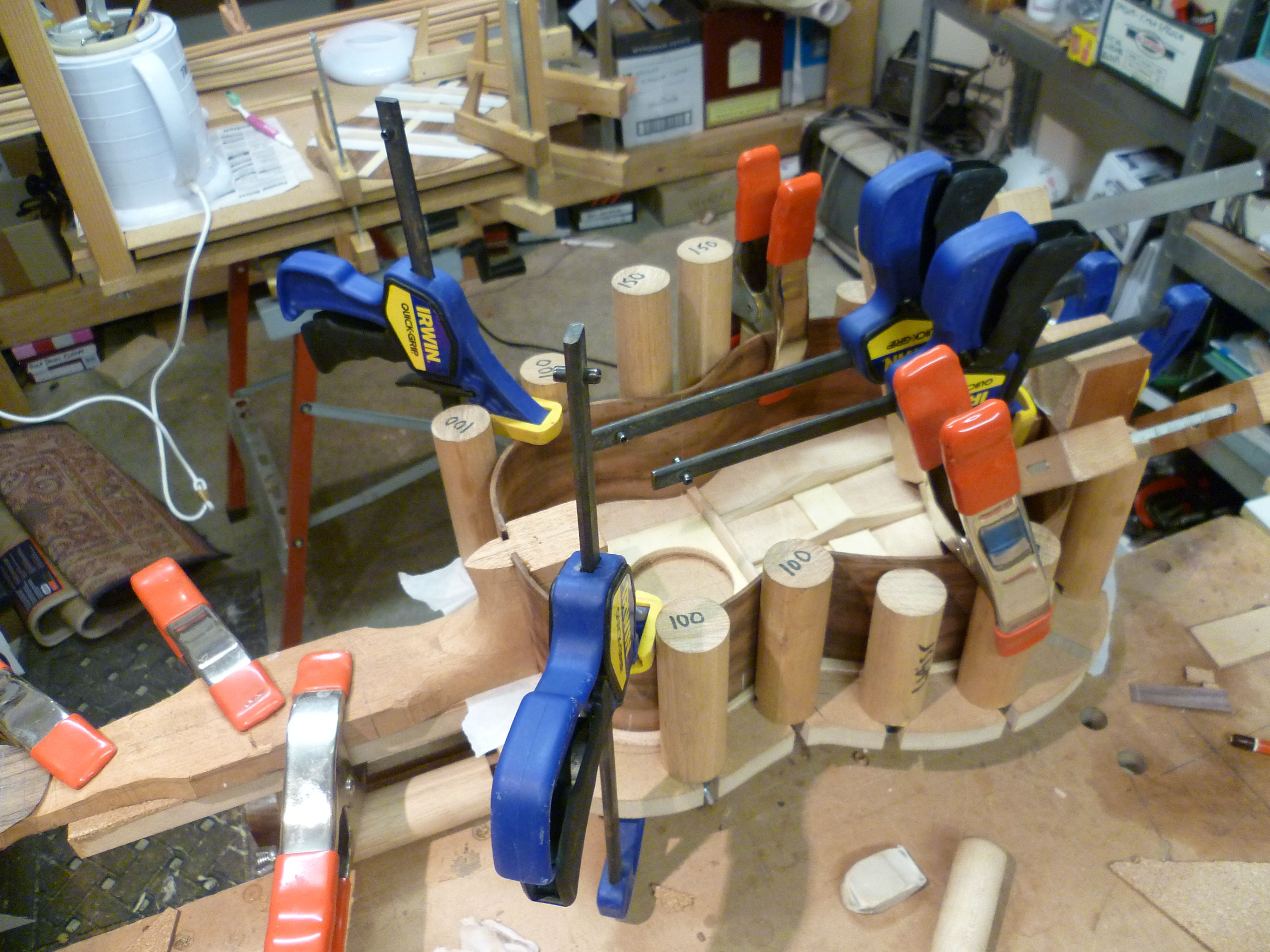

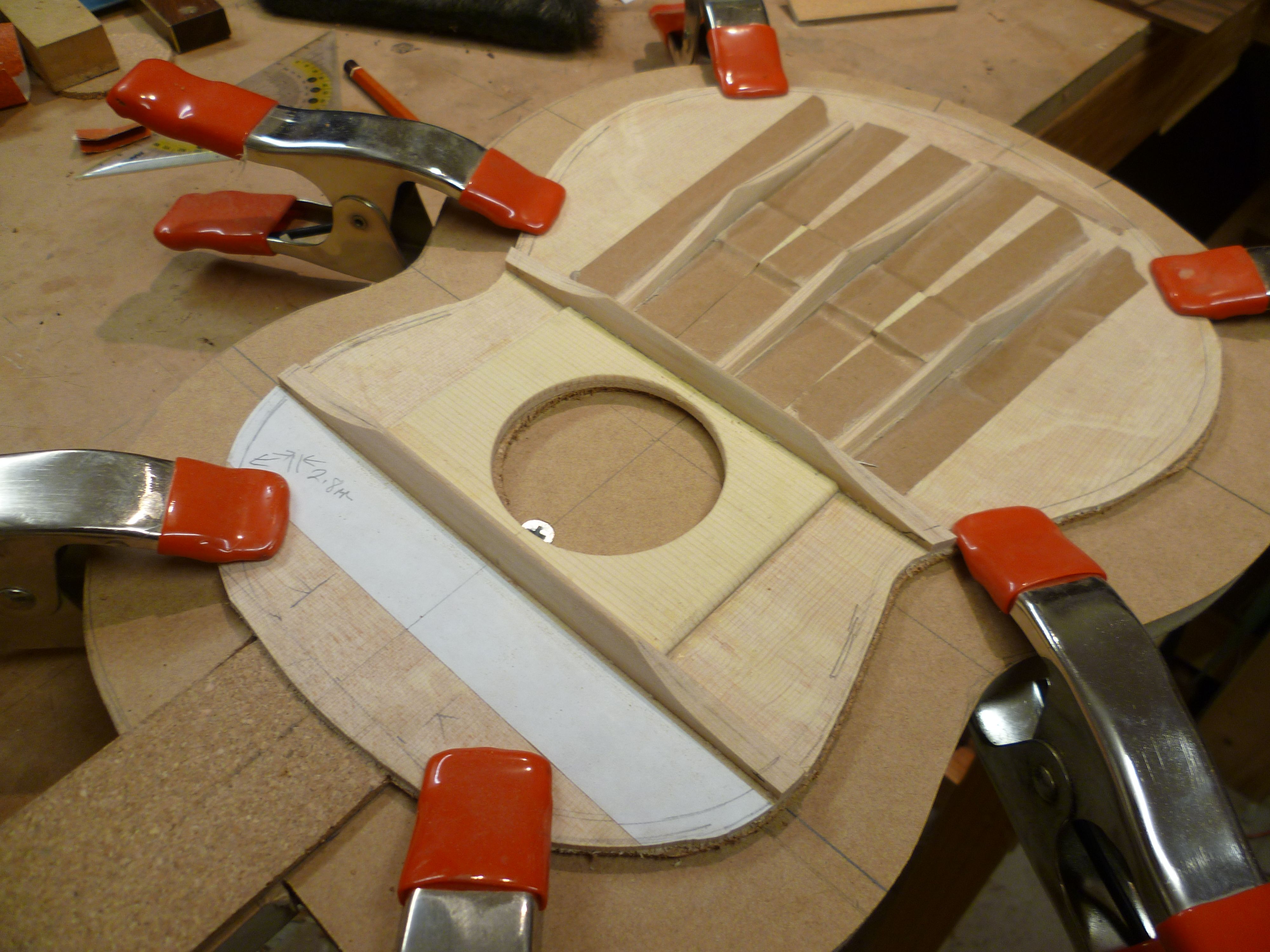

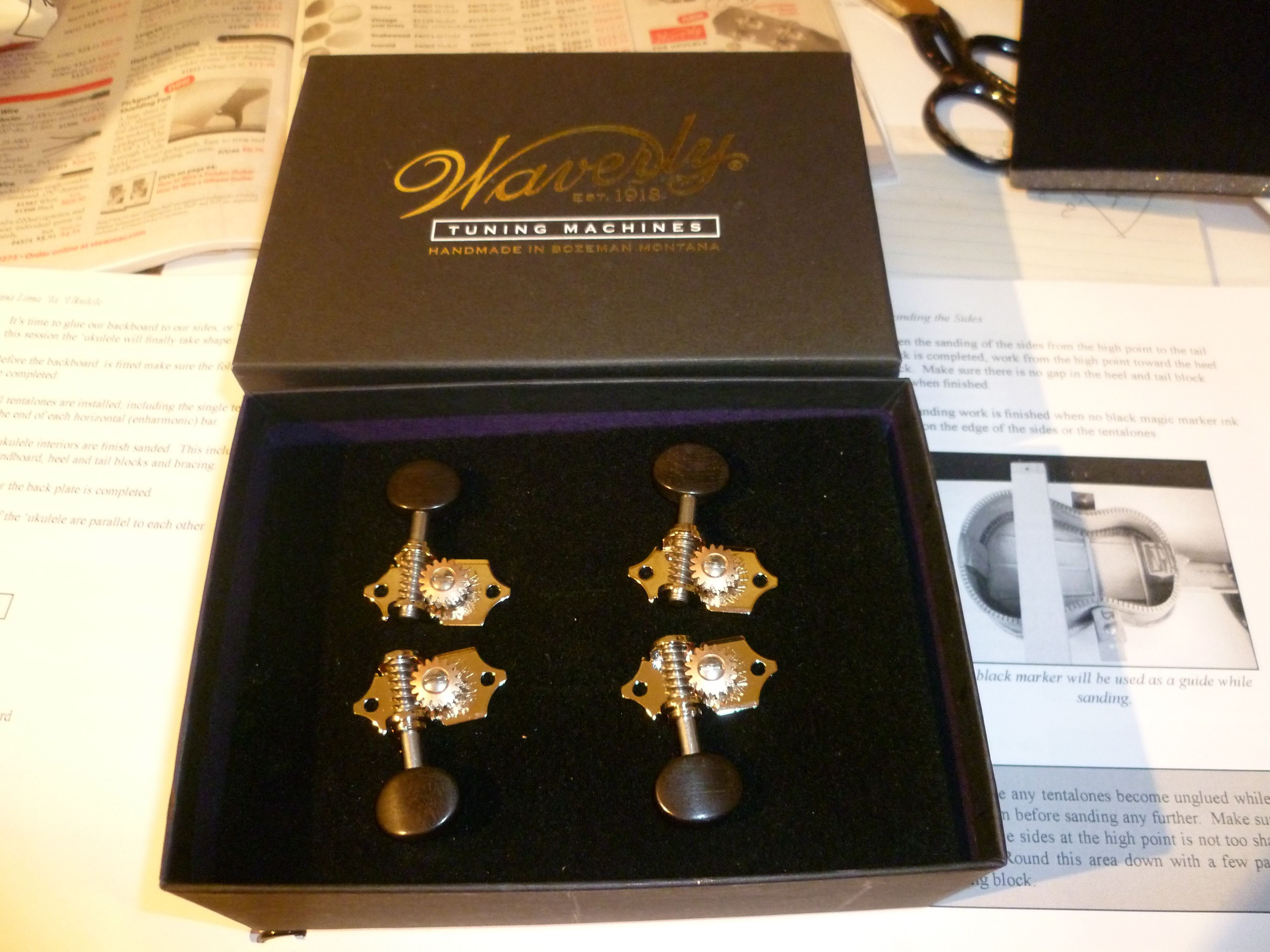

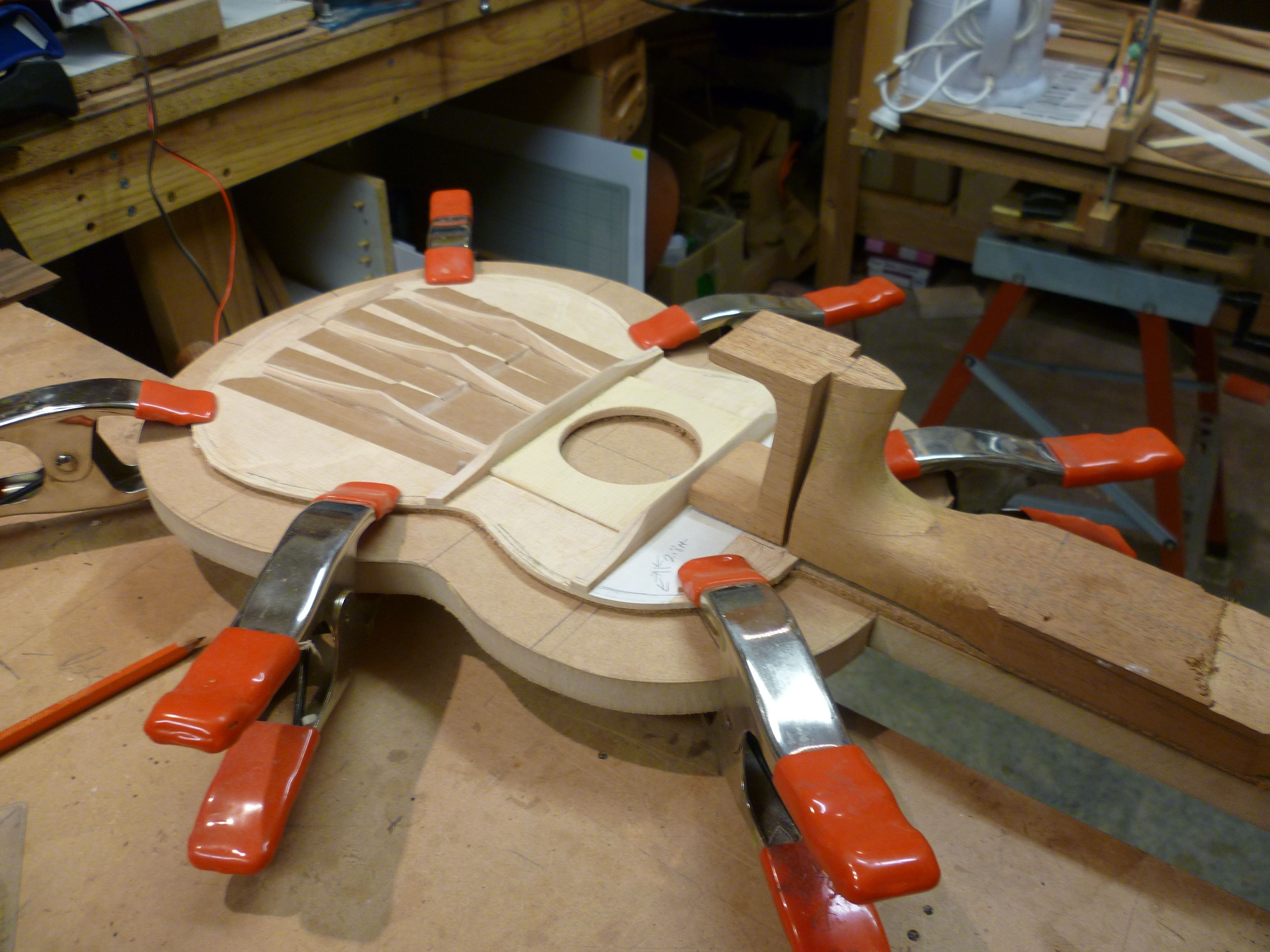

A bit of progress on the uke. Sides bent and fitted to top and today the back linings got glued in. Yesterday a parcel arrived from Stewmac containing some lovely Waverly tuners....they really are works of art.
Re: Steph's Tiger Tenor Uke
Post by Allen » Wed Jan 25, 2012 6:41 am
One wonders if they did away with the fancy packaging we would be able to use them more often.

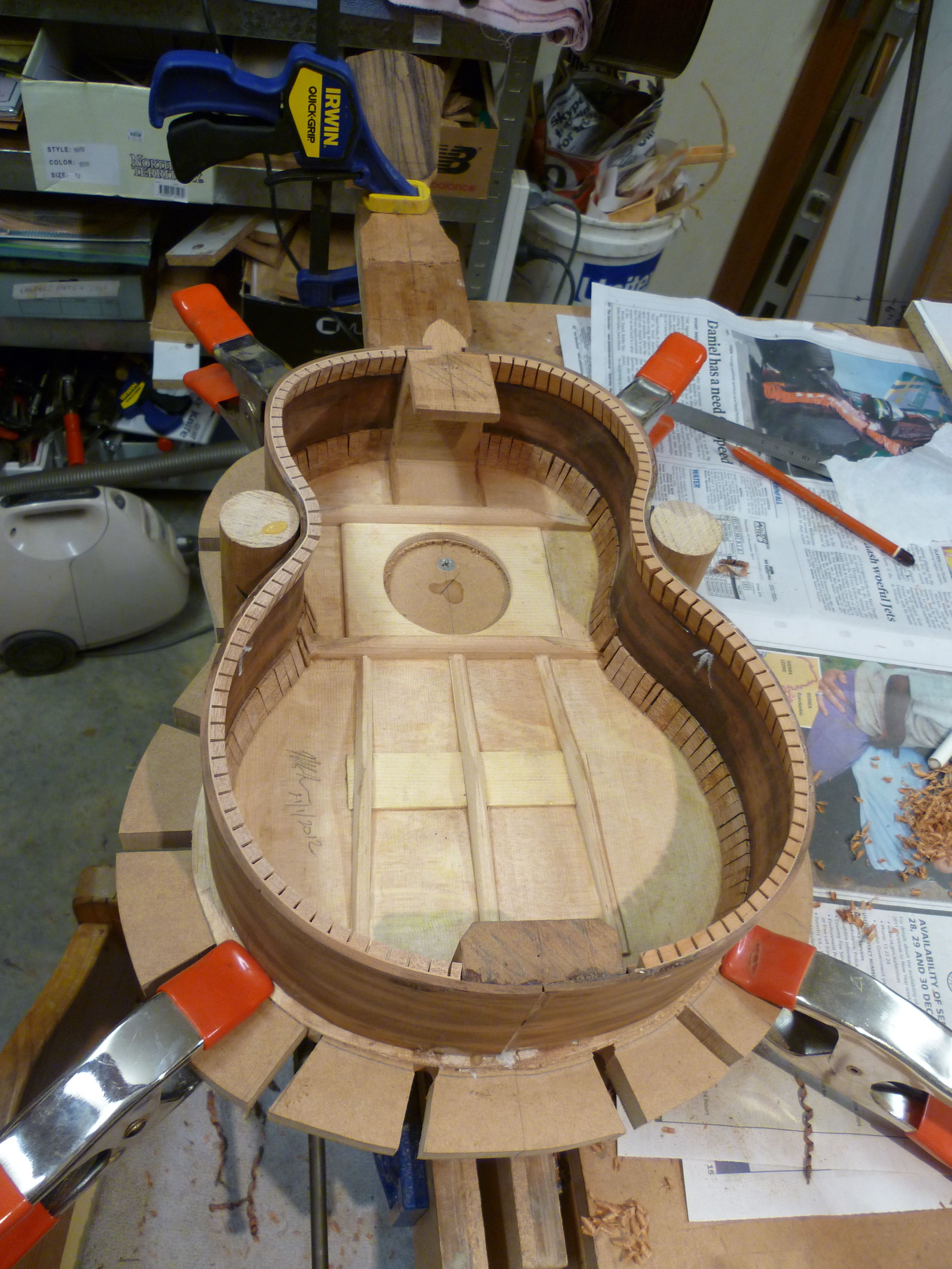

Post by auscab » Wed Jan 25, 2012 10:29 am
Hi Martin,
Is the lining same size as would be used in a guitar ? and what make is it or did you make it?
I can see with the top joined Kerfed lining it looks like a strip of wood has been glued to a thin veneer ,and the cuts taken through to the veneer.
Is the veneer same species ?
I looked at your pictures on my phone , the pictures come up small at first , I thought those tuners looked like jewelry at first , Gold ear rings ? :)
Post by kiwigeo » Wed Jan 25, 2012 10:46 am
auscab wrote:Hi Martin,

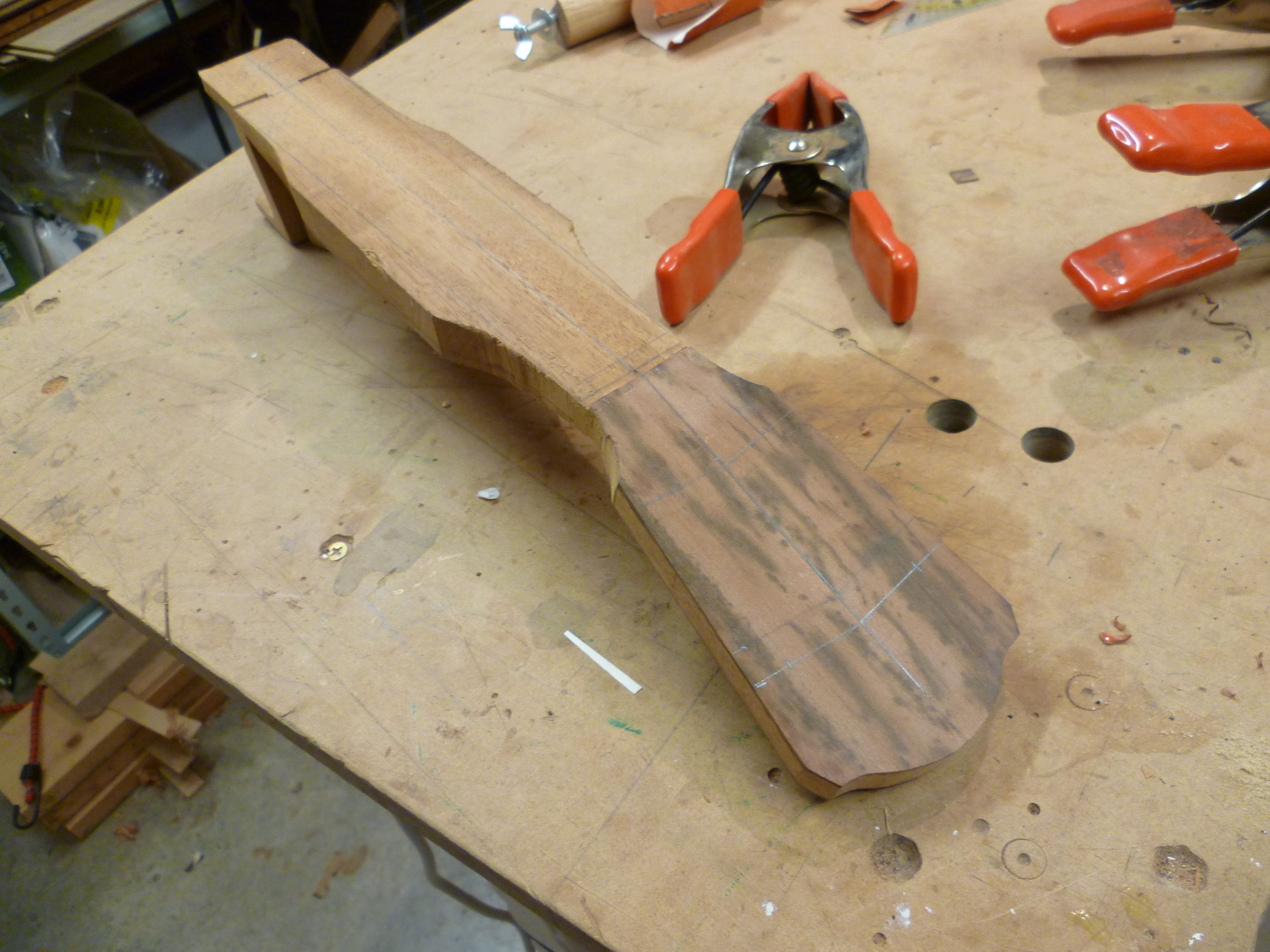

Hi Rob,
The top is fixed to sides using tantellones.....in this case theyre just chopped up kerfed guitar lining. For fixing the back to the sides Ive just used lengths of guitar kerfed lining. My construction technique is plain vanilla flavoured Spanish method working top down on a workboard.
I assume the veneer youre talking about is the one on the back of the headstock. It's Indian Rosewood. On the front of the headstock is some Tigermyrtle....offcuts from the back.

Between the kerf and the side, I thought it must be part of the kerfing ?
Like a flexible back strip , possibly ?
Post by kiwigeo » Wed Jan 25, 2012 11:29 am
auscab wrote:Between the kerf and the side, I thought it must be part of the kerfing ?
Its part of the kerfed lining....this stuff has a flexible back strip. Think it came from Stewmac or LMI.

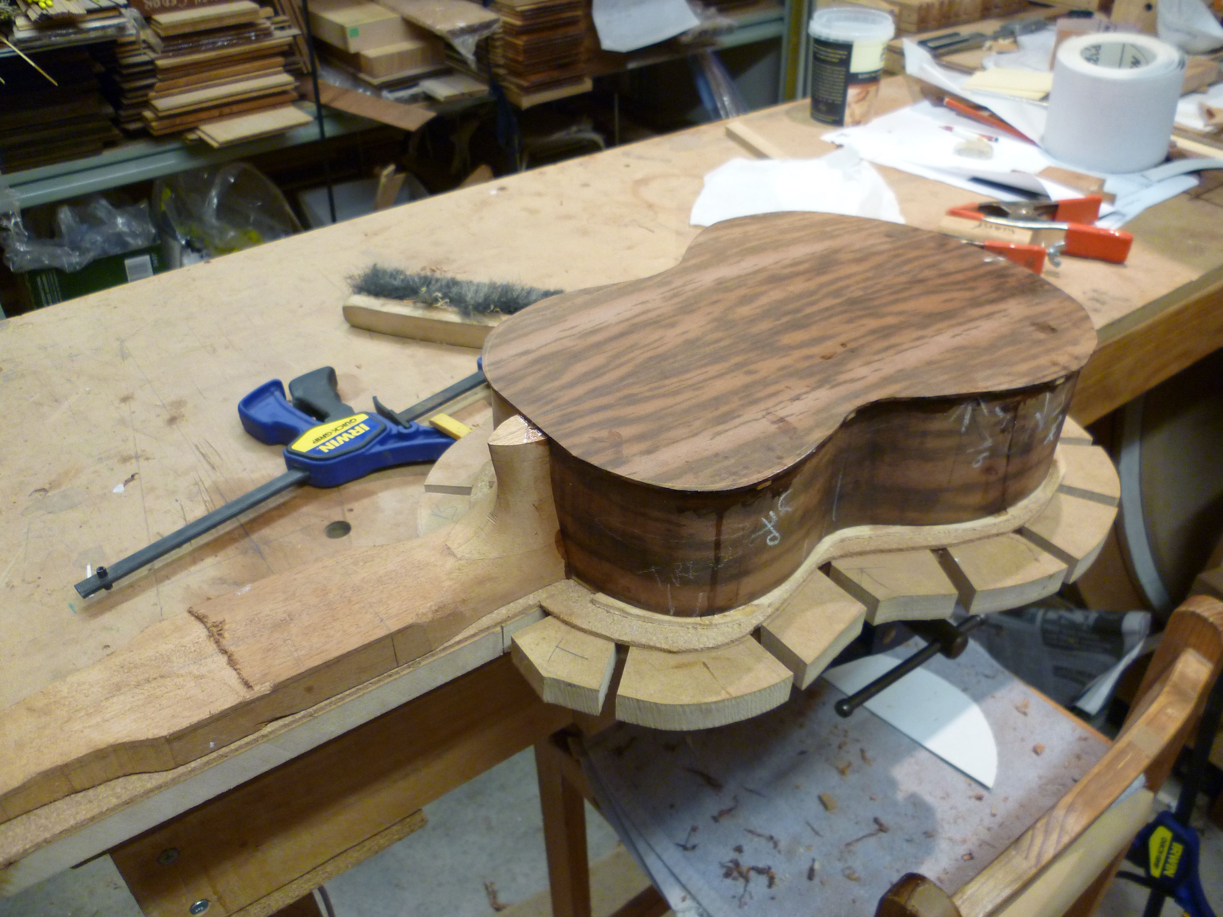

Post by kiwigeo » Wed Jan 25, 2012 9:18 pm

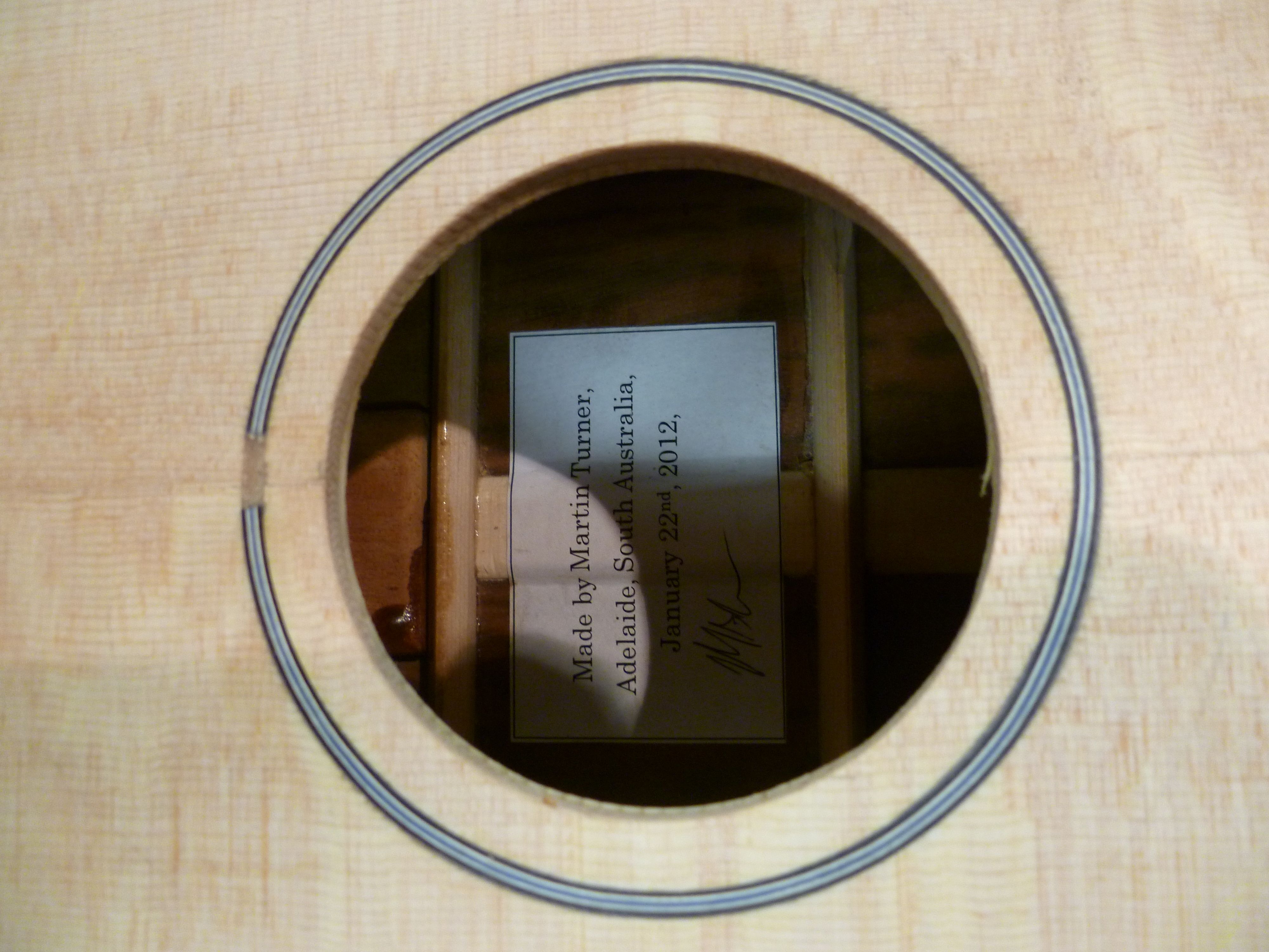

First back glue up using HHG......wouldn't have worked without the trusty heat gun. The date of the build...22/01/12.....my 54th birthday. Steph's Tiger Tenor Birthday Uke

Allen wrote:One wonders if they did away with the fancy packaging we would be able to use them more often.
Even fancy packaging is quite cheap, maybe $ 5.- or so for this box. But surely they couldn't charge 90 or 100 $ if they offered these tuners just wrapped in a piece of newspaper.
Normally the box is pink. For a box with Martin's favourite colour one has to pay 20 $ more.
