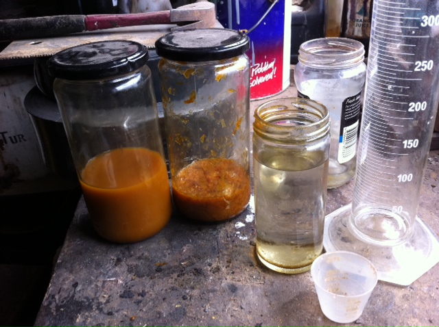

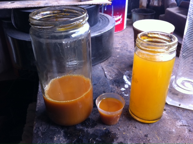

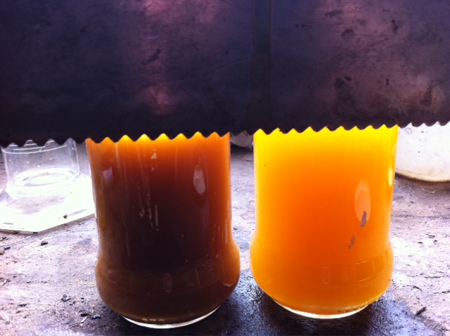

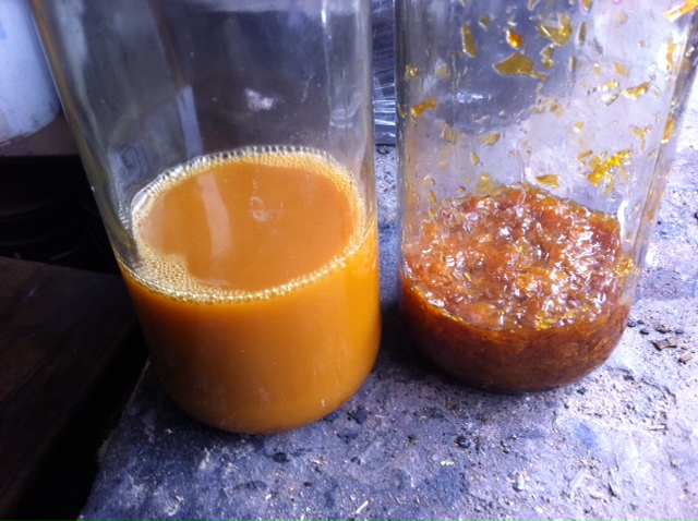

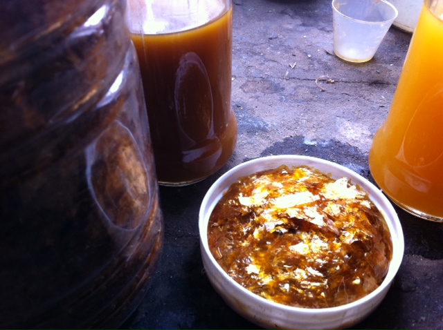

The Shellac Mix, from te bottom picture up.
The bottom two. the jar on the right is how I normaly mix for sorage in the bottle on the bench, I just cover the flake with metho, I took this picture a few minutes after the metho had been poured in so the flake had already started to swell, bu straight off it would have shown a few mm of metho over the top.
The jar on the right is 25 g flake to 100 ml metho and if my calculations are right its close to a 4lb cut
The jar on the left is 25 g shellac to 200 ml metho = close to 2lb cut
I was bodying the table job up with 2lb cut to 3 lb cut
For finishig off the much thinner mix is around what I have mixed in the other jar
200ml metho with 60 ml of the 2lb cut mixed in. 60 ml is two of those little cups.
Even thinner 30 ml to200 ml was used as well.
