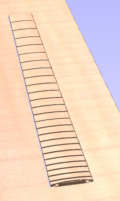

So, a while back(2-3yrs ago) I was asked whether I could do a curved fret installation, I turned the job down because it was beyond my grasp of knowledge, unknown quantity and tooling. However recently a good friend has made me revisit the topic.
Now with cnc I can do a compound radius and curved fret slots with a sealed solid edge. So my interest is peaked again, and Im possibly going to do one as a trial run.
Has anyone here done this. If so what are the pitfalls.

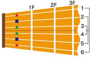

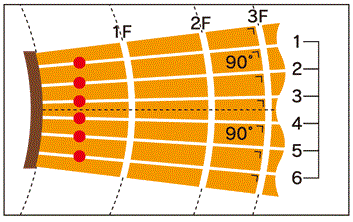

The theory is, that every fret is 90 degrees to the string and all string lengths are the same for each fret position, therefore you dont get unequal scale lengths.
On a conventional setup, strings one and six are the same scale length, 2 and 5 are different and same for 3 and 4, so basically your running three different scale lengths.

simso wrote:The theory is, that every fret is 90 degrees to the string and all string lengths are the same for each fret position, therefore you dont get unequal scale lengths.
Maybe if the saddle was a metre wide the strings might significantly deviate from 90deg but on a guitar with normal dimensioned nut and saddle exactly how far off 90deg are the strings to the frets and exactly how much does it affect intonation? Sounds like someone has invented a solution for a problem that isnt there. Would be interested to hear from anyone with a differing view on the subject.
Trevor Gore
Posts: 1646
Re: Curved frets
Post by Trevor Gore » Sat Dec 31, 2011 6:08 pm
The difference between long and short strings on a conventional guitar with straight frets is a maximum of ~0.15mm with an associated interval error of ~0.4 cents. You may just be able to see the curve in the frets (provided you don't have any spherical aberrations in your vision), but I doubt you'll hear it! Equal temperament has thirds which are ~14 cents sharp of Just.

Re: Curved frets
Post by simso » Sat Dec 31, 2011 9:56 pm
Been playing with new cnc programs, just finished drawing this one up. This one here has a compund radius with fret depths cut in relation to the top surface profile
Change that to a curved shaped fret slot on a bound board, some inlaying etc, could be quite spectacular the end results.
Shame I dont actually make guitars.
Program estimates machining time on cnc as 6 minutes 14 seconds

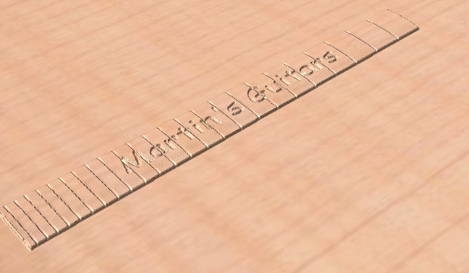

Post by simso » Sat Dec 31, 2011 10:07 pm
Martin, it now takes 7 minutes and 40 seconds.
Profiled with the compund radius exactly readu to be inlayed
