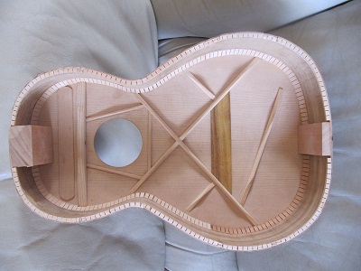

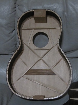

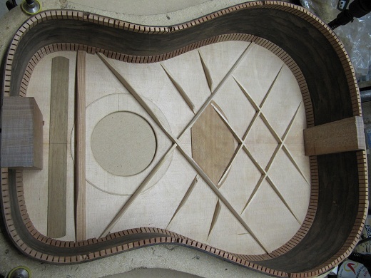

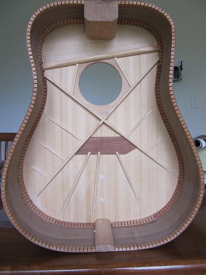

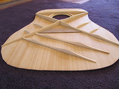

Late in 2010 I spent a week with Ervin Somogyi at his Oakland workshop doing the guitar voicing class with five other builders. This last year my time has been tied up uke building, but here are two guitars recently started and using some of the know-how from Ervin's course.
First is an American Black Walnut dreadnought with red spruce top. It looks like I've stuck the main X-brace in crookedly, but I did it on purpose! The general idea was to make the top a bit assymmetrical and tighten up the treble side relative to the bass. To this end I put in a couple of assymmetric fan braces. I'm not sure what they'll do; maybe they'll accentuate the cross dipole relative to the long dipole and have some effect on the tone. The bracing is all 6.25 mm (1/4") and I've gone for the parabolic longitudinal shape rather than scalloping.
The second is an Aussie blackwood/NZ Kauri dreadnaught. It's pretty conventional really, except that I've made the bracing thin and tall (the main X-brace is 5 mm wide and all other braces are 4 mm wide) I did a bit of maths on the strength being proportional to width and to height cubed, so hopefully the bracing's in the right ball park. The only other thing I did was the Dana Bourgeois trick of scalloping the bass X-bar and parabolising (?) the treble X-bar. I've never used Kauri before; I made the top about 2.8 mm thick as a sort of guess.
Comments welcome. David Aumann, Melbourne, Australia

Welcome to the forum David and thanks for putting up the pics of your builds. The bracing in particular I'm sure will generate some discussion.

I have never been a fan of assymetrical bracing. It just doesn't make sense to me. Contrary to popular opinion, there is no treble side or bass side to a guitar, mandolin, or violin, whatever. The top (and the entire instrument) vibrates as a whole. The "bass" side produces the whole range of frequencies as does the "treble" side. This has been shown from laser interferometry tests, and the Cladni patterns will show it as well. However, that does not mean it is not worth trying and seeing what happens, but I have had more success with symmetrical bracing.

Yeah, I thought about it a bit before trying the assymmetrical bracing idea. I wasn't perceiving that there was actually a treble side and a bass side to the soundboard; just that if the bracing wasn't regular then there might be more different areas on the soundboard that different frequencies could access. I don't know if that's right - just how I was thinking at the time.

I think that asymetry can help with some of the cross modes where with symetrical response there is phase cancellation between one side and the other, by stiffening one side you can then get a net response rather than equal and opposite cancellation.
Re: My first contribution - two dreadnoughts post Ervin clas
Yes Pete, as soon as someone says bass side/treble side I smell something …rotten. I don’t mean to disparage you David, its just a straight talking place around here. And this is not to say it can’t work but perhaps not for the reasons outlined. Did you learn this bass side/treble side stuff from Ervin?
However, asymmetry is different and Trevor gives a nice explanation in his book about the Fleta asymmetric bracing pattern and shows what it does to the frequency spectrum where a 3rd peak where the back would be is actually a strong asymmetric cross dipole that gives the Fleta its particular sound. No one would say that a Fleta is not a successful instrument.
In this respect, any X braced SS guitar with the usual angled face braces is asymmetric already and is fully entrenched as a design.
This is one the really good thing about the book, it explains in technical terms what a bracing system does to shape the sound.
Anyway David, I’d be interested to hear your approach to voicing your guitars, what you aim for and what feedback you use.
Nice Work There David. I would love to hear what the week with E Somogyi was like. What sort of things did it cover and was it practical or theory or both?
I am a symmetrical bracing man myself too as I never could understand the asymmetry of the Martin x bracing design. Of course that doesn't mean that it doesn't work but I just feel that symmetry is better.
Did you go especially to do the course or did you take it in as part of a holiday?

The bracing has been discussed above, I honestly dont like it. That being said, your work quality looks good. Neat clean not too many messy glue stains, symmetrical build, basically job well done

Hi David, thanks for showing your build’s.
I like the look of them and I think it would be interesting doing two at once with differences.
With your Black Walnut build, on the top above the upper transverse brace, it looks like a veneer glued with the grain going the other way, First time I have seen that.
And your Blackwood Kauri build , I like that idea , I did the same for my Build,
[Only one build for me so far] I think my braces were done 7mm wide and the smaller ones 6mm, the top was 2.92 down to 2.5 at the edge, I like it but feel it is possibly overbuilt and it sounds a bit tight. sounds like yours is going in the right direction .
I would be interested to know what you think of yours when it’s finished.

Hello Rob,
Very observant of you! There IS a veneer above the upper transverse brace. About .5 or .7 mm cross grain. Similarly, there is a cross grain patch around the soundhole, about 2 mm thick. The kauri top is taken from a lower angle and didn't have the cross grain veneer installed when I took it, but it has now. And it also has cross grain kauri around the sound hole.
One thing Ervin emphasised was that the upper cross brace and everything above it shoud be rock solid. So I dispensed with the popsicle brace, or whatever they call it, and put veneer in.

I don't have enough experience with asymmetrical bracing to really have an opinion. But it did occur to me while reading your post; that it would be fairly easy to find out if it does make a difference by simply stringing an asymmetrically braced guitar, left handed. Anyone done this?peter.coombe wrote:I have never been a fan of assymetrical bracing. It just doesn't make sense to me. Contrary to popular opinion, there is no treble side or bass side to a guitar, mandolin, or violin, whatever. The top (and the entire instrument) vibrates as a whole. The "bass" side produces the whole range of frequencies as does the "treble" side. This has been shown from laser interferometry tests, and the Cladni patterns will show it as well. However, that does not mean it is not worth trying and seeing what happens, but I have had more success with symmetrical bracing.

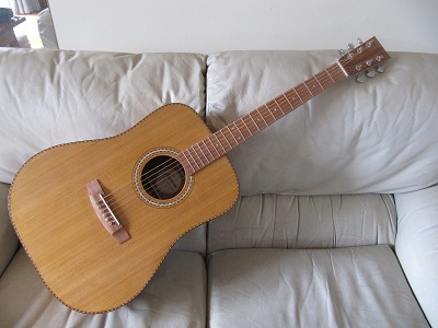

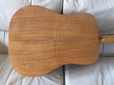

It may have taken me some time to get around to this, but here are a couple of finished guitars. Actually, I finished them about 8 weeks ago, and it's taken me a while to get the pics up for display. Perhaps I should have put the pics in the Gallery section, but the guitars started off here. so ...
I took them to Beechworth Kelly Country Pick in August and asked a few of the good bluegrass players to play them. Mostly, they liked the walnut/spruce one better than the blackwood/kauri one, because it's got a drier tone more suited to flatpicking. The kauri guitar is louder and warmer sounding which may not suit the bluegrassy players. Also, it's appearance is further from the traditional, unadorned Martin look.

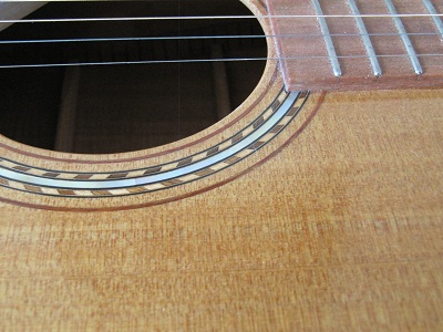

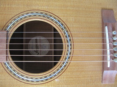

- Rosette on kauri top, with ironbark fingerboard.
- blackwood detail 2.jpg (60.18 KiB) Viewed 25253 times
- Ironbark bridge and fingerboard on blackwood/kauri guitar.
- blackwood detail.jpg (70.67 KiB) Viewed 25253 times
- Back of blackwood guitar.
- blackwood back.jpg (49.38 KiB) Viewed 25253 times
- Blackwood/kauri guitar from front.
- blackwood front.jpg (48.29 KiB) Viewed 25253 times

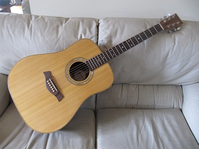

Here are a few pics of the walnut/spruce guitar:
Cheers, David.
Cheers, David.
- Walnut/spruce guitar, front view.
- Walnut front.jpg (48.17 KiB) Viewed 25249 times

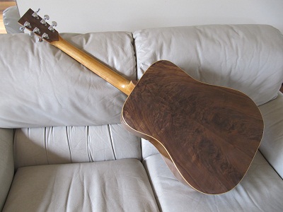

- Back view of walnut guitar.
- walnut back.jpg (46.02 KiB) Viewed 25249 times

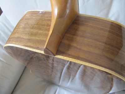

- Neck detail. Qld maple neck.
- walnut neck.jpg (46.5 KiB) Viewed 25249 times

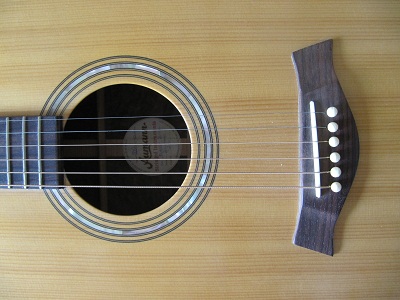

- Top showing fingerboard and bridge.
- Walnut detail.jpg (54.23 KiB) Viewed 25249 times

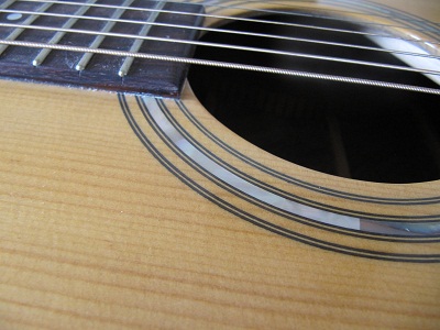

- Spruce top showing rosette detail.
- walnut detail 2.jpg (55.02 KiB) Viewed 25249 times

Both guitars look very nice. Am I right in saying that the back of the walnut guitar is a bookmatched crotch-cut piece? I just finished a tenor ukulele with a crotch-cut walnut top and back, the figure is spectacular. My only concern was the stability of the wood and obviously that would be even more of an issue with the larger pieces in your guitar. So I wonder was that a consideration in your build? I have been told that it could have long term consequences for the finish.

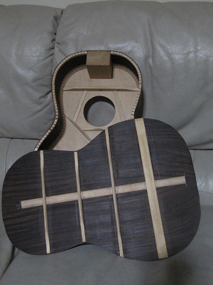

Mike, the bracing in these guitars is exactly as shown in the early photos on this thread. This makes it a bit hard to attribute tonal qualities to anythng, really! They're of different woods and with different bracing. What's more, the ziricote guitar, when finished, might be different tonally again. Maybe I should get a bit more systematic and just make one little change at a time ...
Phil, that walnut is American black walnut, and a timber yard near me (Mathews Timber, Vemont) has lots of it. Yes, it's made from a board from the crotch of a tree. It looked pretty so I bought it. The thought of instability DID cross my mind. It's been resawn for a couple of years now and didn't appear to be moving, so I used it mainly on the strength of the figure in it. It has come up quite nicely.

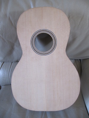

- X-bracing with lattice on spruce/ziricote guitar.
- Ziricote bracing.jpg (91.99 KiB) Viewed 25092 times
- Back bracing on size 5, macassar ebony
- Size 5 back.jpg (42.46 KiB) Viewed 25092 times
- Bracing on the size 5 guitar, which will have a 22" scale.
- Size 5 bracing.jpg (47.02 KiB) Viewed 25092 times
- Size 2 guitar, front view.
- Size 2 front.jpg (40.31 KiB) Viewed 25092 times
- Bracing on the size 2 Martin-pattern guitar.
- Size 2 bracing.jpg (50.41 KiB) Viewed 25092 times
