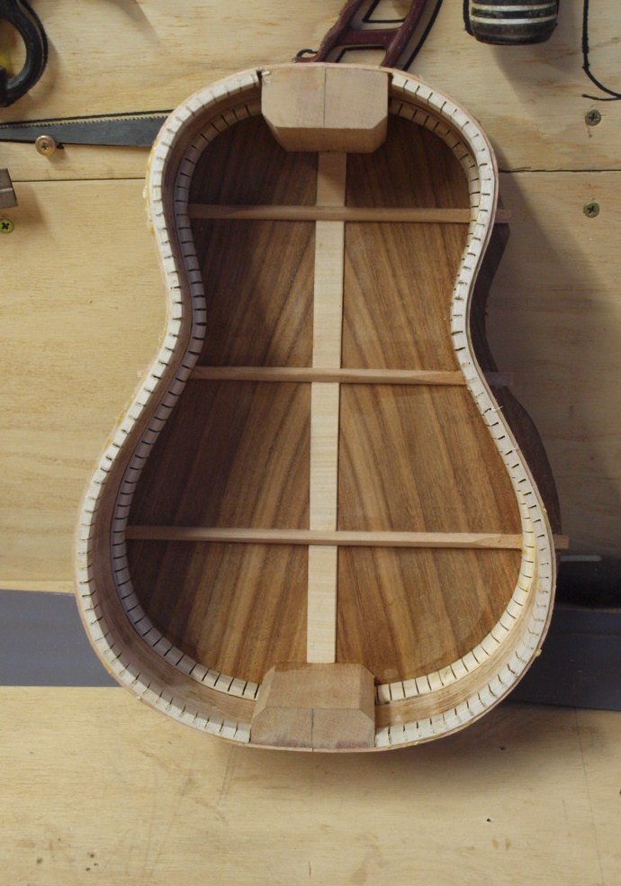

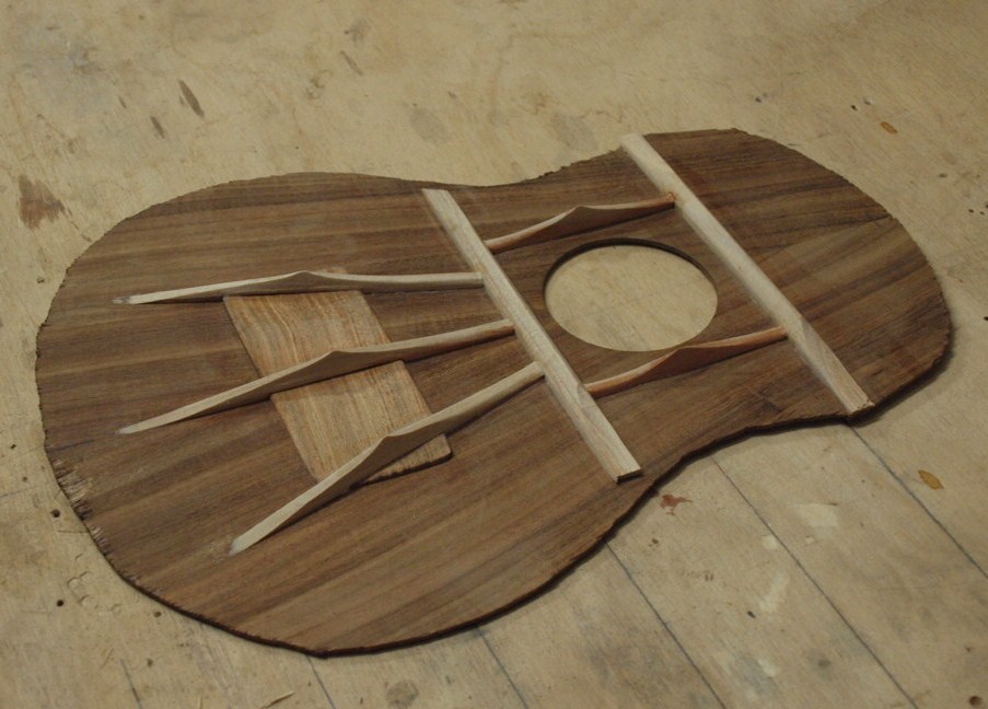

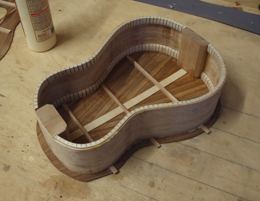

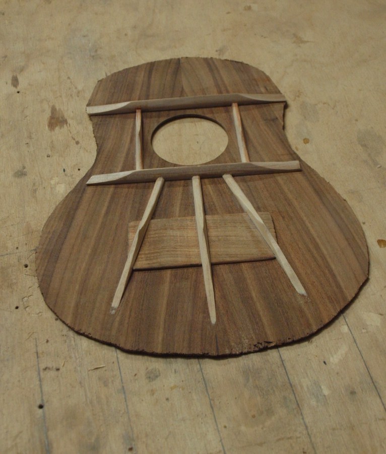

Hi there everyone, I'm both new to the forum and luthiery in general. I have built a couple of guitars now, the first one with Chris Wynne at Montsalvat in Melbourne and the other is a work in progress here in my shed. I've also started a couple of tenor ukes and having no plans for them i've just been making it up as I go along. So before I glue the top on I thought it would be wise to ask the good people of the forum to criticize my work so far, mainly to see if my bracing is either to big/small, in the wrong place etc. ( I know it would have been wiser to ask before I made mistakes but....). I'm hoping that some photo's will upload but will have to wait and see ( computers aren't my thing.) The Back and top for this one is cooba, the sides are tassie oak ( broke the cooba sides bending them.. doh...) Has anyone one used cooba for a sound board before or is this another question I should have asked first...... Anyway thanks for now Matt

Welcome to the forum. And good on you being brave enough asking for a critique.
Without the benefit of being able to flex the wood and tap the top, it's a bit hard to say, but here's my observations.
Tail block is massive. Not the end of the world, but next time could be 1/2 that thick. Mine are about the same thickness as the linings where they meet up. Before the top goes on I would bevel the edge back to the width of the linings so to free the top up. Giving you one continuous width to glue the top on. Other wise you will almost certainly see the tail block foot print telegraph through the top.
Next time your centre back brace might get moved just a bit further north so it's closer to the middle of the waist. You look to have built the back to be stiff and reflective rather than light and responsive. Both can work, but keep in mind what your design goals are when building your next. Ukes usually are built to be responsive from the back.
The top looks to be fairly thick. On my tenors they will be 1.6 to no more than 1.8mm on a hardwood or spruce top. Western Red Cedar will be 2.0mm
I think your fan braces could really stand to taper off more towards the lower transverse brace. That's a lot of brace material there locking up that part of the soundboard. They look to be around 6mm wide. That's good. Your transverse braces can also be that wide. Your's look to be around 10mm. Too big for a tenor uke in my opinion.
Your braces on either side of the sound hole are overkill.
Bridge patch looks to be too deep for my liking. Width might be ok. In fact the bridge patch might just about be enough bracing on it's own. It certainly would be on a concert.
Ukes are actually bloody tough things to build well. It's hard to make them light enough to give good volume and response. Especially when you are thinking from a steel string building perspective. You want to try and get all of that top working for you. There will be approximately 50 pounds of string tension on a top that is just a fraction the size of a guitar.
Good luck and be sure to post some more pictures of your progress.

Thanks Allen that's exactly the type of feedback I was after. I had a bit of time today so I sanded the crap out of the top and got it down to 1.6/ 1.7 most of the way around. Couldn't do much about the foot print of the transverse braces but I took a fair bit of mass off them, also took a bit more of the fan braces and a heap of the sound hole braces. Just have to bevel the tail block and wait for dryer weather to glue it up and see what happens.

This is why every good uke maker has made lots of ukes!
I think the trick is to build lighter each time until one folds up on you (not got there yet), and then in future stop just before you reach that point.
Allen is much more knowledgeable than me, but for what it's worth I'd have said the same.

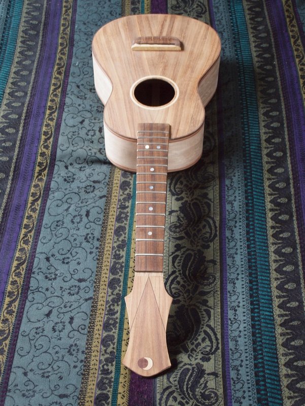

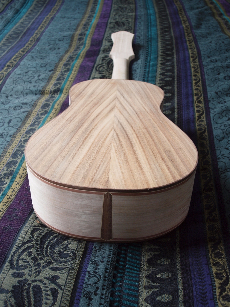

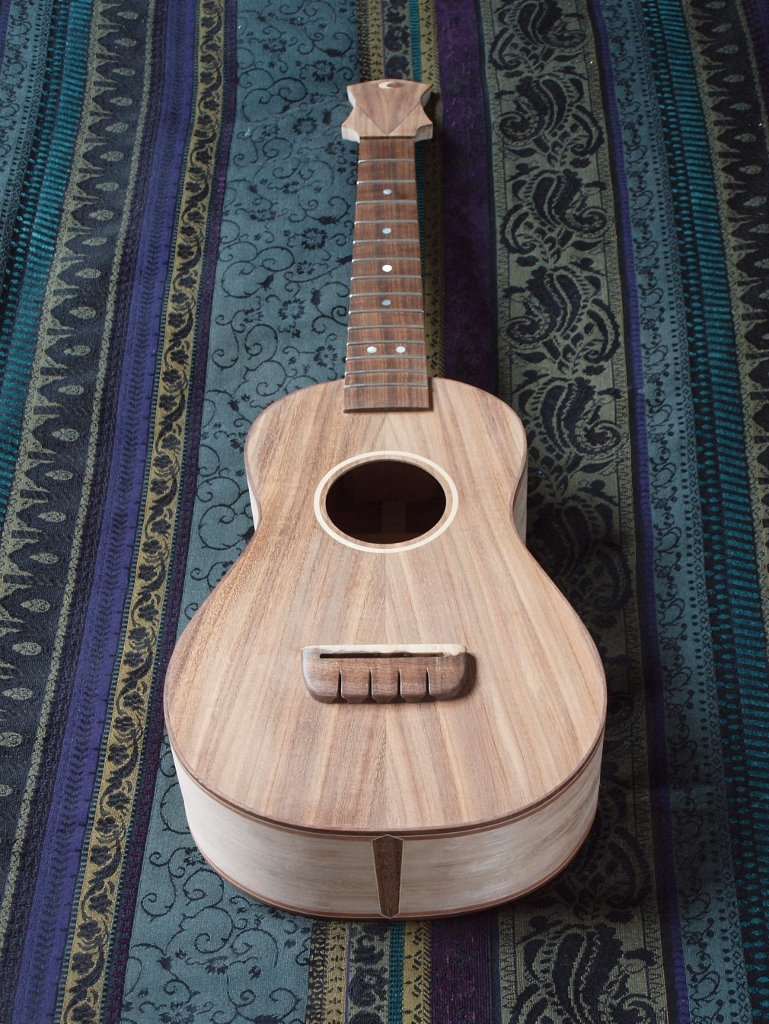

Thought I'd post a couple of progress pics, just waiting for the tuners to come so I can sort out where to drill the holes then it's final sanding and finishing time.

The angled ends on the butt wedge are something I've never seen before. Very well done! May I steal that for my instruments?
Again, Super!
Mikey

Thanks for that Mikey
I wasn't sure what to do with that stripe but I'm pretty happy with the way it came out
and stealing ideas is part of the fun of forums like these so please knock yourself out.

The binding and end graft look great btw.

How tall is that bridge? It looks something like 8 - 9mm? Have you checked what the action is going to be like?

As for the action, I snuck home from work for an extended "lunch break" one day and in my haste to get back to work before anyone realised I glued the back where the top should be and I could only flatten out the top so far before I ran out of lining material, so the top has a fairly large curve front to back. I could have/should have fixed it properly but after all the braces were already oversized etc. I decided to just use it essentially as a practice instrument. So yes the action should be fine ( I think ).
Lesson one Don't skive off from work to build ukes (Unless your pretty sure you won't get caught)
Lesson two DON'T RUSH
Have patience grasshopper
