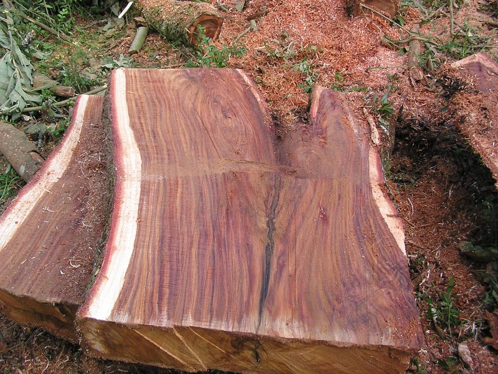

Hi Brian, I have not tried to cut Euc for guitars but I have cut it from 3 blackwood trees and one silky oak tree. Basically I cut it into 1200 lengths and I take a big 100mm+ wide "fillet" from the centre of the tree either side of the heart that is dead quartersawn. The tree must be big enough to be able to get 200mm either side of the heart or close to it to be able to make 2 piece backs although if it is near but not quite you could make 3 piece backs with a contrasting (or same) wood just as easily. If your tree is 600mm then that should be big enough for 2 piece backs. If the tree is big enough then the remaining 1/2 rounds can yield the sides by cutting at 90 degrees to your original "fillet" again resulting in dead quartered material. You are left with 4 small quarters that if you are keen enough you can get something out of but usually there is not much there to justify the effort. After that I stash them somewhere for a year to loose a bit of moisture and then I take them out and make the large billets or "fillets" as I call them and deep them on my bandsaw and then I dry them inside as they are now 50+ mm and should dry down from there. Once they are down in moisture a bit you can saw sets from them and sticker them for final drying. At about 4 - 4.5 mm they dry quite quickly. I would end seal them of course as previous posters mentioned. I find old paint good (and cheap) preferring oil based to water based acrylics for this but use what you have got handy. As I said I haven't used euc in acoustics and would have a look at the shrinkage ratios of the species of tree you have to decide if it is stable enough in service to warrant all the effort of converting it to tonewood. Thats basically my method, I do it all by hand and eye with a chainsaw to "fillet" out the best quartered material. There is a fair bit of waste but I like to have everything well oversize so that I can work around the inevitable faults that you come across when you slice a tree open.

I was a bit late with my editing and was not able to put this pic in the last post...I mark out my "fillet" and then drop the chainsaw down the marked lines and then rip it down the heart for the largest dimention of useable timber. This yields the highest value dead quartersawn timber for instruments. This was the same figured blackwood tree that I mentioned in the last post.

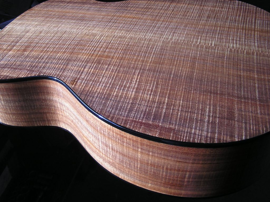

Here is a picture of the second guitar that I have built from that tree that I am just lacquering at the moment. I still have a lot of resawing of the rest of the billets to do but I sawed out a few just B & S sets to see that it was OK. ...it was OK!

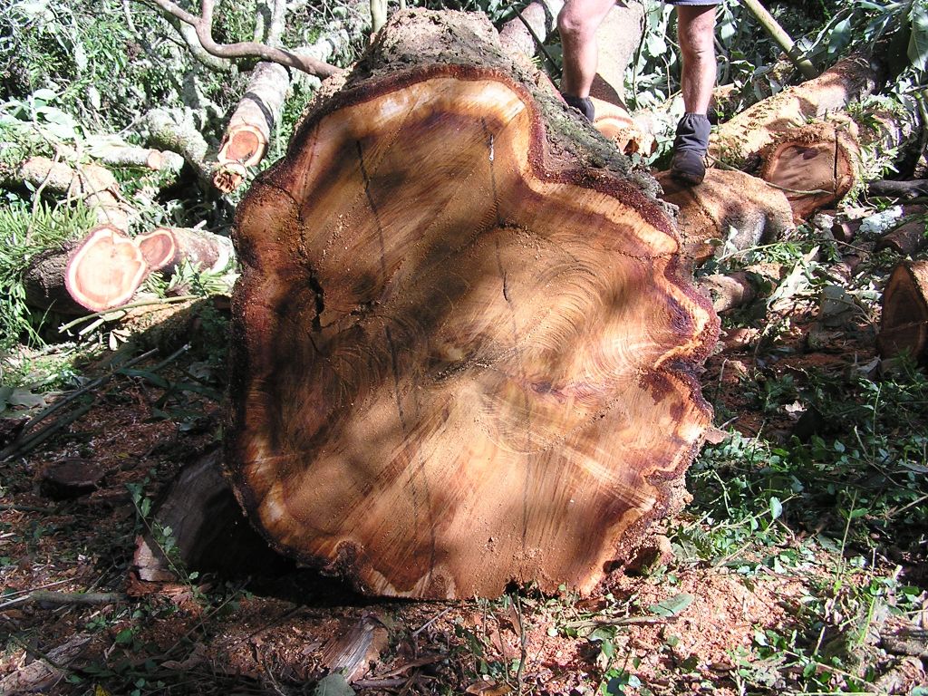

OK, so here are the logs
, which look like this from the top
.As you can see there's already a bit of checking, so gotta get to work.

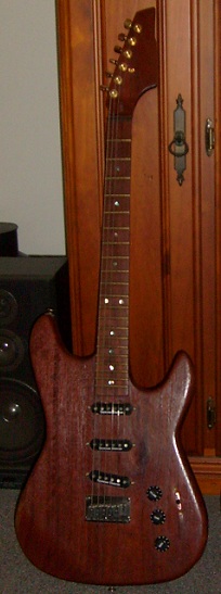

Here is a solid body that I built from a Eucalypt ( E. Resinafera ) You may find that most Eucalypts are very heavy,This one is. A Gym workout prior to playing to strengthen the back and shoulders is required. That said it sustains for a day and a half and I put that down to the heavy dense wood,so If you can handle the weight issue,you could have a very nice Guitar depending on exactly which eucalypt you have,of course.
- E.Resinafera.jpg (88.56 KiB) Viewed 27367 times
