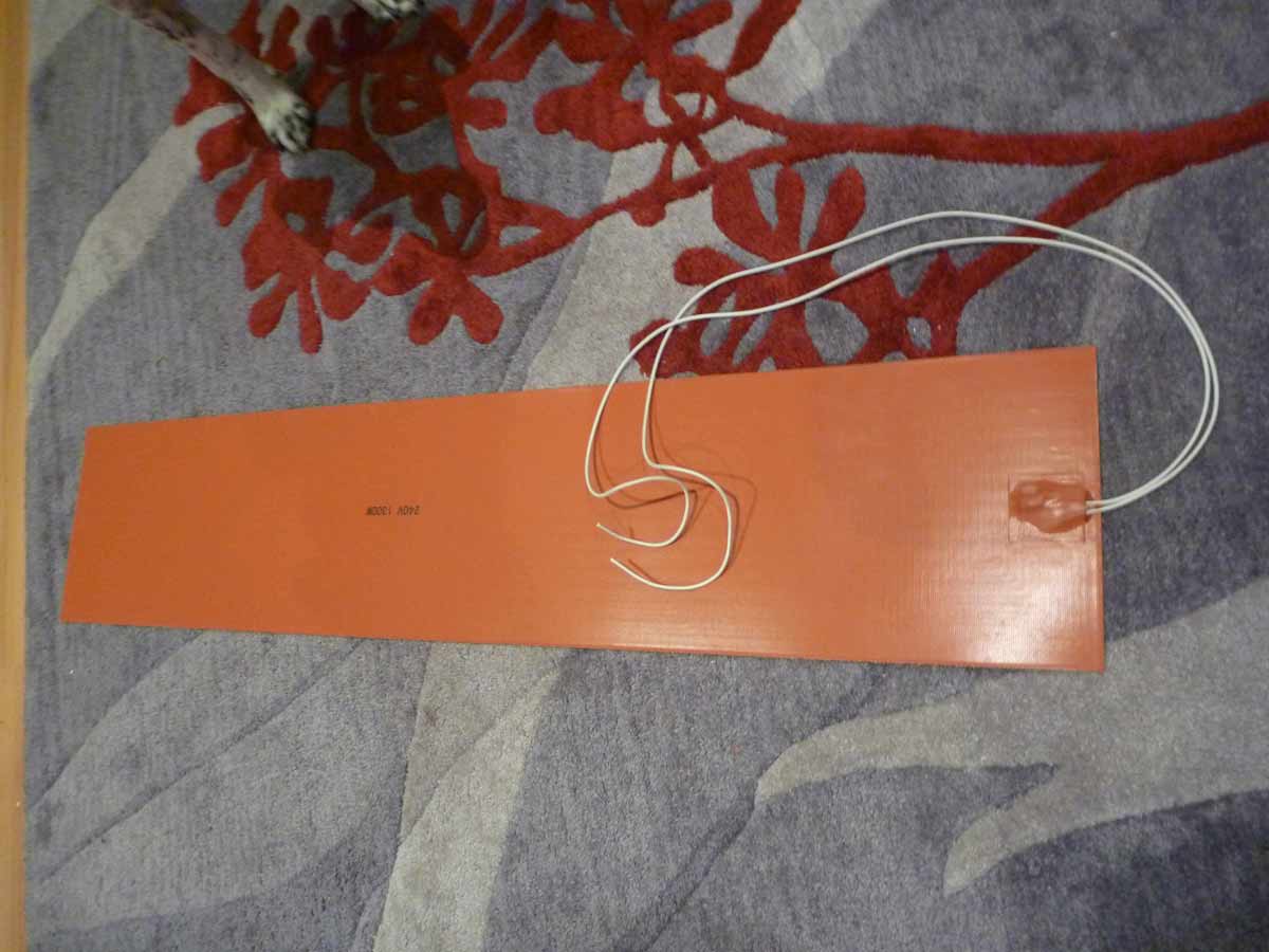

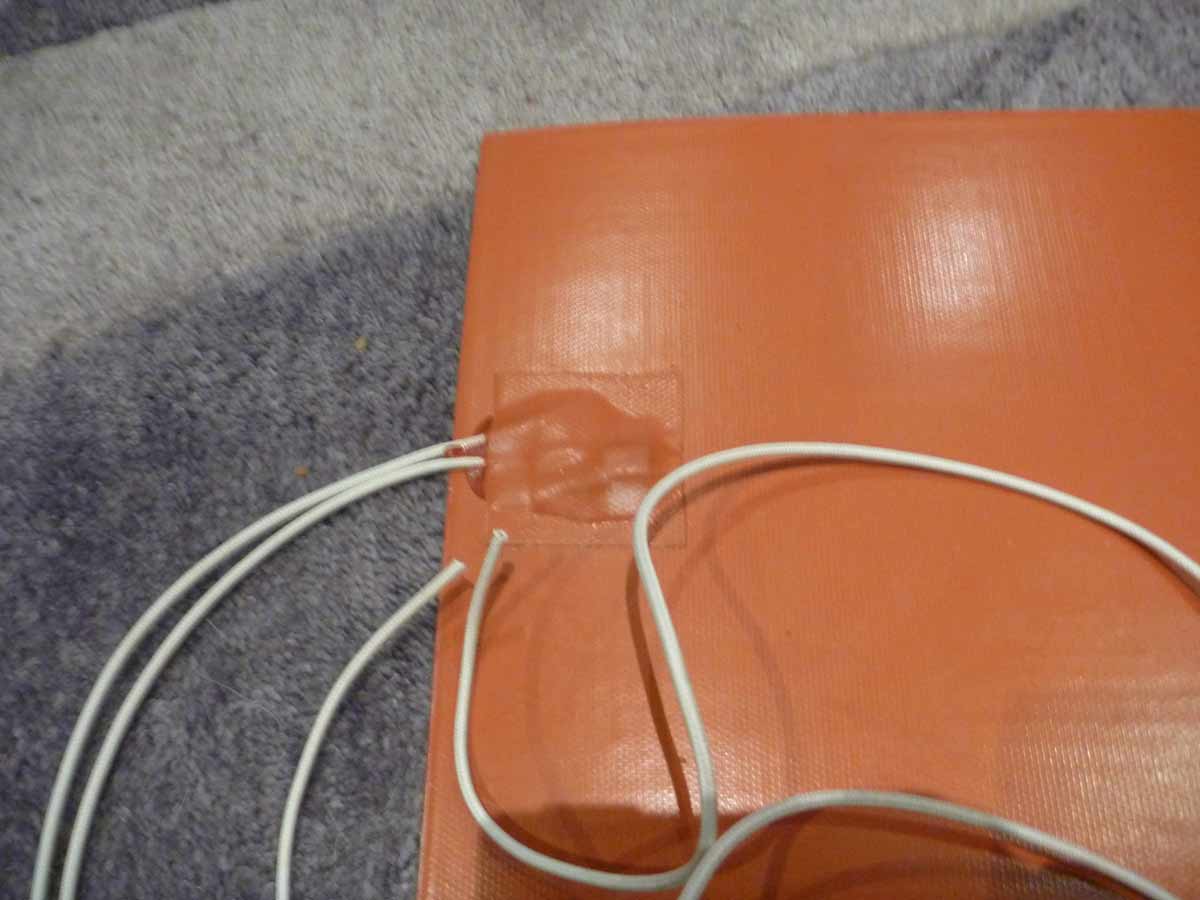

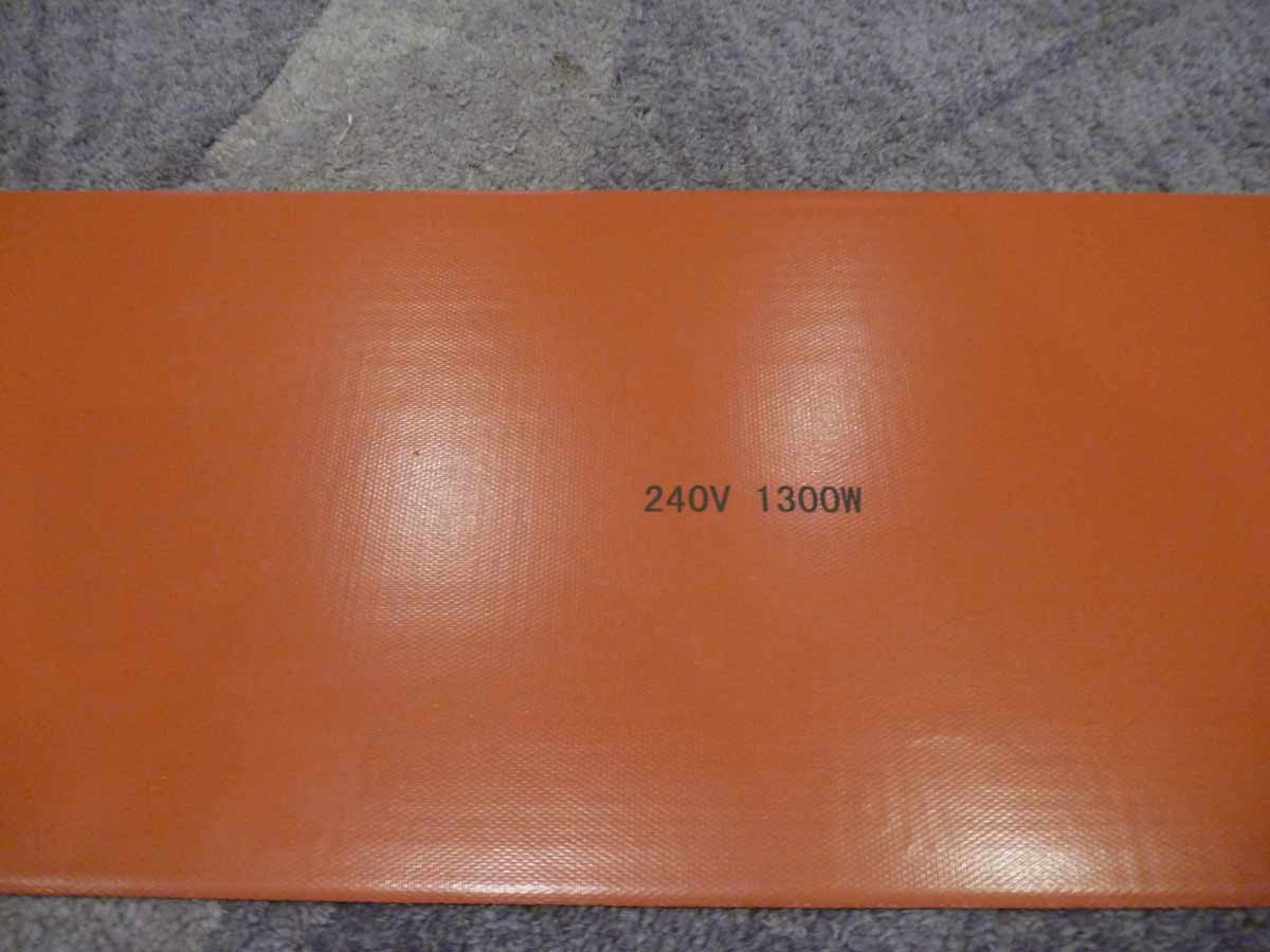

Hello and i can say its good to be back in the shed getting amongst the wood shavings again. I have recently decided to purchase a heat blanket which looks to be great quality however my understanding of these things is limited. My guess is they are powered by a source from the 240v main power supply. The blanket is 1300watts in total.
Can i run the blanket from the power supply only or is this a silly idea as there is no way to properly control temperature? Anyway If i was to vary the voltage with a router speed controller, would this allow the blanket to successfully work. As you can tell, my knowledge is limited (as is my budget) on this topic but its a wealth of knowledge here. I am also not wanting to go with an LMI controll unit as they are very pricey.
here are some pics of the culprit and what im working with.

If you were to use the basic high-school-level physics equation:
Power (1300watts) = Volts (240v) x Amps ...
... then you would need a 'minimum' amperage rating of ANY control device rated to at least 1300/240 = 5.4amps or ideally higher. Not sure what a router controller is rated at, but certainly worth checking the specs on such a device before plugging in.

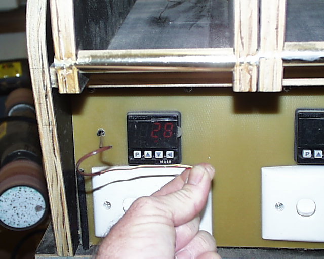

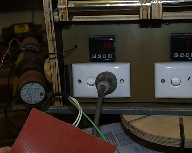

I had the over cooked experience. After that I bought a pair of temperature controllers.
I've installed them in the base of my side bender. The temperature measurement is done with thermocouples, which are also stored in the base when not in use. My heat blankets have a standard 10A three pin plug top on them, which plug into the controlled power points on the base of the bender.
I still have to watch the time, but havent had a charcoal experience since.
Graham

- Base with heat blanket plugged in.
- PIC00010.JPG (61.2 KiB) Viewed 16572 times
- Base of side bender - thermocouple and controller
- PIC00009.JPG (66.84 KiB) Viewed 16572 times
