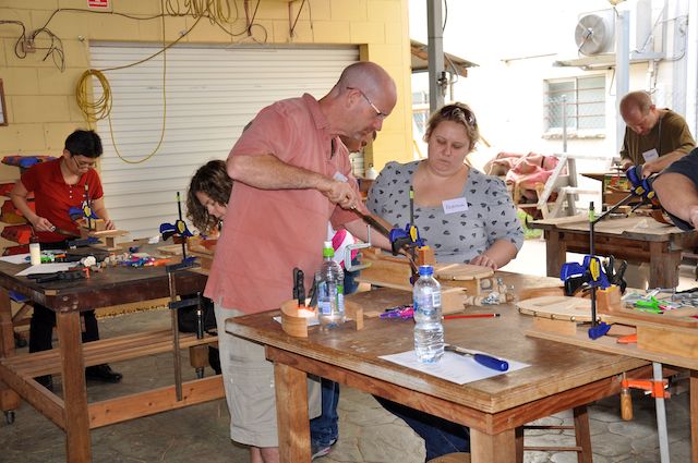

Some pretty simple stuff happened in the morning. Glueing the end block to the sides. The neck blank to the soundboard. A transverse brace and bridge patch to the sound board. Then we had morning smoko provided by the Cairns Woodworkers Guild. Just the start to a week of fantastic food and expanding waist lines.
We then went on to a little more complex task while glue was curing. They got to do a bit of pre-shaping on their necks, so a demo on our instruments, then going around the room and helping out where we were needed. We penciled onto the neck blanks were they would be cutting facets with the rasps, and then demoing on how a rasp works if they had trouble getting them to cut. Some of the group had prior woodworking experience, but many had none at all.

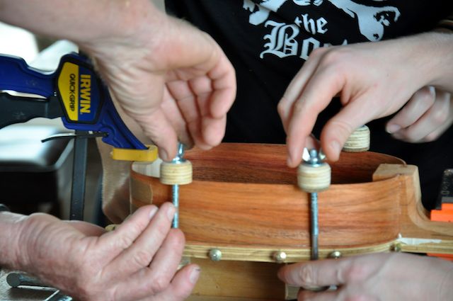

After lunch we got the rims glued to the sound board.

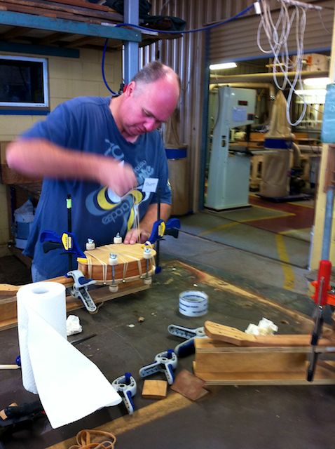

To hit our target for the day in order to progress on Tuesday we had to have the braces glued to the back, and the linings to both the top and back glued in place.

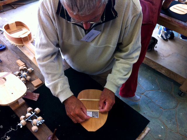

Tuesday morning we got the back linings flattened. Added a builders label and got the back glued on.

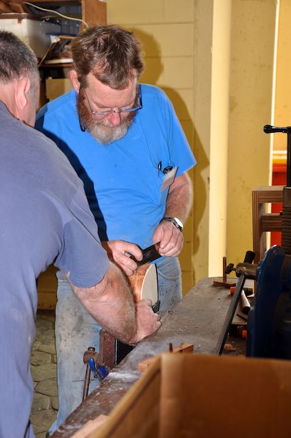

The next morning Micheal gave the class a demo on sharpening a card scraper and then showed them how to use it to clean up the edges left from the trimming process.

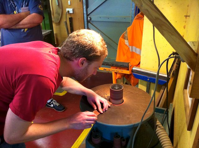

Then it was onto everyones favourite......sanding. We were really under the gun, as we had to have bridges glued on before lunch time in order for them to dry enough to get the clamps off and then apply the lacquer in the afternoon. And the weather had not been very conducive to ukulele building let alone spraying all week. We managed to get that step done with our friends Bosko and Honey stopping by to provide us with a musical interlude while glue was drying.

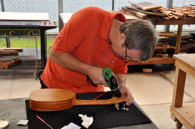

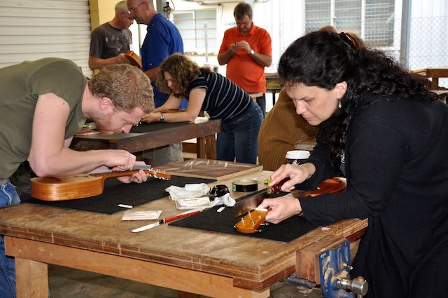

That was it for the day. 14 instruments built and in finish in 3 days. Thursday was devoted entirely to installing the tuners. Grover Sta-Tite 14:1 open backs.
Then there was making nuts, dressing frets, lessons on tying strings, and instrument set up. That took up most of the day.

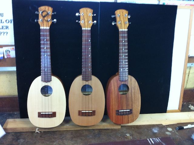

A rough picture of the 3 types of instruments.

Everyone liked all the instruments for various reasons. Most of the people in the class are reasonable to quite good players. Some are bloody good. They chose the top for the characteristics that they wanted for the music or situation that they would be playing in. So Scott who plays lead wanted an instrument that cut through, while others that played solo wanted the cedar for the warmth it has. No one had heard a NGR instrument, so picked it purely on being so bloody good looking. In the recording it sounds a bit muted but will definitely turn into a cannon in a years time. As will the cedar. Just not quite as brite as the spruce.
