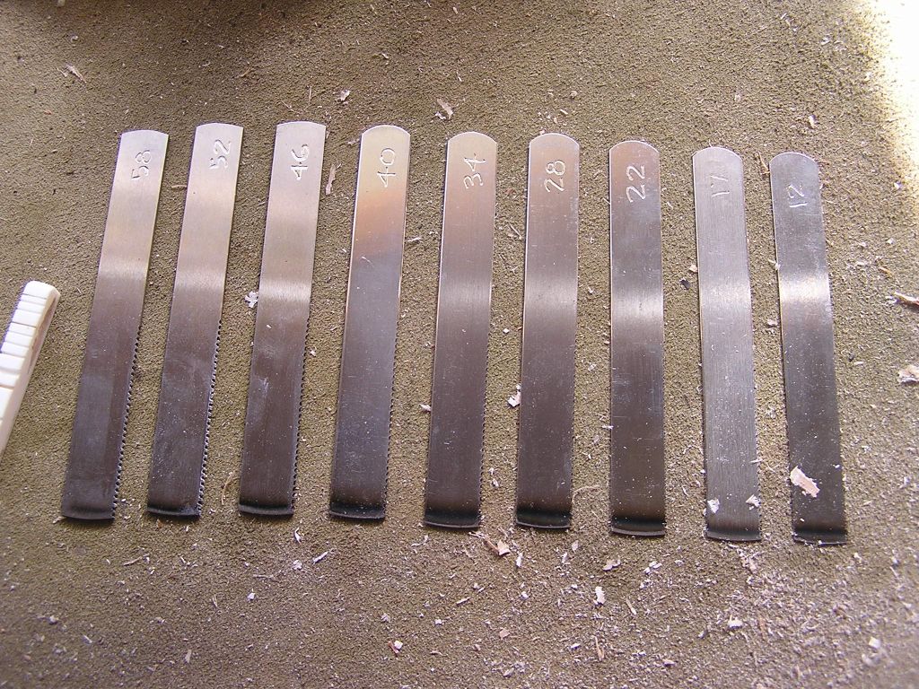

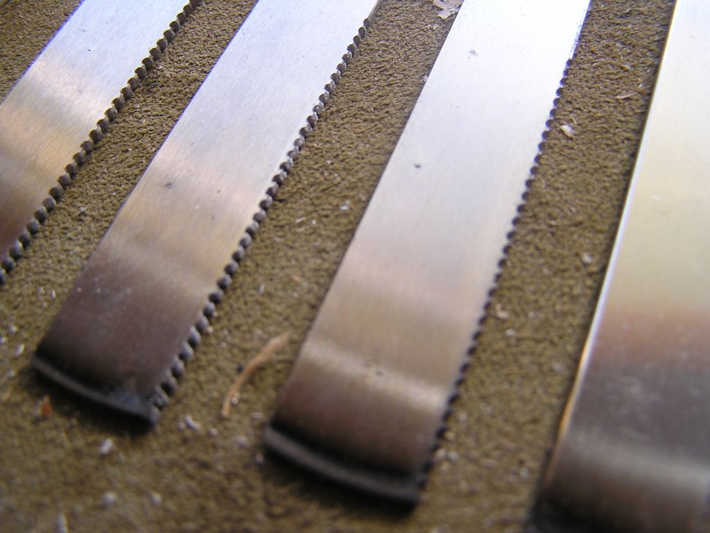

I have been looking for something decent in the way of nut files. I have made all my guitars using my original purchase cheapie Stewmac budget files that tend to bind a lot and are not very good but I bought them as I was setting up and could not extend to the more expensive ones at the time. Any way I thought that I would post these that I bought recently on eBay from a guy in the States who calls himself guitargeek3602. I believe that he must be starting out on eBay as he only has 8 positive feedbacks (including mine) at 100%. I bought them because they looked like they would work a treat...and now having received them I can say that they do indeed work beautifully. They are made out of high quality High Carbon steel that is I assume is feeler gauge stock. They are radiused nicely and polished and the teeth are precision milled and cut very smoothly and fast. They dont bind like my Stewmacs and are stiffer on the really thin files.
I payed all up about $57 AUD landed here which I thought was alright for such a high quality tool. Anyway I thought that I would give everyone a heads up if they are in the market for a set of nut files.
And if anyone is wondering..I dont know this guitargeek3602 from the proverbial bar of soap but I thought that I would give his product a plug as it is so good...he obviously has thought about this one and gone about making a good tool so he gets a thumbs up from me.

At seven dollars each they are less expensive than those you compared them to. Great call - thanks.

Hi Matt, that was the thing that impressed me about them that they cut very fast and SMOOTH. The design is different from the files that I got from SM in that the business edges of the files are somehow put into the edge by deforming probably through a machine to produce the raised cutting edges. These are milled into the file body so every tooth is perfectly inline and so they cut very smoothly.Matt Bach wrote: One day I'll try my hand at sharpening them, cos I remember them cutting REALLY fast (almost too fast!)...
