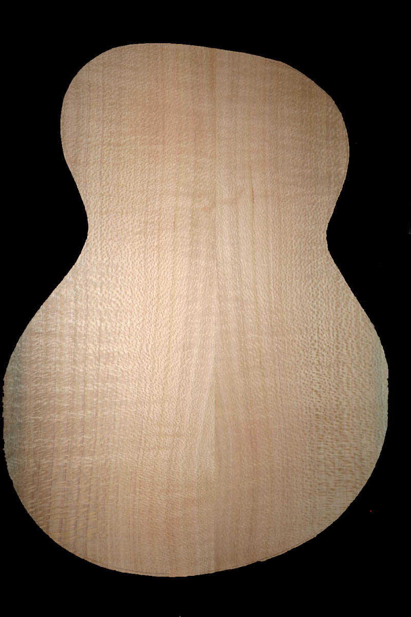

I got given some beautiful silky oak (see below) the other day and after seeing what you have created with it, I'm very eager to try it out on a guitar or two.
Christian.
