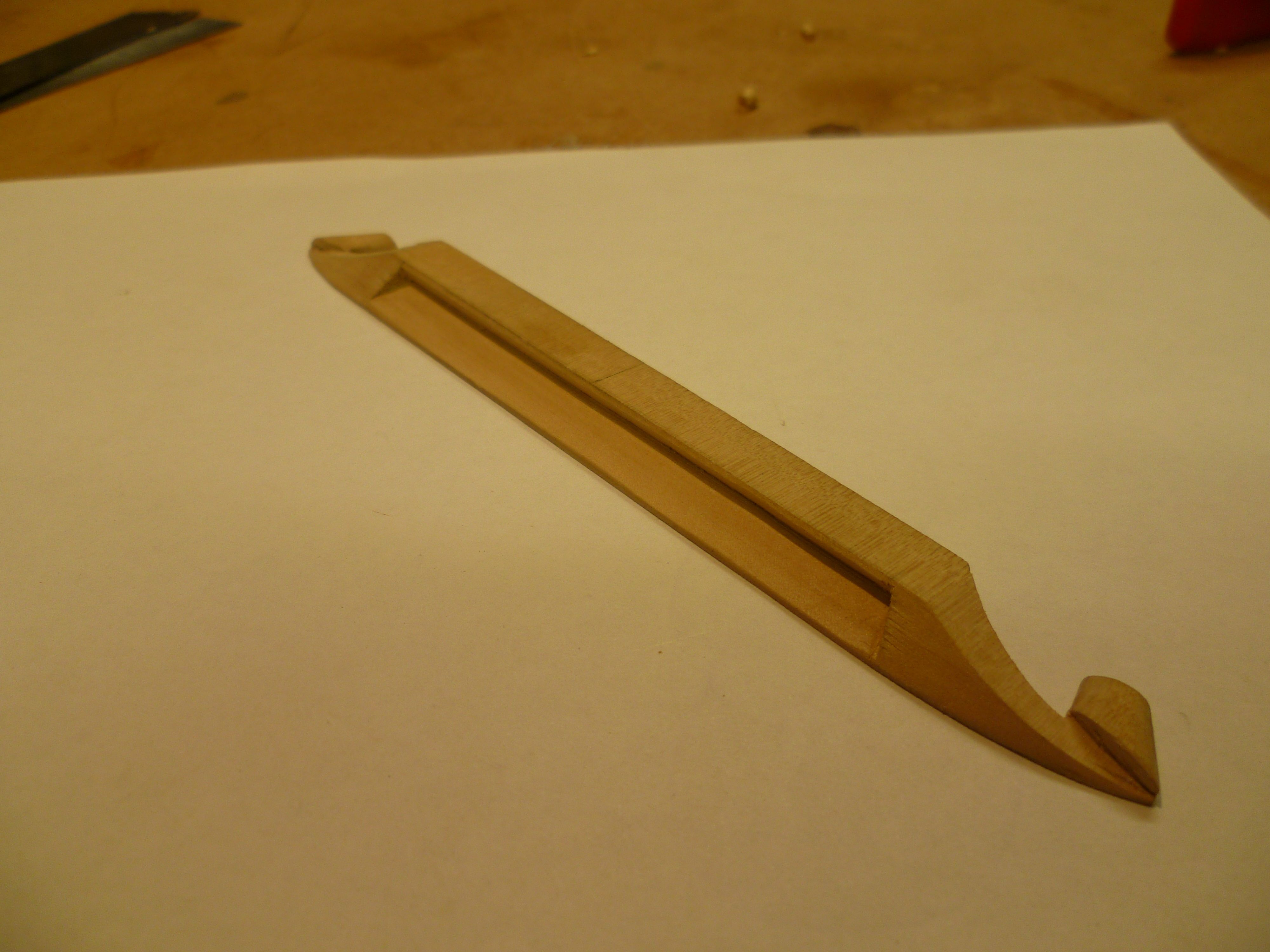

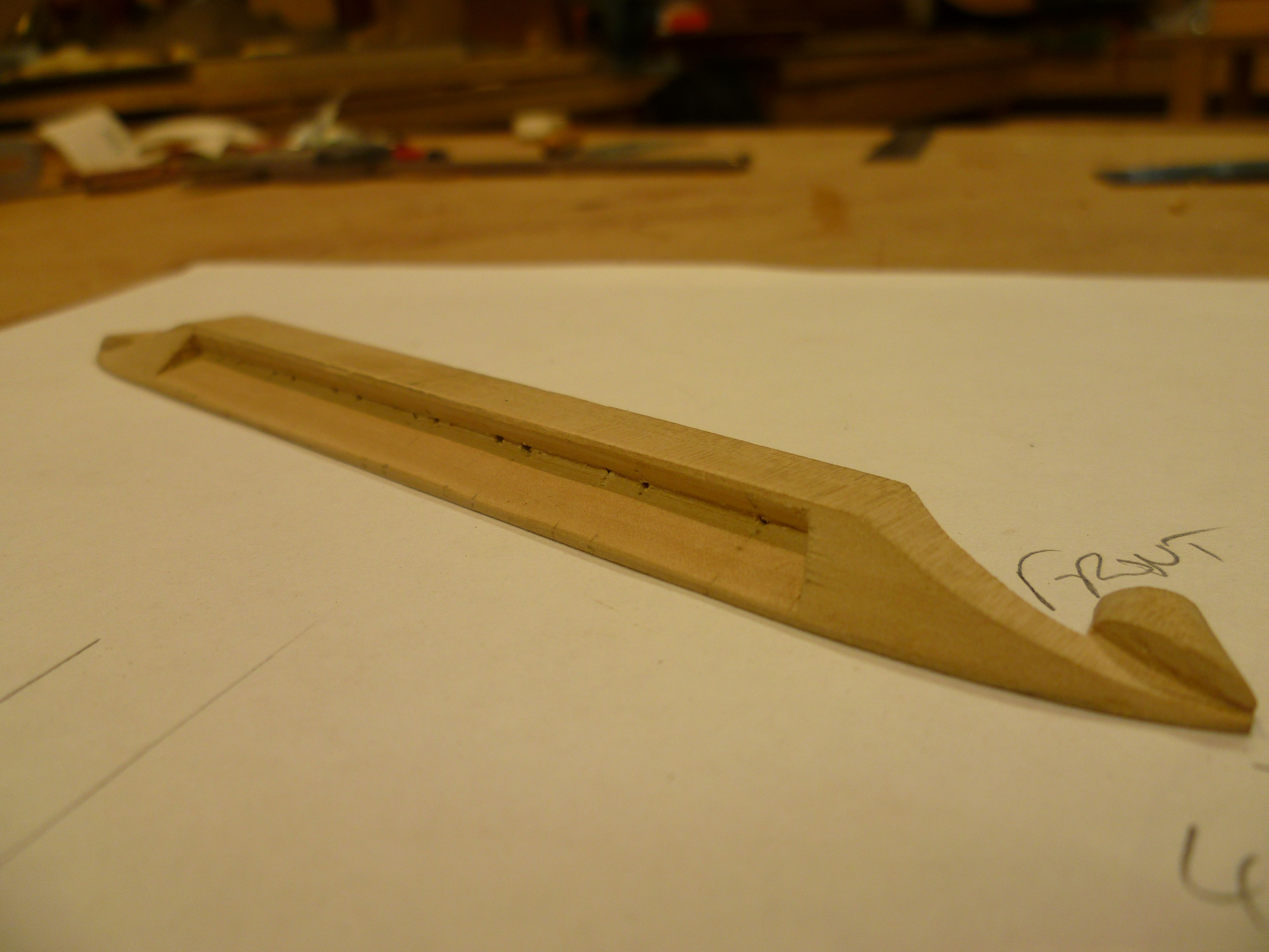

Post by kiwigeo » Fri Feb 11, 2011 6:25 pm

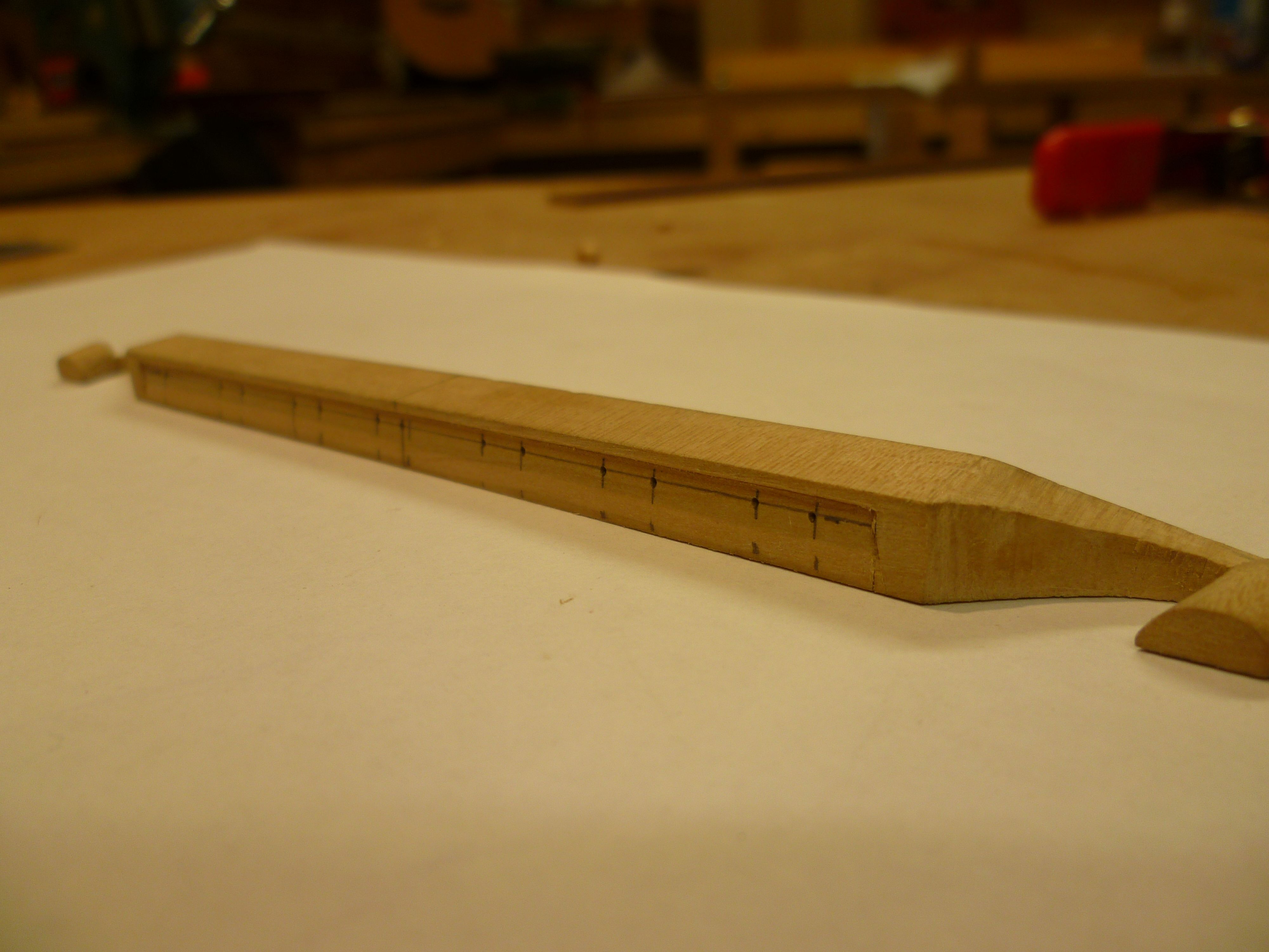

The last few days have been spent working on the bridge. A lute bridge is indeed a weird kettle of fish...the wood is plum and there's not much to it.
Front of bridge with string holes marked out
Back of bridge with characteristic ramp.

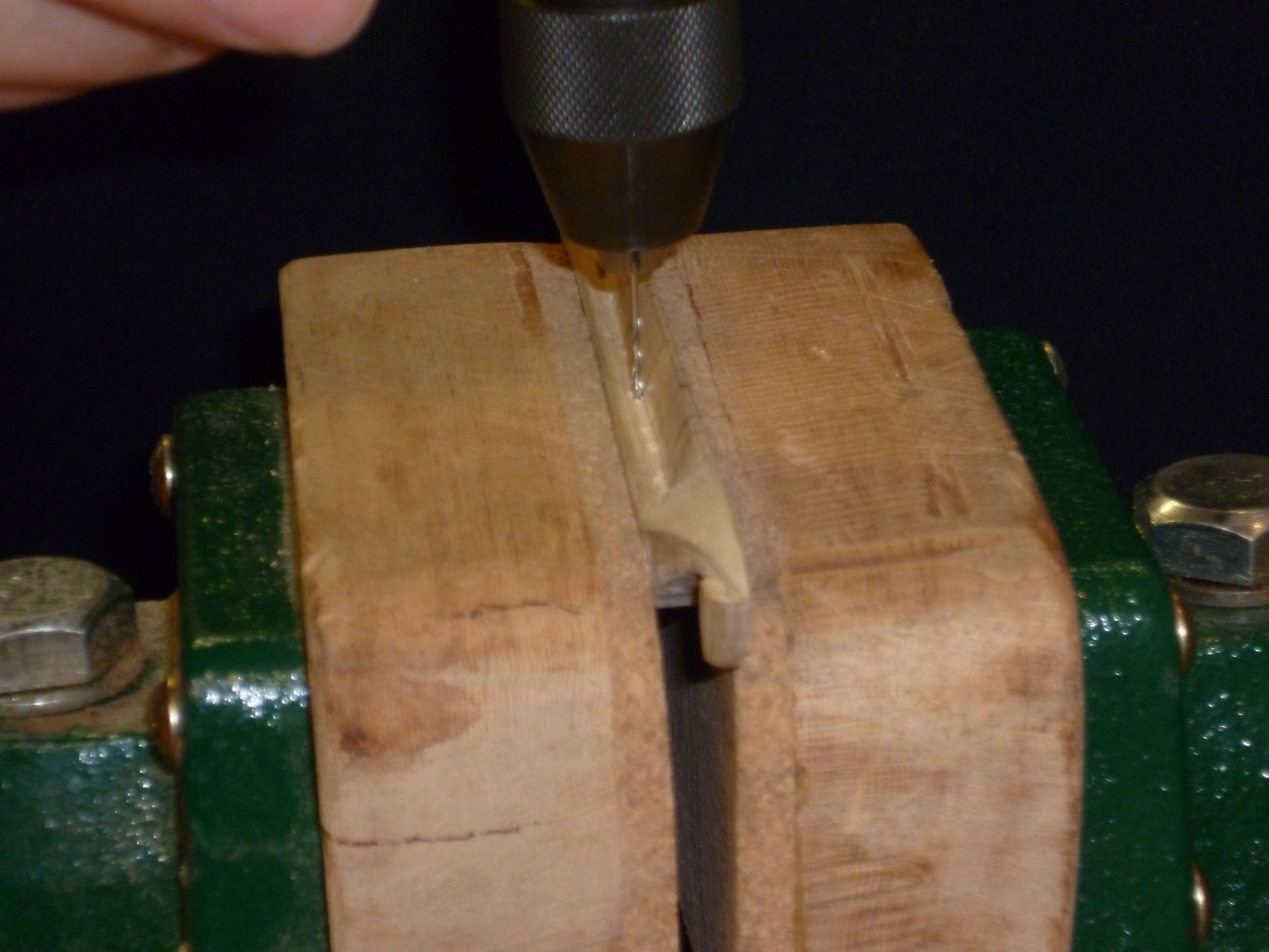

Post by kiwigeo » Sat Feb 12, 2011 1:31 pm

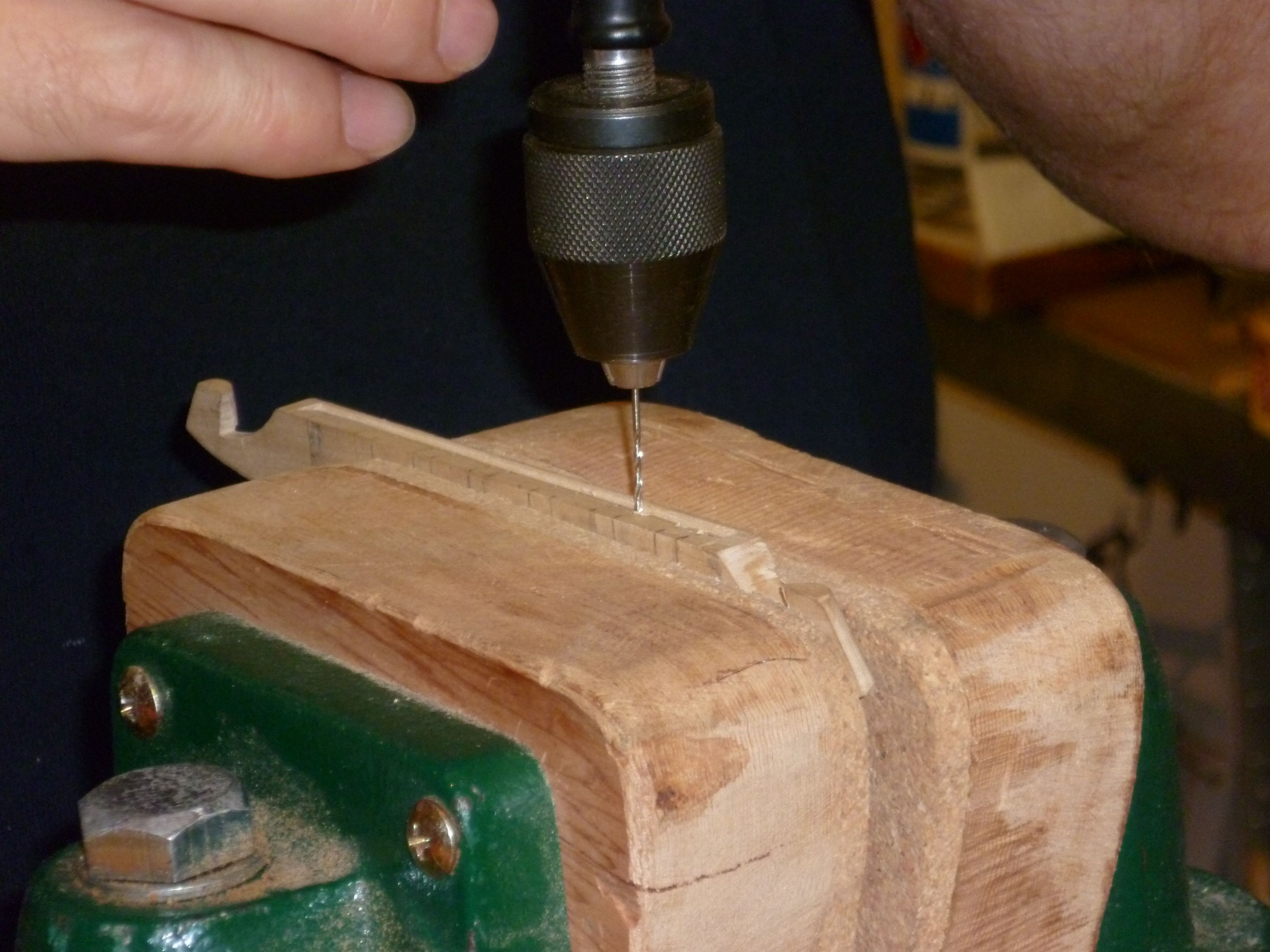

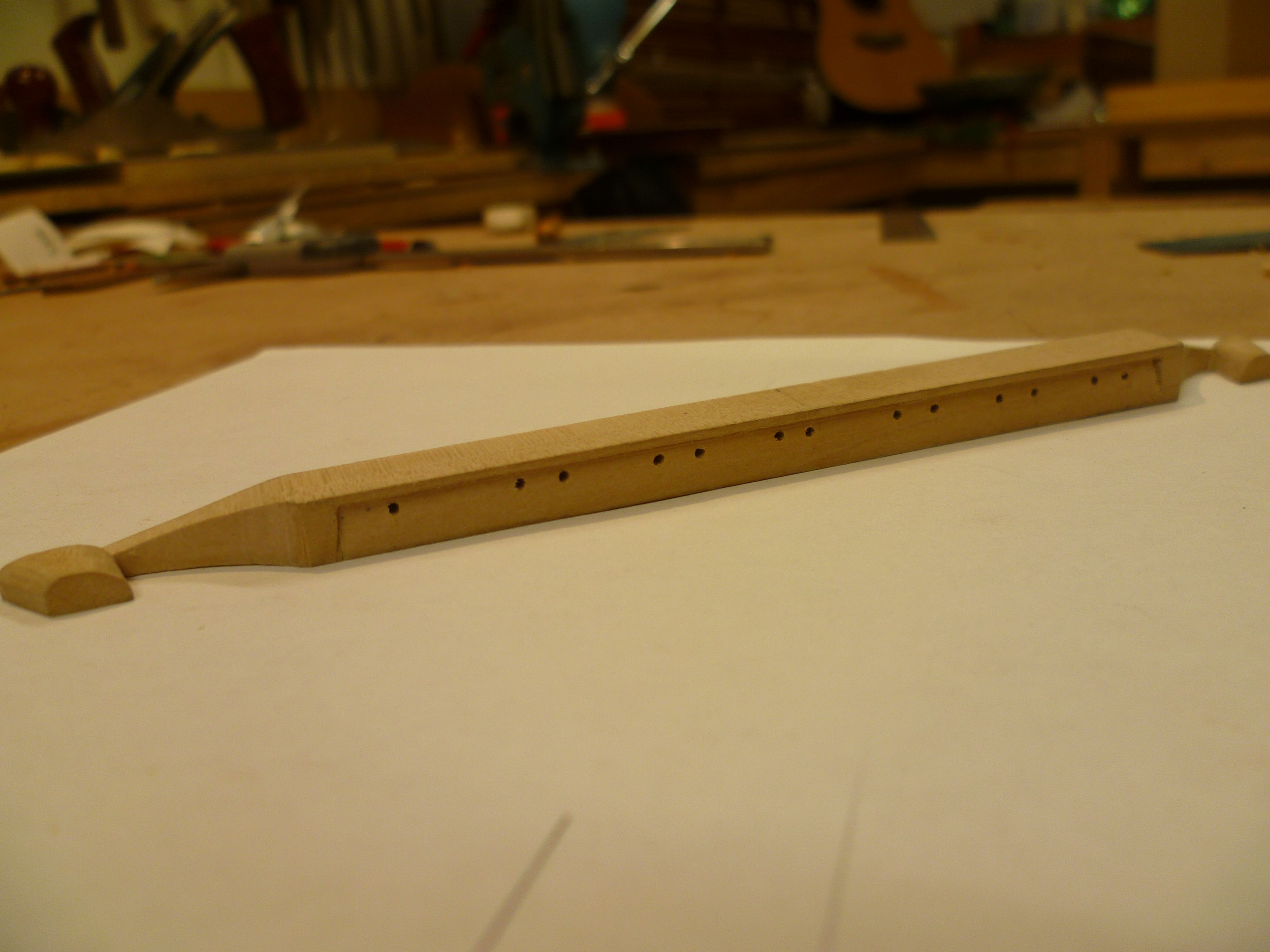

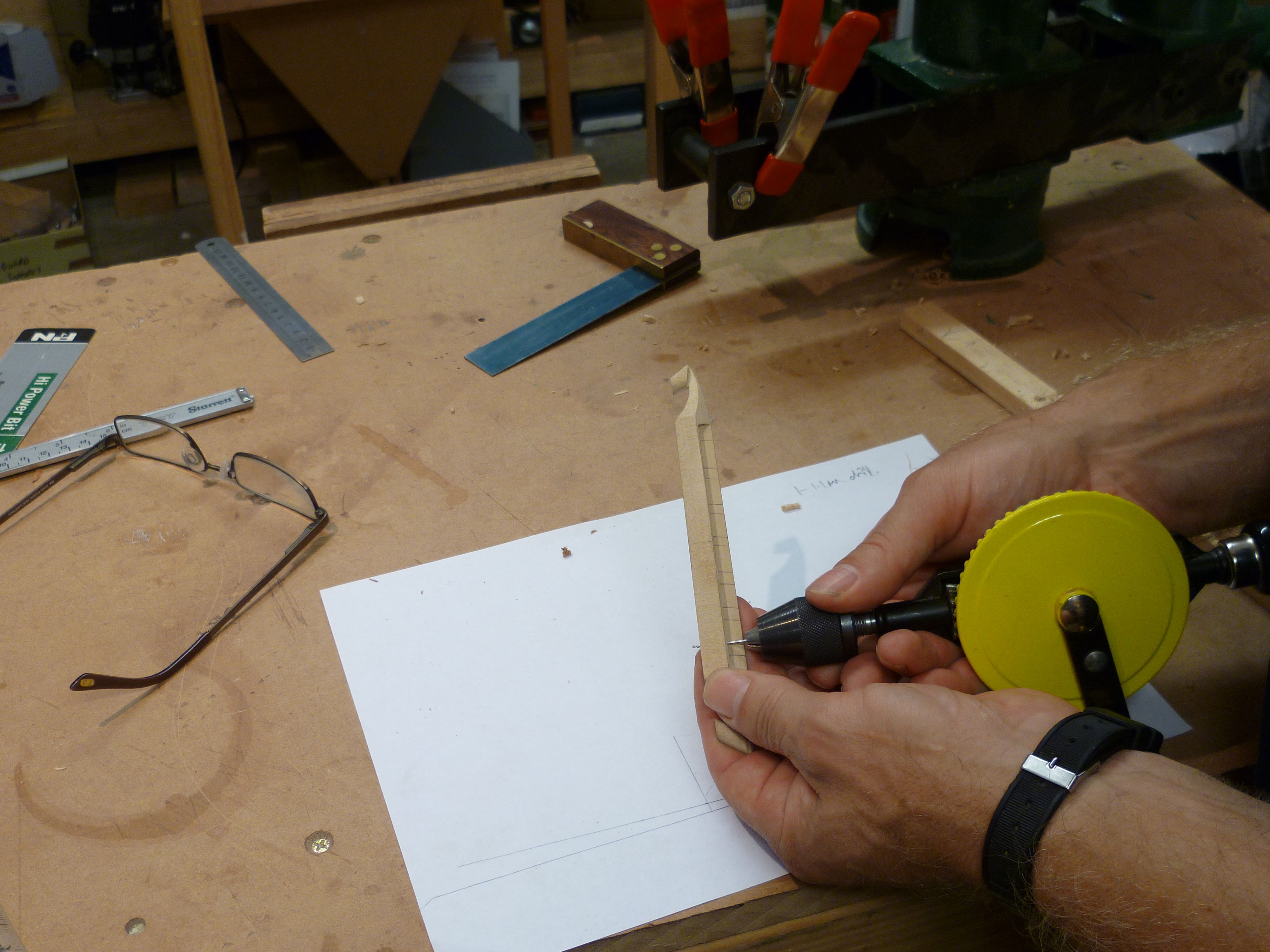

Found my 1.0mm drill bit this morning and got the string holes drilled. A dicey procedure where the holes are drilled from both sides of the bridge and then the drill is inserted and manually wiggled around to make the holes met up in the middle. Some makers drill the holes while the bridge is still in blank form and this method has its merits. Anyway I got lucky and the holes ended up all on target.

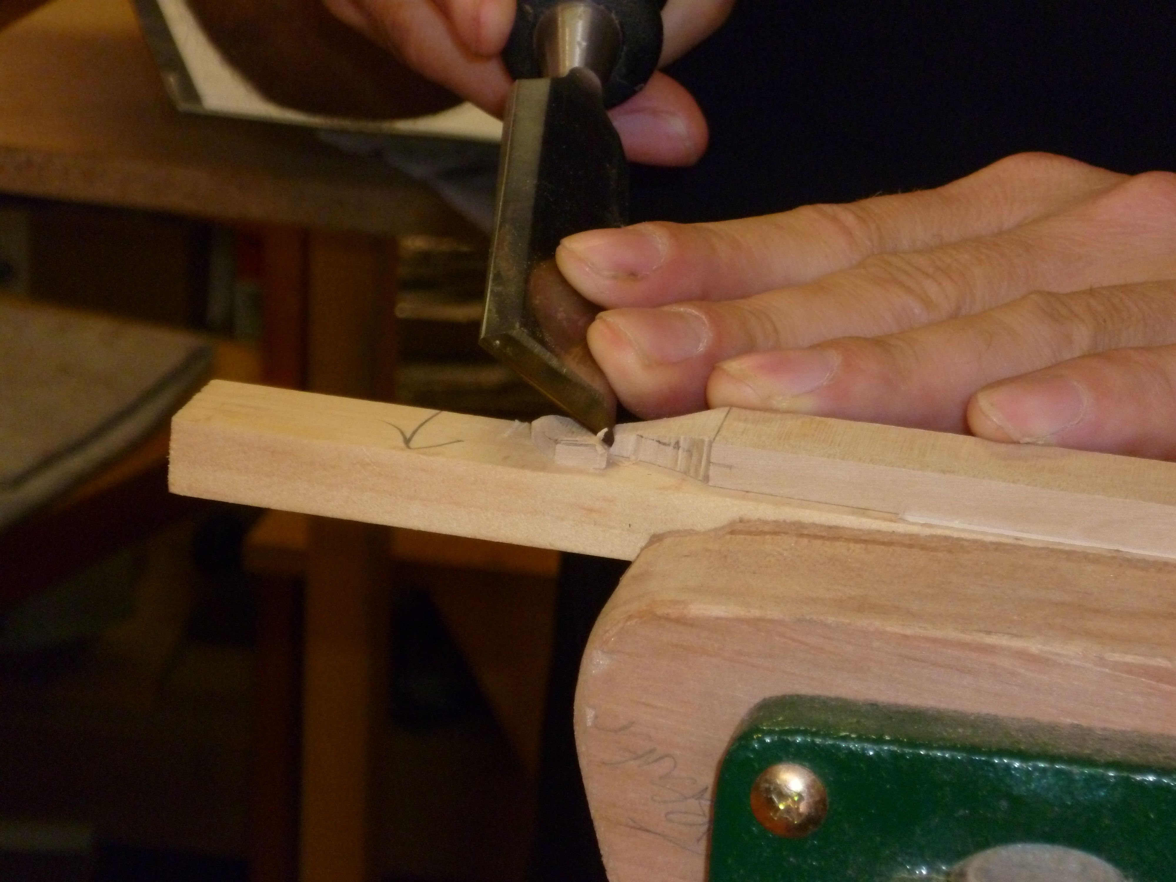

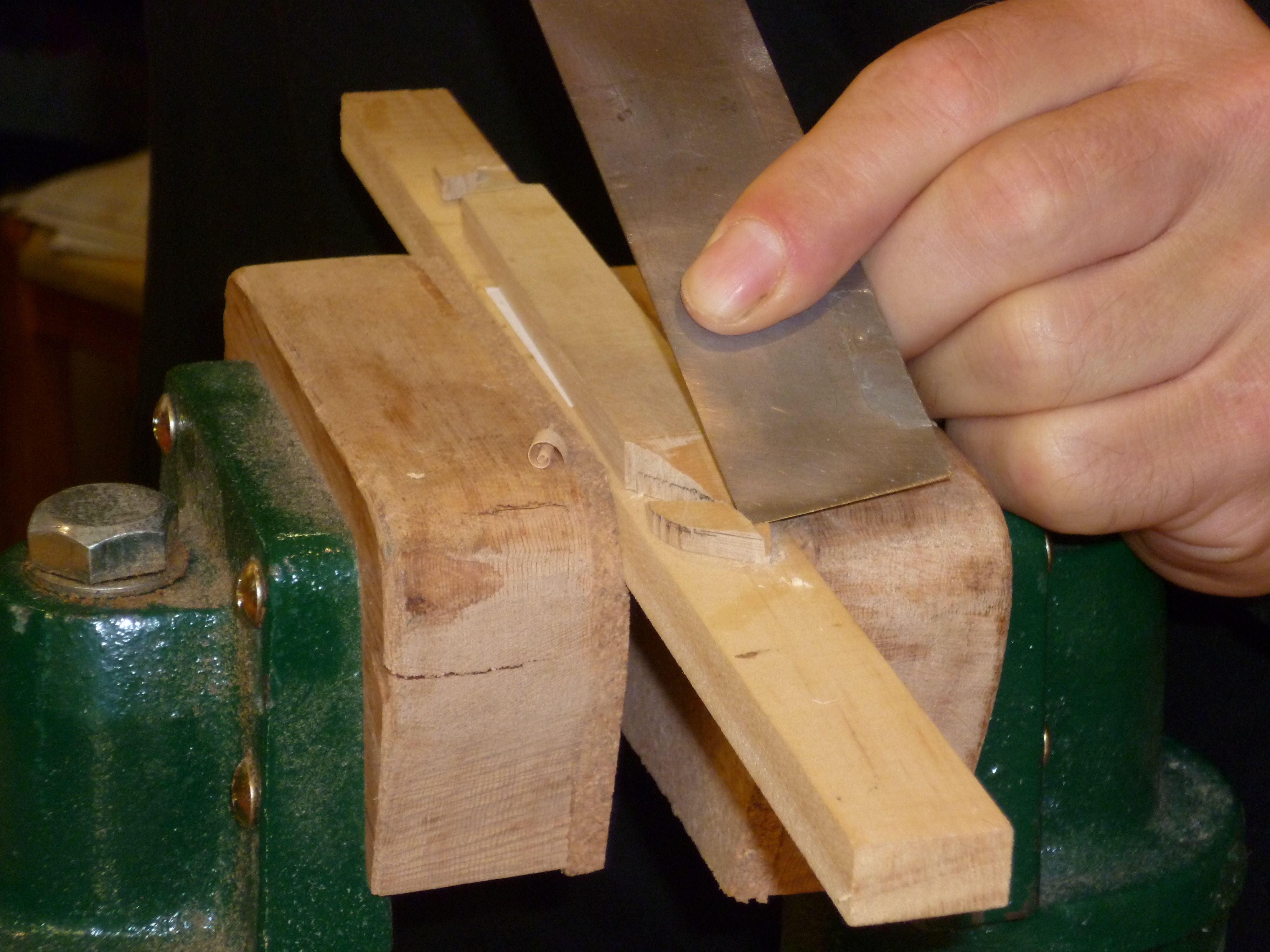

Post by Mike Thomas » Sat Feb 12, 2011 8:06 pm
That looks a bit like a Stubai chisel Martin. I expect you did a little bit of shopping at Mik's when they were still around.
Mike Thomas
Posts: 10878
Re: Lute Progress - Test runs for cutting the rosette
Post by kiwigeo » Sat Feb 12, 2011 9:01 pm
Mike Thomas wrote:That looks a bit like a Stubai chisel Martin. I expect you did a little bit of shopping at Mik's when they were still around.
Hi Mike,

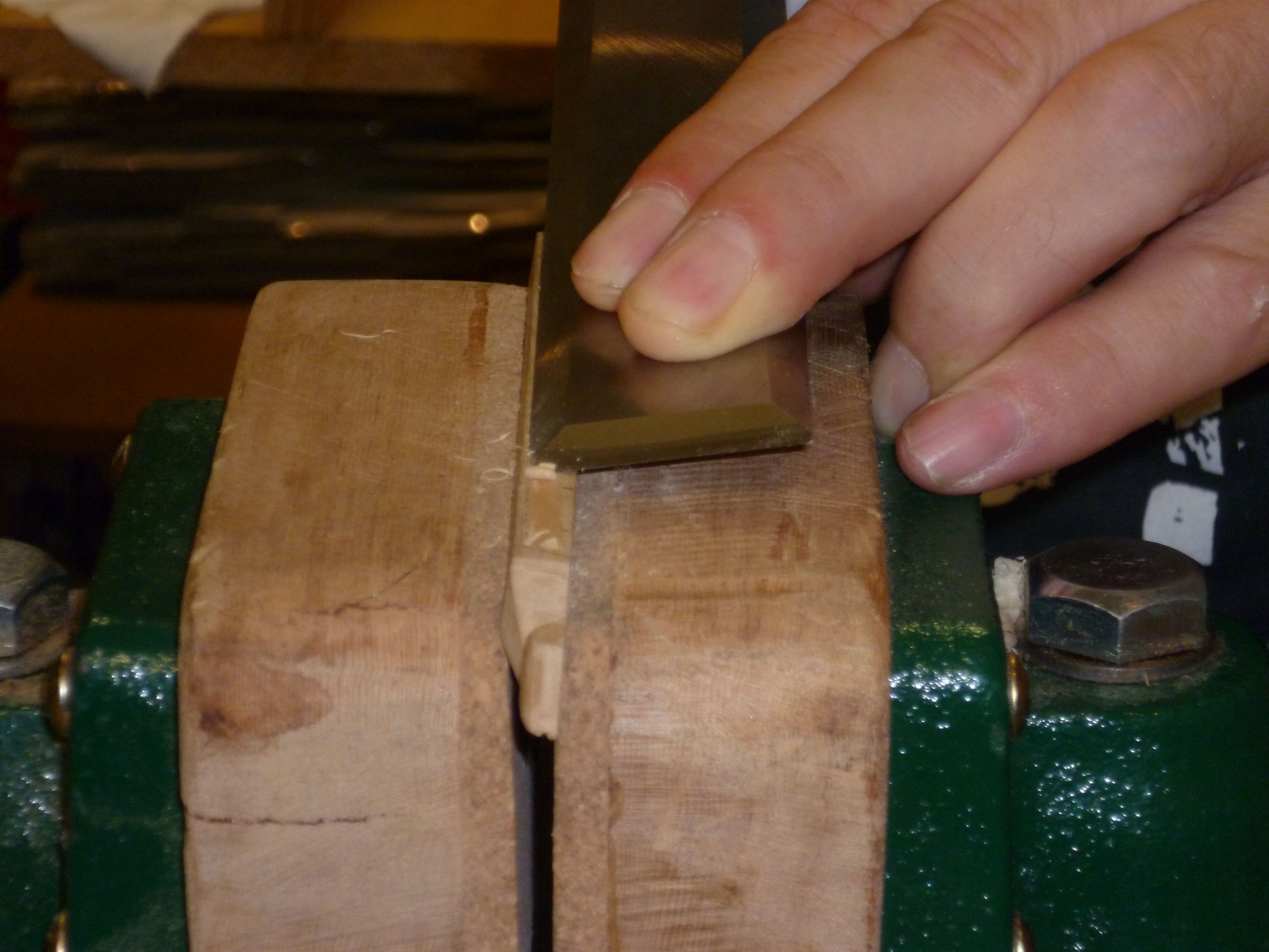

Yes Ive got a set of Stubais that came from MIK before they cratered. Theyre my favourite bench chisels. Most of the work on the bridge was done with My Robert Sorby paring chisels..also from MIK

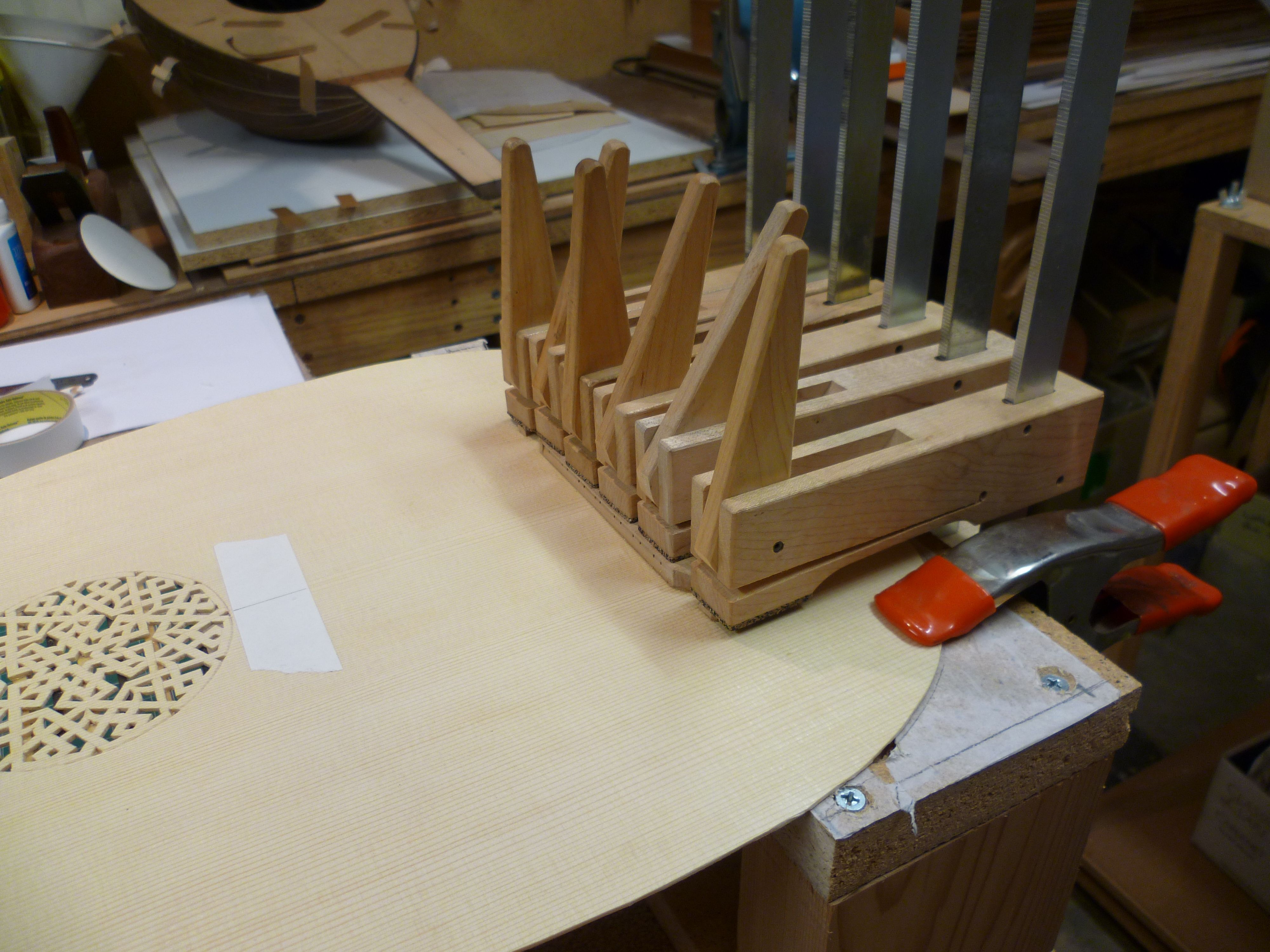

Post by kiwigeo » Sat Apr 09, 2011 6:32 pm

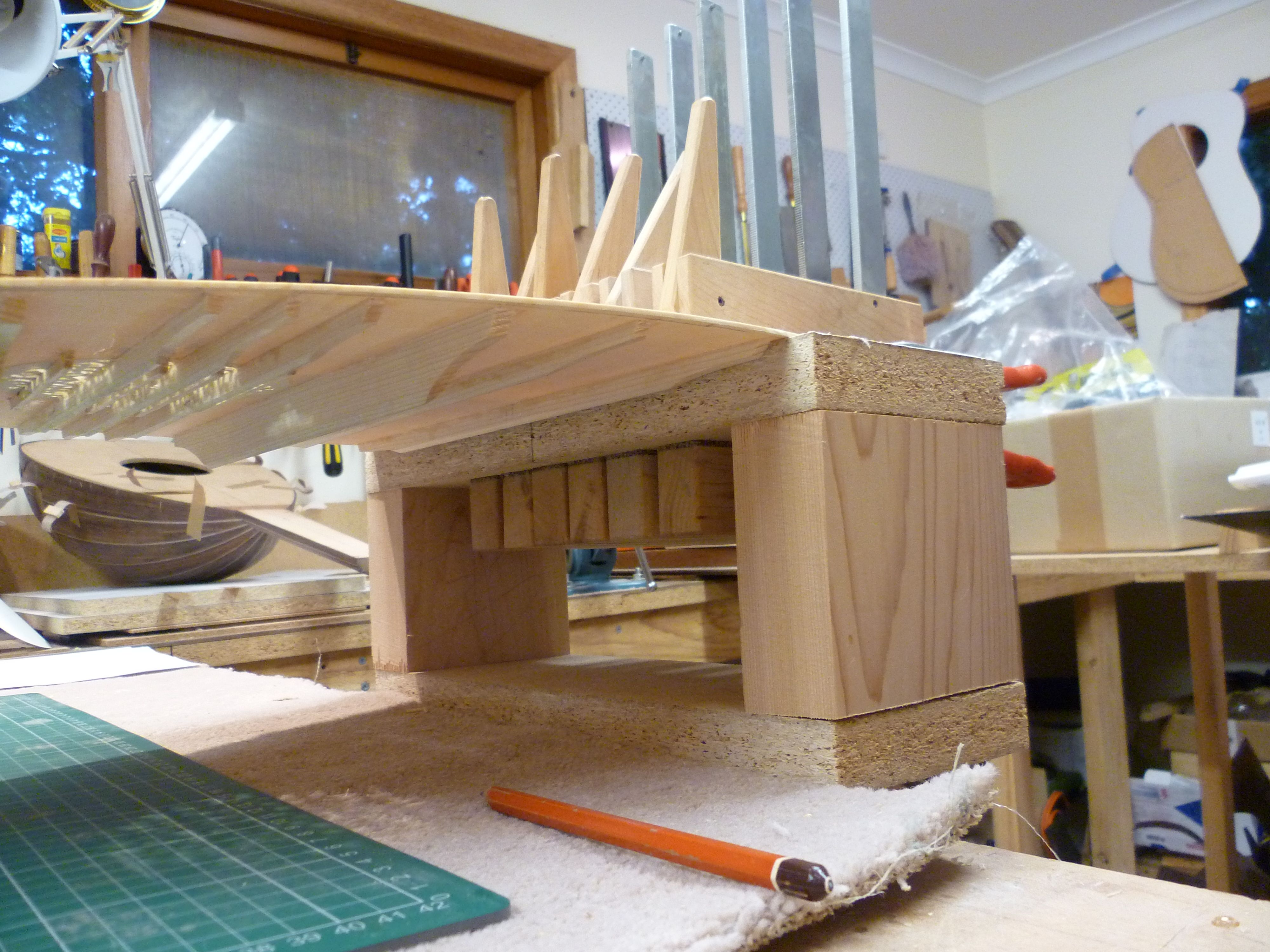

A wet day here in Adelaide so couldn't work on the new garden shed or do a bunch of other outside jobs. So I got the lute bridge glued on. The van Edwards tute uses a go bar deck to glue the bridge on but I prefer the clamping jig out of Lundbergs book.
