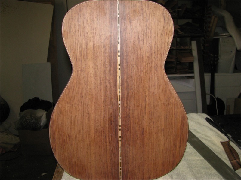

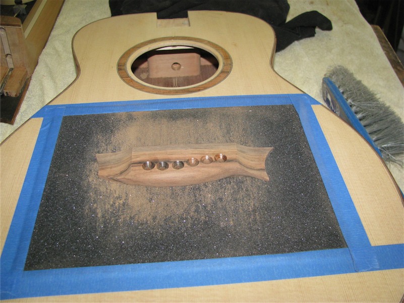

Starting to get to the pointy end of this one. It's Lutz Spruce from Shane Neifer on Honduran Rosewood back and sides with Cocobolo bindings. Ebony fingerboard and Braz bridge.

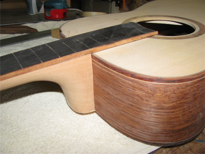

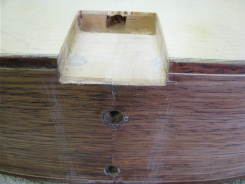

What neck joint Bob?Dovetail or bolt on M&T?

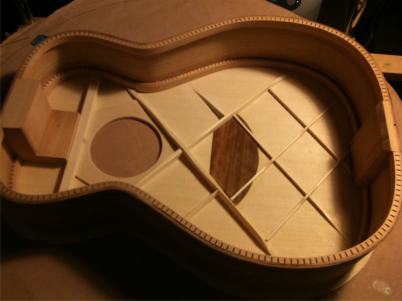

Hi bob, i was just wondering what size your your lower x brace is at is largest point? (the one that is right under the bridge plate also what is your upper x brace size?
Also how is your end block glued up? is it just face glued onto end grain?
or is it solid?

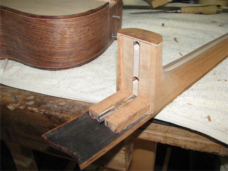

The neck joint is a butt joint Michael. the neck is solid one piece with an extension that fits in the body cavity.

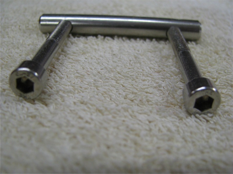

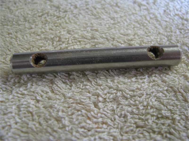

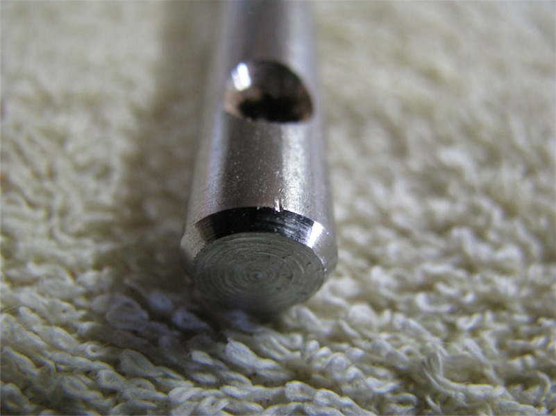

I've taken to inserting stainless rods and hex screws in the heel to attach the neck.
Rye - those lower X braces are very small - 3mm x 5mm - being a lattice they don't need to be very big to be strong.
The main X Brace is 13mm x 6mm.

Will you use a screw to help hold the extension to the soundboard so it isn't floating.SS is always a good thing.

No screw. The extension just sits in the pocket.

Sharp as ever Bob & that bracing looks cleaner than a clean thing. It's gonna sure look purdy when it's done.

Yeah she's a beauty Bob, can't wait for a sound report...and those inserts you had made up are veeery znazzzie. 8)

I'm impressed with the hardware . Getting those two threads lined up in the round stainless ain't easy. Nice work on the bracing and soundboard design too Bob.

Bob, did you have the stainless insert machined for you or are you tapping them yourself?

Lillian - I get the bass player in my band, Rick to machine them for me.

Nice work Bob, what can I say, bolt on neck.
I like the headstock and the way the tuner holes get closer towards the top of the head as I assume the strings travel over the nut straighter than a Martin style head.

I like the nifty neck joint Bob, did you have to make up longer truss rods?
