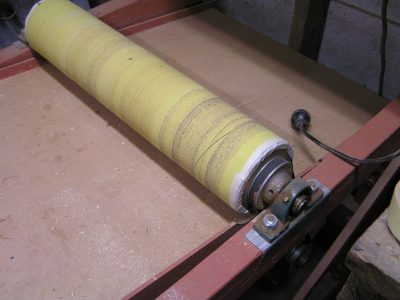

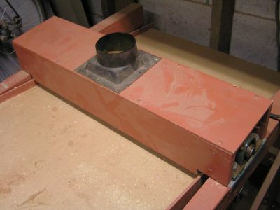

Re: Planer vs sander thicknesser...
Insomnomaniac wrote:
Has anyone got any pics of home-built setups?
My home made unit......I love it. Frank

Hi my first sander is a dead ringer for Franks, pictured above. I must have used it for 15 years before updating. Still have the drum, bearings and motor available if anybodies driving by.
It was mentioned earlier that a planer would not get used very often, I find thats true, but its also true ,in my shop, for a host of other dedicated and not so dedicated machines and jigs. Different strokes for different folks.
