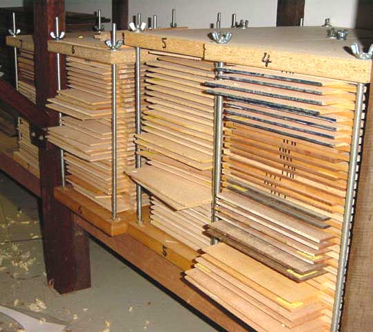

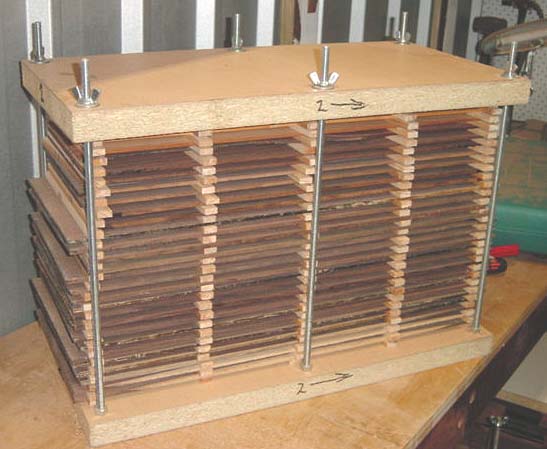

Have you tried resawing into sets 5 to 6mm thick while the wood is still quite green and then stickering and stacking the sets clamped under weight with the end grain sealed? I know this works OK for some wood.
Maybe you could make some of these presses and try it, for green wood you would want a few more stickers between sets for support than I have here and you would also want to make sure those bad boys could breath OK or else they will go moldy.

Just got back from my drive down south! As an after thought if you have the facility to resaw into sets that would be the best approach. This would eliminate 90% of the surface checking. Possibly have 8 - 10mm thick rack sticks at about 50 - 75mm spacing with a sacrificial top cover and dead weight.

Cheers again guys, I will try sawing it down into thin sets then shuving it in a almost sealed box to slow the drying as much as possible and keep a close eye on the mould, I will try to get a green one just before the wet season to increase the chances of drying it slowly.
