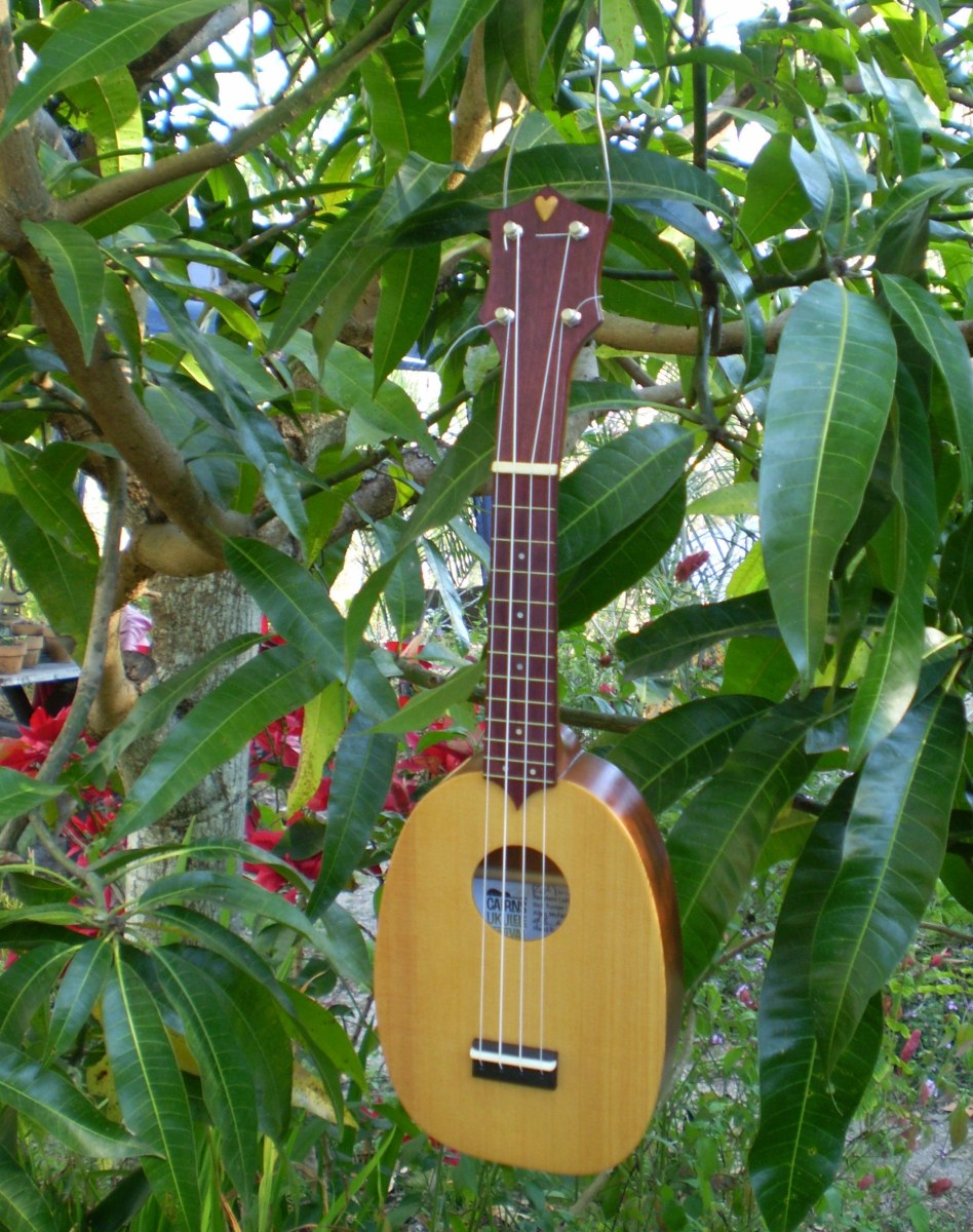

So, Allen helped me re-join the forum and just at the time when I have finally gotten the strings back on my uke made in the Cairns Ukulele Fest "Build a Ukulele in Four Days" class with Rick Turner... whew... just saying it all is taking me back... The course was too much fun! Now that I have completed the finish with Constantia Chinese Wood Oil... I have to report that in general I liked the product, but it didn't give a consistent finish on all of the different woods used. Where it worked, I am in love with it....I believe I should have used their Red Oil on the top...
Now that it's finished... do I really have to learn to play it?

Looks nice in the photo Isabelle. What is the issue with using it on the cedar?
Now that I have most of my projects under control, I'm going to make up some test panels and apply different finishes to them so students can see what the options are. The sample you gave me will make up one of those panels.
