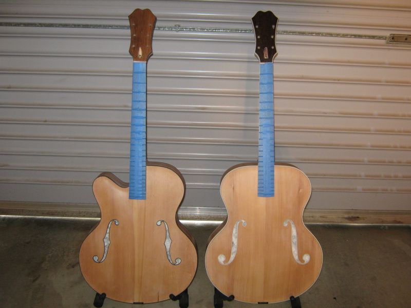

hey all, does anyone have any info on spraying a sunburst nitro laquer job? i've just got these two babies ready for sanding sealer and want to put a bit of a burst on them but haven't done it before, can anyone enlighten me? Cheers Rod.Image

Nice looking non cutaway Rod (not that the other one's too shabby either!).
