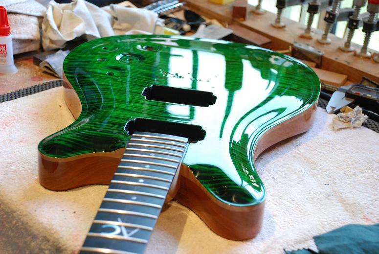

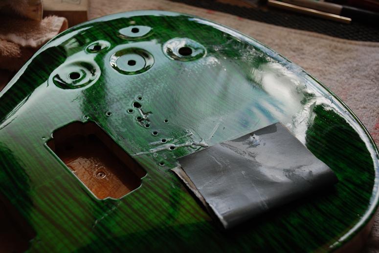

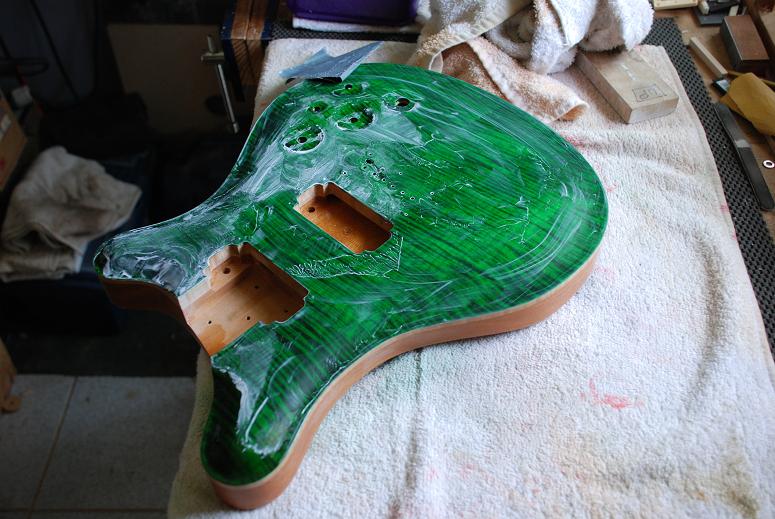

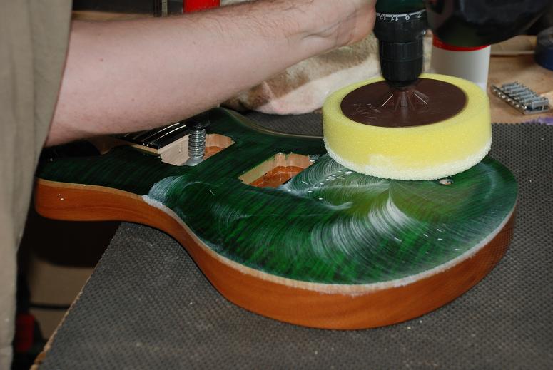

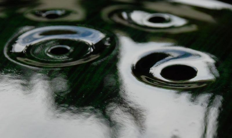

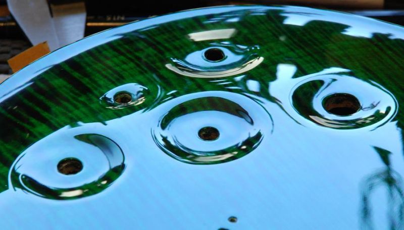

On my Bench - I am close to finishing the latest guitar. The guitar has been sprayed with acid cat lacquer and I have just cut it back and polished it. I have also added a coat of hard canuba wax for protection. I will post some finished pics when done.

Wow Jason that guitar and it's finish are looking excellent! I just watched Santana on the tube (tube is kind of a term of the past that does not apply well to today's TV's....) last night and he was playing a green PRS Santana model that the color looked exactly like what you have there.
Very nice work M8.

Thanks very much Hesh, I am really happy with the finish on this one. The green-ness of the finish changes a lot depending on the lighting. I mixed a bit of blue to get the malachite colour. I am going to go and search for that Santana video now - probably on You"Tube" :-)

Jason, that's gorgeous. And it does look like malachite.

Wow, thats simply gorgeous! I saw the first picture, and wondered what the heck it was. Scrolling through the images was a bit like opening a present. Great photos, and beautiful work. Thanks for sharing.

Jason; that green thing just rocks!

wow jase, fantastic finish, it's gonna look great with the fit off.

That is a cracker of a finish bud, awesome work. 8)

Jason, that is one amazing looking axe you got there. Tell us more about the polishing procedure please. Is that one of those hand drill buffers from Stew Mac? I need to get me a couple of those. Buffing by hand really sucks.

Thanks - Yes it is a Stewmac buffer and I use the stewmac swirl remover for the mildest of cut. I used to buff by hand but it took a great deal of effort to get a really good shine. It is also important to wet and dry at 1200 and 1500 to get a better quality finish.
