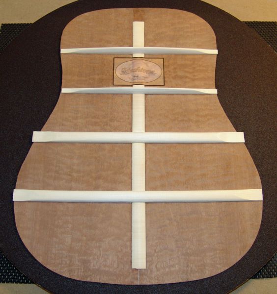

Well I have been busy and let me tell you it's been slow going here but I am having fun.
Here is my completed back ready to have the plastic, temporary shield taped over my label to protect it during finishing.
This guitar will be braced a little heaver than I usually do so it can handle mediums and perhaps be a gasser.

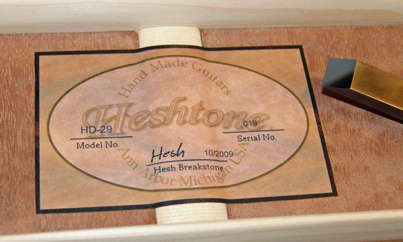

Here's my chisel pic Arnt.

Nice chisel pic Hesh-meister, do you use the scary sharp system or machine assisted as in a Tormec? I've been told to get one from a cabinet maker/craftsman as it does a marvelous job. Your's certainly looks like it could take somebody's eye out
Heshster, sharp tools are nice aren't they. I have a permanent bald spot on my left arm. I aim for being able to cut hair about half way up without bending it too much. Like you said, pop!
Nothing fancy, I just use a series of 6 Japanese water stones up to 8000.
The best thing I learned was the importance of flat stones. Dress your stones dead flat before each session. I have a flattening stone but you could use sandpaper on glass. Otherwise you will never get the whole back of the blade lapped properly. Then the bevel pretty much does itself.

Really nice interior label BTW Hesh.

Nick buddy I use a combination of the DMT diamond sharpening thing and Norton water stones. I have used the scary sharp method too but prefer water stones simply because once you have the stuff that you need there is nothing to ever run out of such as sand paper in certain grits.
The diamond sharpening thing is amazing and very fast too. Things that I used to struggle with such as getting a chisel into a rolling guide at exactly the same angle that the chisel already had I don't worry about anymore since the diamond sharpening thing will create a new bevel (as close as I can get to the original) in very fast order.
Norton stones are amazing too and really do a nice job. When needed I use the DMT to flatten my stones and that only takes less than a minute of rubbing the stone against the DMT.
I learned this method from Todd Stock from his YouTube video under the name of MDLuthier. Excellent method for sharpening!
The chisel in he pic is an LMI glue clearing chisel and it is mirror/razor sharp although the pic I posted did not focus correctly in the mirror surface of the chisel and it does not look as shiny as it actually is.

Gasser means a guitar built for bluegrass music also meaning loud and able to handle mediums (strings) since many bluegrassers use mediums. Remember that bluegrass guitarists have to play with banj*s so volume is important...
Allen bro thanks for the kind comments about my label. It's a pretty drawn out process to make these labels... but it is finally looking the way that I wanted it to. I spray the linen paper with lacquer after the label is printed and before I stick it on the back with 3M spray adhesive.

Dom my friend my label is set-up in Photoshop as "layers", 3 to be exact. The first layer is the text and graphics of the label and the second layer is set-up to be an actual photograph of the back wood that I may be using on a guitar. On this one I decided to not use an actual photograph of this guitar instead using an actual photograph of some BRW that I have used in the past.
The third layer is where I can add any text that I want such as the date, model, serial number etc. It is intended to be user changeable with each new guitar that I build.
Finally I sign the stinkin thing, let it dry over night, spray with lacquer, let it dry over night, spray with 3M spray adhesive (on the back side...) and then install. In addition it's printed on 100% linen with a mottled pattern in the paper.
It's a lot of trouble to go to but it's the best looking iteration of my label yet me thinks and I can customize the label to match the woods used on the guitar.

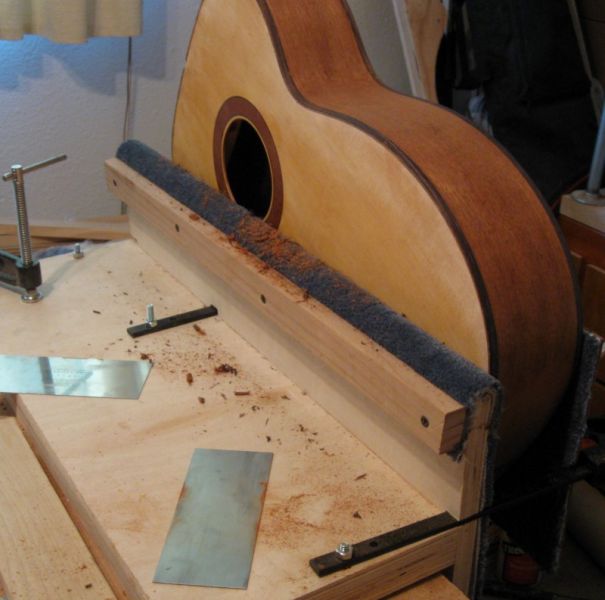

Hesh, don't look. It's not pretty.

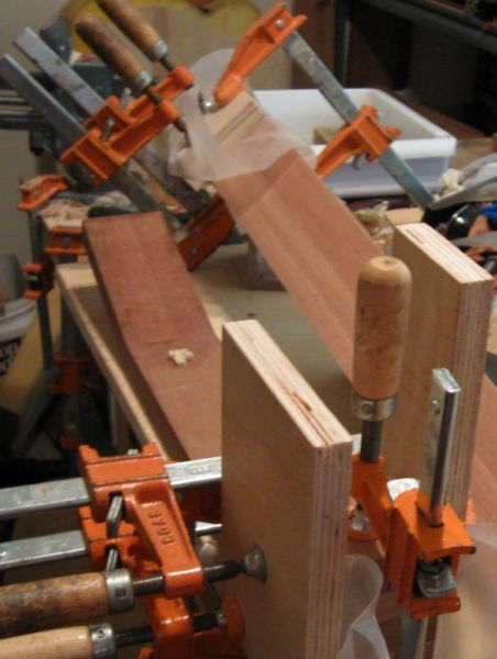

Two neck blanks gluing up. One fought me the entire way and took most of yesterday to do. The other one took less than an half an hour.

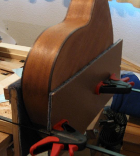

Shoulder vice in use. Thanks again Craig for sharing. I really appreciate it.
The body is almost completely scraped. Just a little section to go. I can only a few minutes of scraping and then I have to stop for the day. The tendon to my right thumb about quit working when I started the scraping phase. It was so bad in the beginning that I needed to wear a brace for two weeks and then nothing in the shop for two months. Didn't quite follow doctor's orders, but I am trying not to push it to far.

Sorry to hear the Tendon problems that hindering your build Lillian
Even with two good thumbs, a decent session of scraping and my thumbs are aching so I can only imagine what you're going through.
The builds looking good tho! What is the binding you have used? It looks really good against the Mahogany

I'll try not to disappoint Bob, but remember this guitar has been 7 years in the making. SO.... But I am getting closer.
John, Hesh's dog Sony is still looking for his smelling salts. I should have cleaned up I know, but if I had to make the shop Hesh viewable, well, I'd still be at it. But I agree, the rosewood does look so much better.

Nice work there Lilian...coming along nicely.
If the cabinet scrapers are causing you grief then what you could try is the Veritas scraper holder....this little jig holds the curve in the scraper instead of you having to do it with your thumbs. I use mine sometimes when Ive got a long scraper session planned.

What? Something that will allow me to work and not kill my thumb?? Oh baby, I'll have to look into that. Thanks Martin.kiwigeo wrote:Nice work there Lilian...coming along nicely.
