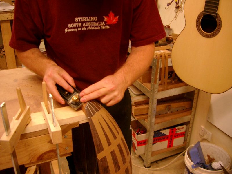

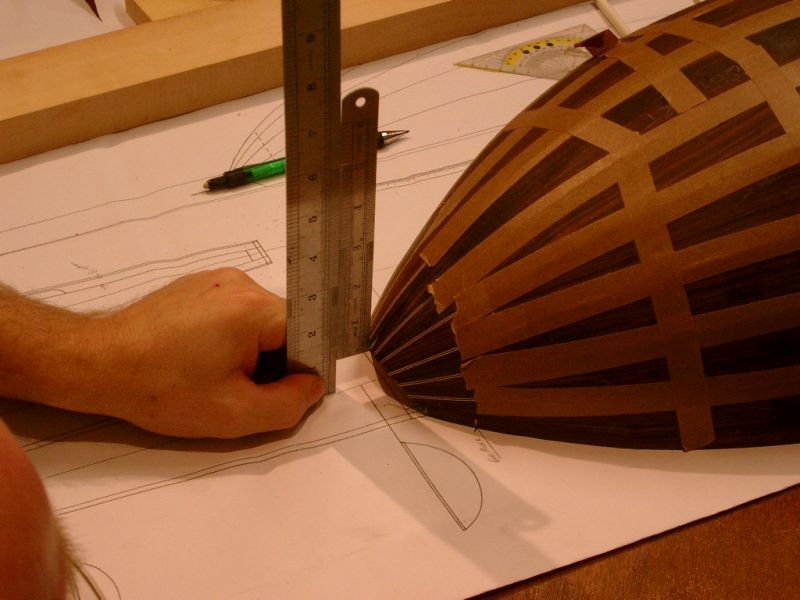

Took the plunge today and cut the neck block ready for the neck/body scarf joint. The tute instructs to do the cut with a japanese saw but I did it on the bandsaw with the table tilted at the appropriate angle. Once rough cut the neck block is trimmed to final dimensions with a chisel and block plane.
