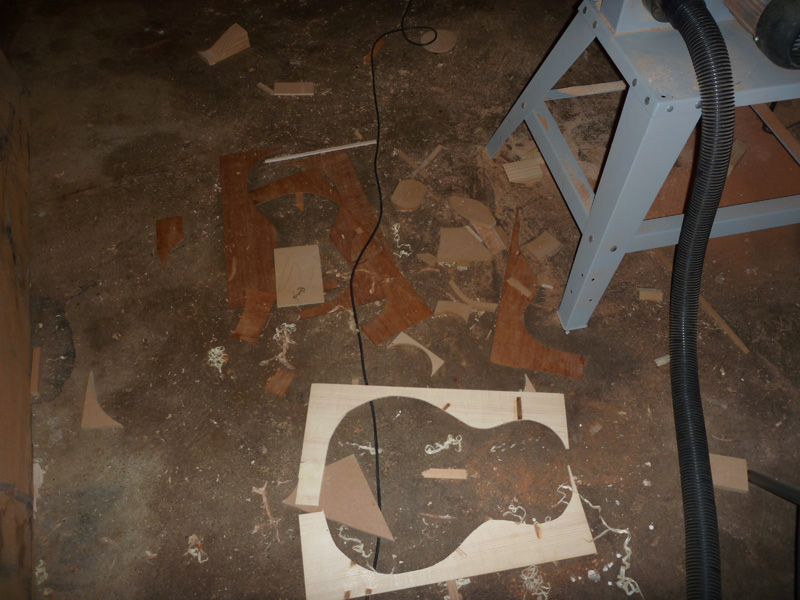

I made the school boy error of taking too much off the overhang with the router and bearing bit today and 1 section splintered off just into the kerfed lining. I am going to have a larger than planed binding to cover it up and it should be sweet. pics will be here tomorrow.

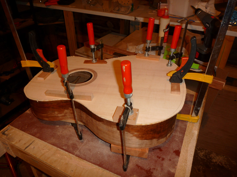

Post by xray » Wed Jul 22, 2009 8:27 pm
hey guys just a few more pics and good news its not swine flue! :!: :!:
Ive been feeling and still am feeling like death warmed up but you'd need a wrecking ball through my shed before i decide to hang up the tools on holidays. Anyway only a bit of progress this week so far but im now waiting on supplies before i start building again so here it is. Feel free to sledge or comment, its always good to see what people think.

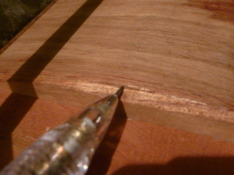

this is the chipout that i referred to last post, very fixable with binding.
This is not as good as the rubber stretching method but i havn't had a puncture lately so it will do.
This is the first guitar ive built where there have been no gaps on the soundboard join to the sides and kerfing. Im as proud as punch with this one.
i didn't really sand the corners off the bracing here because i saw some cole clark bracing not long ago and i think it kinda looks tough. i may change my mind here what do you think?

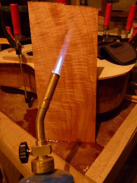

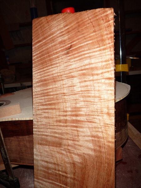

This is going to be the headstock material that i am using, it is some of my fiddleback qld maple that austen wants me to burn because it is not any good.
This one is for our friend Hesh. I call this photo "can hardly breathe at the moment so f?*k it, ill do it later". This is the worst my shed has looked ever. That makes me think how often do you clean the scraps and dust up in your shed hesh? Also if you have any spare leaves can i have one out of your book? :D
This one is for my jerk friend who may need cheering up at the moment. I told you i tried but it just didnt burn. so what now? hope yopu feel better soon buddy. Untill next time hoo roo xray.

Posts: 5259

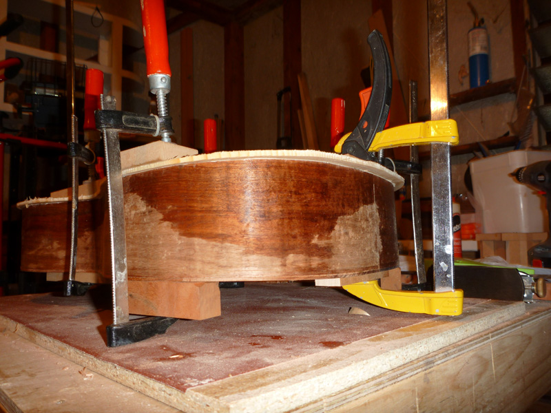

Post by Allen » Thu Jul 23, 2009 5:23 am
The only thing that I'd recommend in your method to attach to top is a few more clamps to apply a more even pressure, or use a caul that follows the perimeter and is a bit stiffer, so it does the same thing.
Posts: 1536
Post by jeffhigh » Thu Jul 23, 2009 6:36 am
Hi X ray, Allen just beat me to it on the clamping of the top.
Too many areas unsupported.
You have a go bar deck now, why not use that to glueup of top and back?
I just use shorter go bars about 20 of them around the edge
re the unrounded braces, I think the major problem with them is perception, they look unfinished or cheap to some eyes.
I have a weissenborn near finished with absolutely unrounded braces and I like it.
I do not believe there is any structural or acoustic reason not to go with a PROPERLY SIZED rectangular brace rather than a vee shaped or heavily rounded shape. This does not mean that they are the same shape as the starting crossection before carving to a Vee. You would start slightly narrower and slightly shallower.

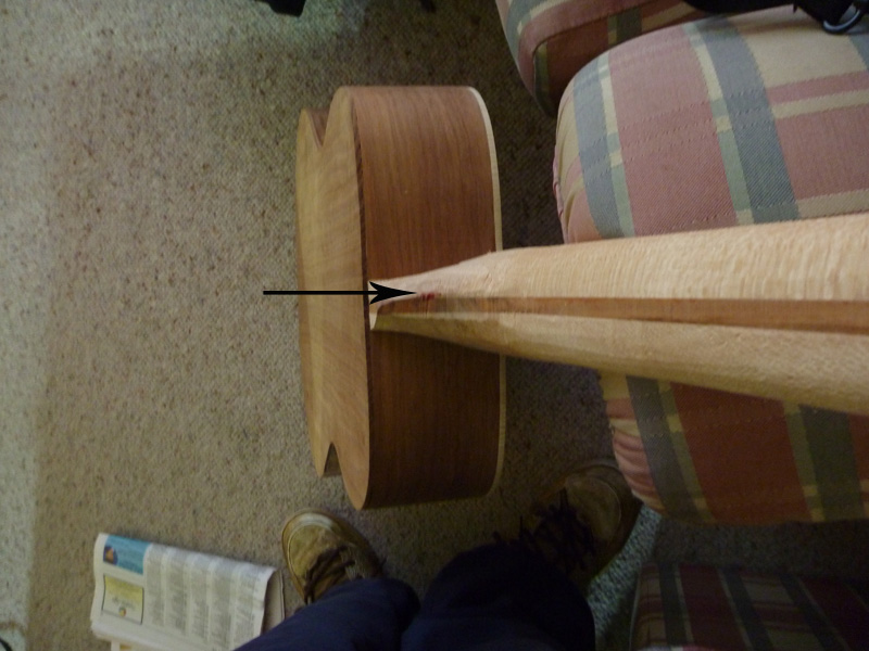

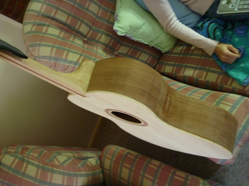

Post by xray » Fri Jul 24, 2009 5:16 pm
some more pics after todays romp. I have been really sick and have gone through feverish moments so ive spent no more than an hour here and there. A real bummer. Anyway here are some more pics. Im very happy with how tight and clean my dovetail joint is which makes 2 from 2 so far. As i understand they are easy to stuff up, but there is alot of satisfaction out of completing one hassle free, so until i bugger up these will be the joint of choice. So far no mistakes to write home about and the colour combinations i think are just, well, sexy. What do you guys reckon. No comments on paula please, she's my assistant.
back view of the first om
front view
bad picture but anyway you get the idea here
After dropping the guitar and neck from my work bench it almost hit the concrete floor but the only thing i could grab cut my finger to bits on the headstock. I think the neighbours kids would have learnt some new cuss words if it had of been damaged. The blood on the neck i hope dosn't stain the timber but it will be funny if it does, makes for a good story.

Post by Austen » Fri Jul 24, 2009 5:50 pm
Lookin good brother! Lookin real good. How much more profiling you got to do on the neck?
I like the two (for lack of a better word) dimples on the back. And the strip down the neck looks very smart.
I wanna be there when you string it up!

Post by xray » Fri Jul 24, 2009 6:34 pm
thanks pal, heaps more neck shaping to do however there is now light showing at the end of the tunnel. The dimples i hadn't noticed until you just pointed it out. I hope to get the profile pretty good in the next couple of days so i can get into number two soon
