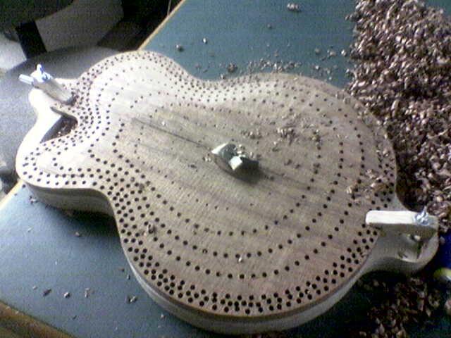

Archtops arn't that hard

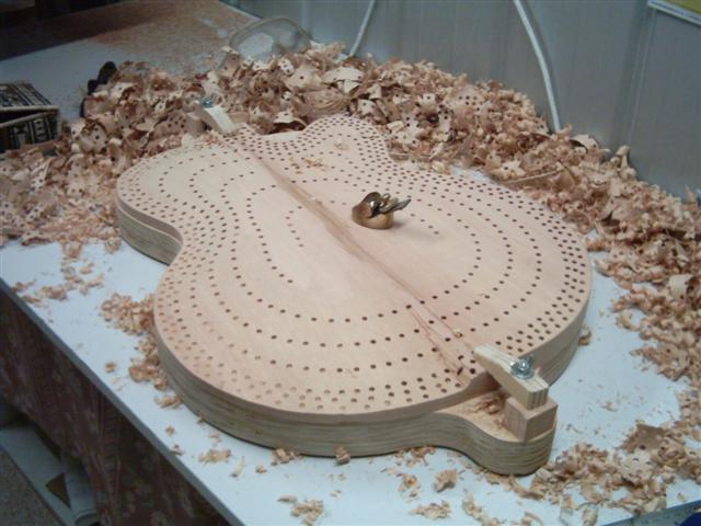

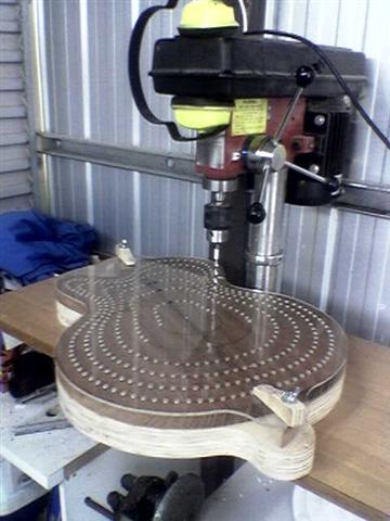

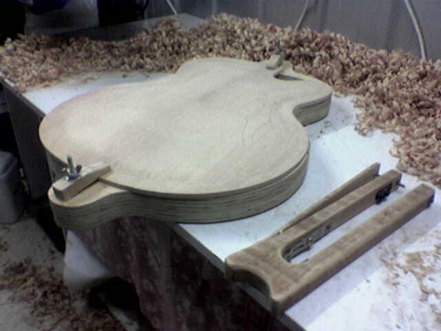

First work out your rough 'carve to' shape & drill holes to that depth

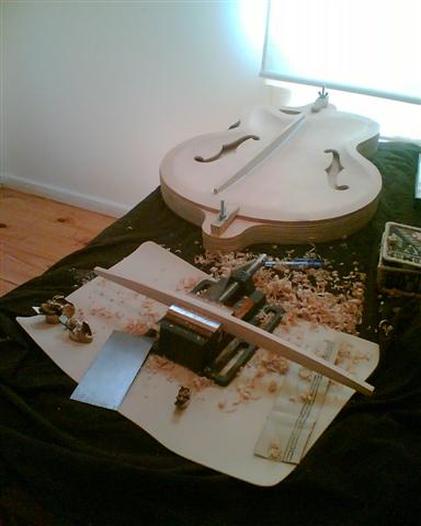

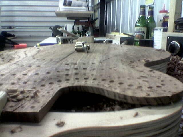

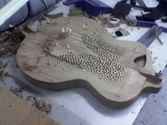

Get yourself a plane & start carving the outside.
Eventually a shape will emerge
Flip it over & carve out the inside
Get the topwood & start all over again......

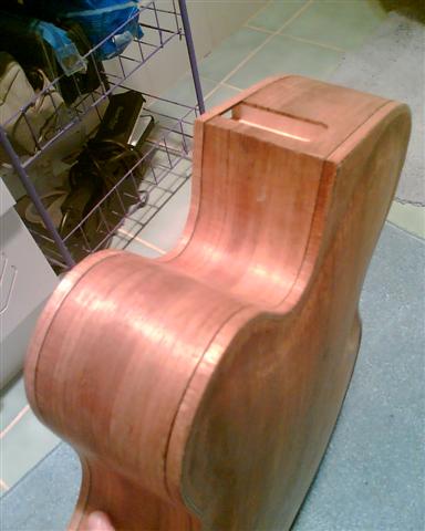

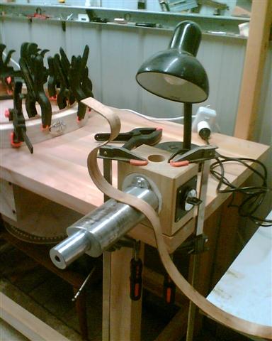

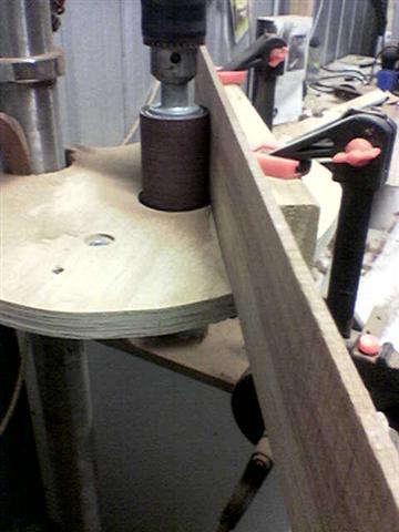

Figure out a way to thin the sides
Bend the sides to shape (photo taken showing an offcut from the sides)

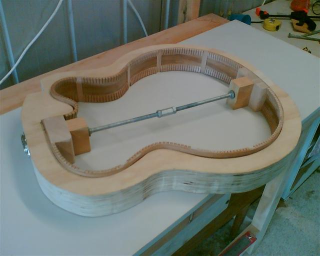

Stick sides in mold maintain shape

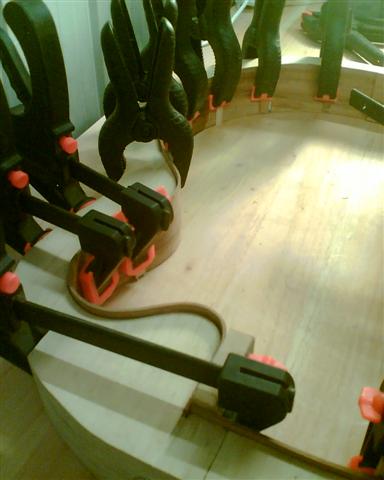

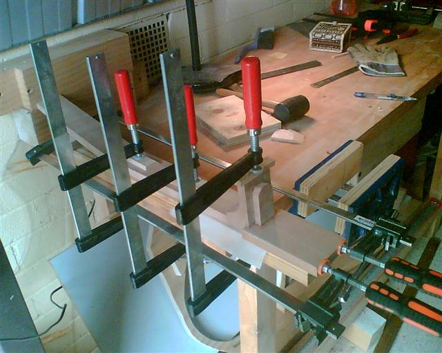

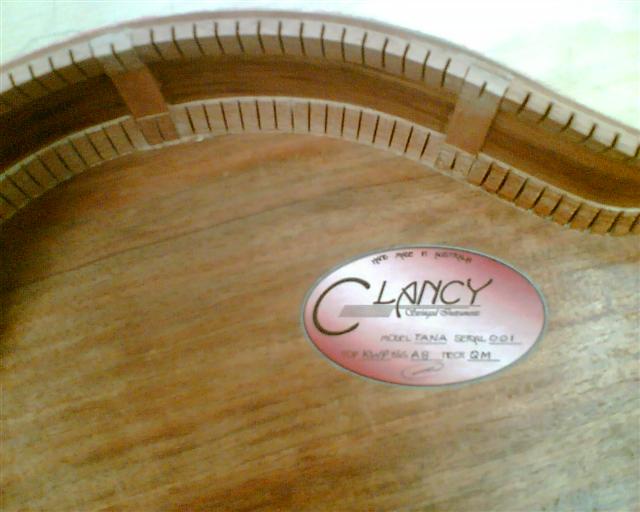

Add head block, tail block & linings
Level everything & glue on the Back.
Chuck on a hastily made label & give all a coat of sanding sealer.

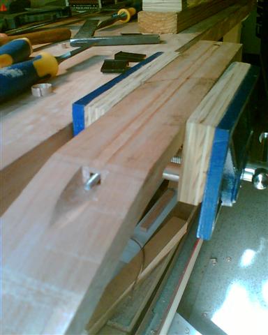

Now for the neck.
I didn't take many pics of this process for some reason (can't remember why)
It's a one-piece neck, cut to shape on a pissy little GMC bandsaw.
Truss rod slot cut with another pissy piece of GMC equipment (router).

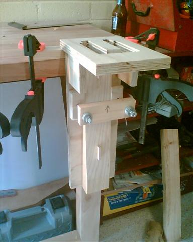

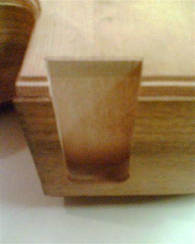

First up, the dove tail join jigs for the neck & body
which gave the following results

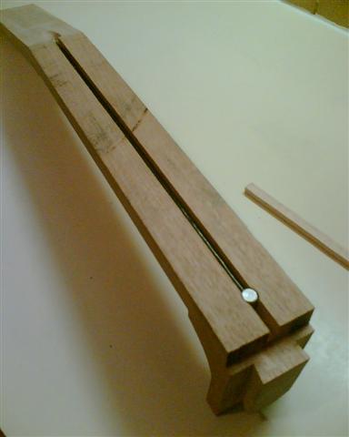

Home made single action truss rod with rubbery black tube cover
Insert into neck
And cover

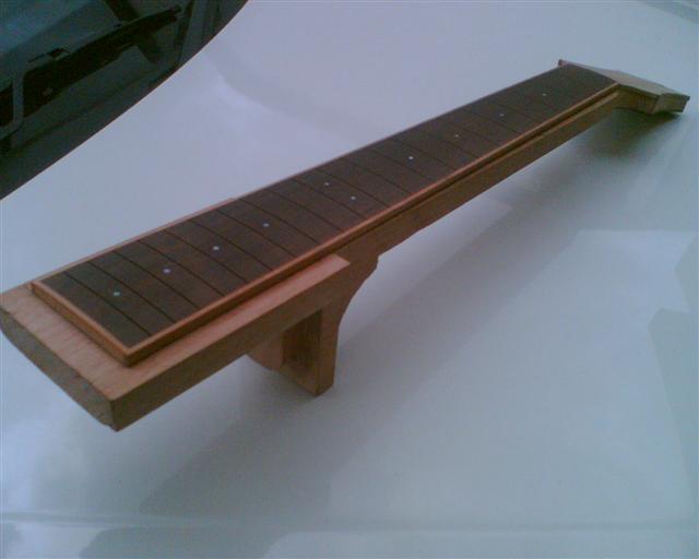

Add neck extension
Slot fingerboard & shape fingerboard & glue to neck
Add binding - it'll only take a minute or two

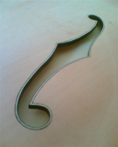

Trim everything up to fit & now you have something guitarish...

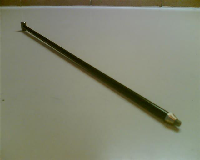

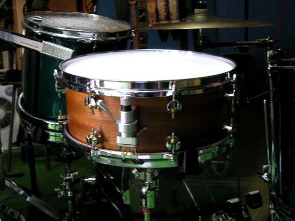

I haven't made any shells for a couple of years, just as I was redesigning molds, etc., nature intervened (the strory here http://www.recordingproject.com/bbs/vie ... hp?t=30325 ) and my garage/workshop became a storage area. A year ago, I re-entered the workforce, this has now allowed me to take on my "lutherie" interests and due to the products we're researching and now producing, future drum shells will not be made from timber but more about that later.
Re the drum hardware...........the snare strainer is from Trick Drums in the US, the tension lugs are "quick release" custom lugs from Todd Rathkamp (Rattrap Drums) also in the US. The bearing edges are done on a router table.
For anyone interested in drum building, there's heaps of info at either http://www.drumshed.org/forum/ (this was originally Ghostnote but changed name after a split within admin) or http://www.ghostnote.net/vbforum/ (this 2nd generation GN forum is quite active but seems to be home to a more redneck element

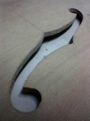

HOLY M'COW!!!Nick O wrote:One of Bob's creationsvandenboom wrote:It is interesting to read in Benedetto's book his view on all this. Stories of experienced builders using structural pine from their local Home Depot store and producing a great sounding archtop.
Worm infested top, goes to show it ain't necessarily the quality of the wood but how it's made.
I've seen some mishaps with a router but that is ridiculous. Note to all budding luthiers - Anyone with advanced Parkinson's disease should consider using templates...
Sorry in advance for any offense caused to any persons unfortunate enough to have this disability...
Is that like the modern art equivalent of a sound aperture? Perhaps why not to use a shotgun to create your soundhole? Anyways, they are some serious worm holes
Does however go to show that great wood does not equal a great guitar and vice versa. It's the builder and their ability to work, judge and compensate for the materials at hand that will ultimately make the guitar a great one or not so...
