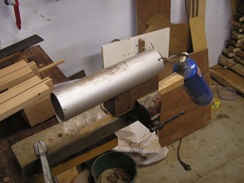

Post by woodrat » Wed Jun 17, 2009 6:16 pm
They can be made very cheaply. Aluminium pipe from the tip (got to have sharp eyes and be lucky I suppose) Gal pipe would do too. Image

I use a couple of lengths of brass pipe 65mm and 40mm (roughly) in diameter with a propane torch. One worthwhile addition is mostly filling in what would be the non-torch end with a bit of brass sheet cut into a cross shape and pop riveted onto the end.
The pipes are hot enough when water sprayed on bounces straight off. If it sits there and bubbles the pipe isn't hot enough and there is a good chance your side/binding will break

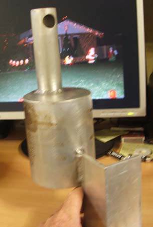

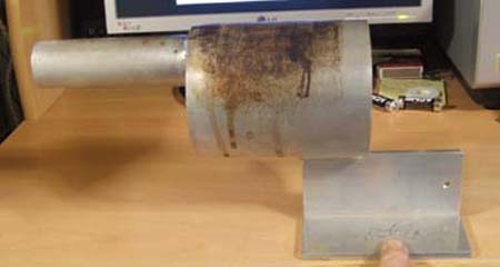

Aluminium bender heated by a gas torch. It works quite well .
Cheers from Micheal.
