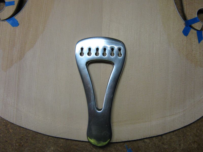

on my work bench
this is an alloy tailpiece i have had cast , and will have it chrome plated or anodised.

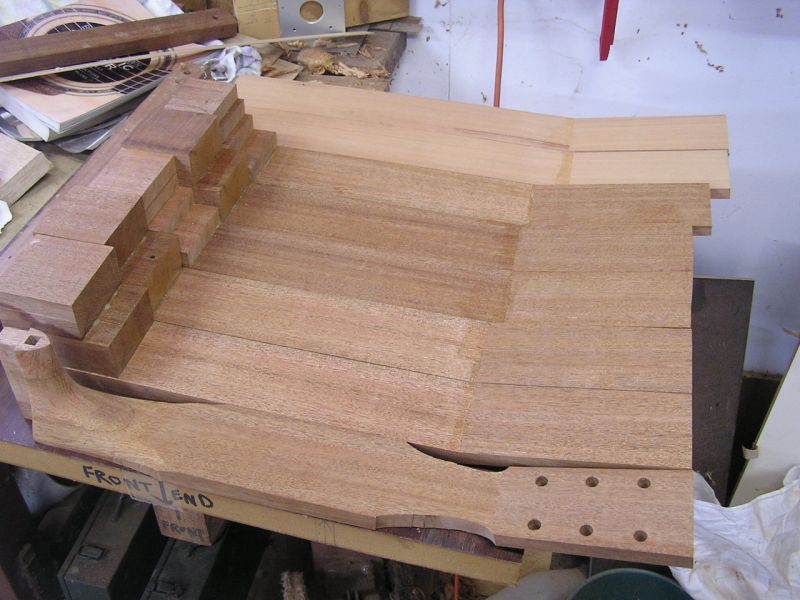

Here are some pics of whats on my bench at the moment.
Six Brazilian Mahogany and 2 American Cherry Necks
EDIT......Im having trouble uploading some pictures

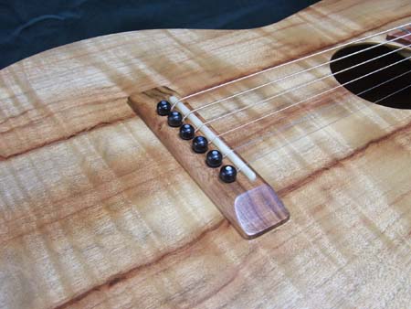

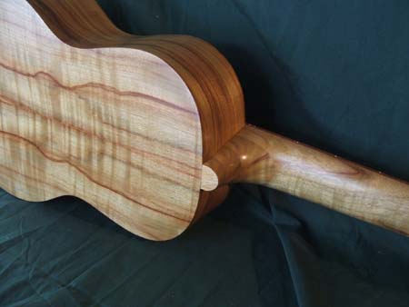

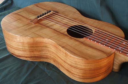

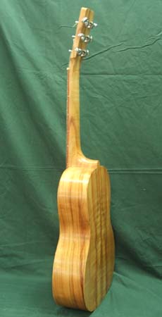

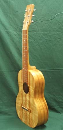

Finished off my 3/4 (style 5) .Body is all Camphor Laurel with a Cooktown Ironwood fret board.Played around with a few sets of strings.Started with some 10-48 PB but didn't have enough tension on the low E.Changed it to Nashville Tuning (12p-14p-10p-16p-20p-30W) for the Guitar show in Brisbane.More tension drove the top much better and the odd tuning( almost mandolin sound) was a hit with people who played it at the show.Very nice when finger picked.Moved on to some 11-50PB but still had a problem with the low E so it is now up to 12-53PB and it works well.Nice full sound and a small guitar to hold and play.Cheers.

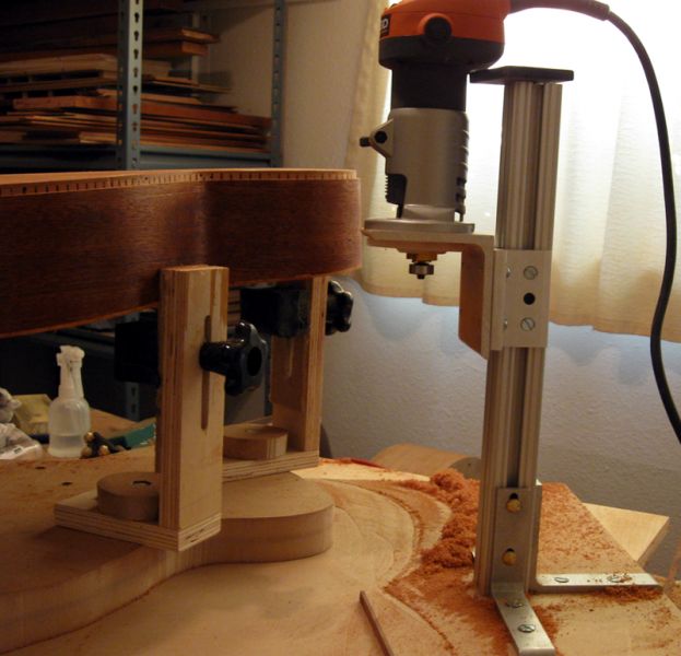

Well, I have finally stolen enough time to get the binding jig done. All things considered, it seems to work well enough. I was able to cut the channel without any major mishaps. There is a place or two the needs tending to, but all in all I was very surprised with its performance. I will say though that I do not like the cradle I came up with so much. I'll end up redoing it, but for now it will work well enough for me to finish cutting the binding channels.

Thanks Steve. It feels good to be moving forward on this again. Though I'm back to waiting for purfling. Decided that I needed a thin black line to offset the binding. Nothing fancy, but a better, if not subtle delineation between the mahogany and the EIR bindings. I want to wait and glue the purflings onto the the binding before I bend them. Which is okay. I go see the oral surgeon tomorrow. Don't think I'll be in much of a mood to do anything for a few days.
