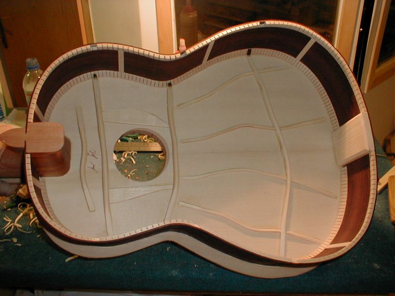

Mmmmm...looks like one of my bracing jobs after couple of vodka lime and sodas.

He uses lots of big scientific words and formulae which may or may not make any sense at all. It needs someone like Al Caruth or Graham Caldersmith to interpret for the rest of us. The wiggly braces are just weird, and the 'rule of consonance-dissonance' is equally as puzzling.
We should remember that Michael Kasha's scientific reworking of the guitar soundboard hasn't changed the wold in the 30 or so years since it was touted as the next Great Leap Forward in guitar design. Greg Smallman has shown us that the important thing is the stiffness and the resonant modes of the soundboard. This bloke's wiggly braces might well do that as well, though he seems more focused on some objective measure of 'tone'

What are you talking about Martin? I've had a couple of vodka lime and sodas and those 8 braces look pretty straight to me. :dru

I love that vodka lime and soda bracing job!!!

Then of course these results are done on wood in the white, what happens when it's finished? Again, to me at least, it's just another builder using scientific 'results' to justify the way that they do something & who knows about that bracing? :shock: as Graham said, Kasher proved there's more than one way to skin a possum but is it necessarily any better? Best of luck to him if it is & "vive la difference" 8)

What do you mean those braces aren't straight.
I've got a theory that says they are!
It's the rest of you that are wobbly, especially after all those vodkas (and you've got to watch them limes)
