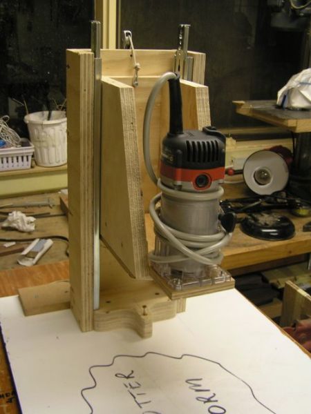

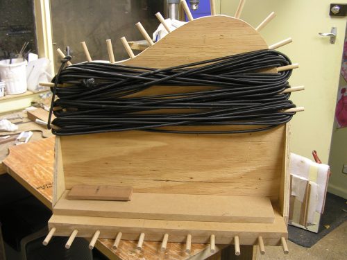

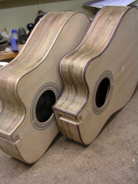

Hi everyone - have just started to try and keep up with anzlf posts daily - impossible on olf. So here is my first contribution. I am pretty new at this so my offering is nothing flash - I am still trying to make a good basic dreadnought.
I have just finished the bindings on the two dreadnoughts below - project 6&7 - my first cutaways - you might just see the cracking on the outer bend on the left guitar, damm it. I have not been satisfied with my binding job on the first five - so getting this right was a key goal this time around. Hence the two jigs below - the well tried binding ledge cutting jig, and a roping jig that I found on Mike Doolin's site - it worked very well.
I'm sure most of you have seen all of this stuff before.

Dreadies are looking good too Frank!

As for getting bindings nice and tight Frank. Looks like your on the right track now. I use "Twill Tape" or sometimes called "Herringbone Tape" you can get it at Spotlight. 20 mm wide and around 20 meters long is good for a guitar. The advantage with it, is that it's flat and has a wider area to bear against the binding.
You can see Robbie O'brien demonstrate using it on his binding YouTube video.

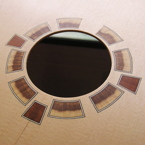

J.F. Custom wrote:... This is a rosette I had recently completed on a bouzouki I am building ...
It's Ring Gidgee and Ring Mulga with mitred purfling on each piece.
Jeremy,
Each time I visit the ANZLF lately I see your avatar, and have to stop and take a minute to let you know that is one of the most beautiful rosettes I've ever seen. I just like everything about it. Congratulations on creating such a successful artistic element. Thanks for showing it!

Well I'm not sure I can say thanks quite as eloquently as you have worded your compliments, but erm, thanks! Seriously, it really is appreciated. Sometimes it can be difficult to judge your own work, so compliments from fellow luthiers provide welcome encouragement.

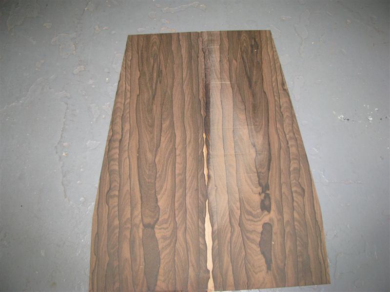

Here's a Lutz / ziricote 000 with ash bindings and ash and rosewood pruflings

Im not quite understanding the timber on the back could you let us know. It looks like end grain?

That's quarter sawn Ziricote Tim.
One of the most amazing looking woods you'll ever come across.
