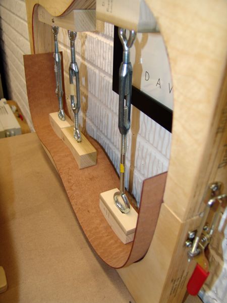

Here is a shot of one of the Sapele sides in the bender. This Sapele seems to be a bit more difficult to bend and the first side had an unacceptable amount of spring back which I fixed on the pipe. The second side I cooked hotter, used more water, and left in the stinkin bender longer so we shall see if this helps:

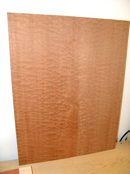

Here is a shot of the first Sapele side - very pretty wood indeed:

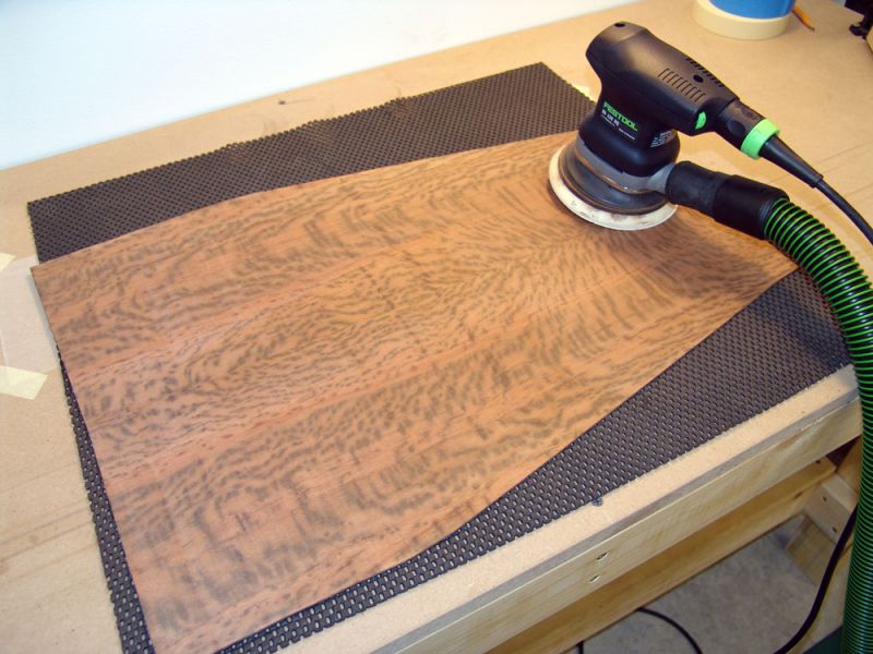

And here is the Sapele back now joined and ready to be sanded with the ROS and 120 next:

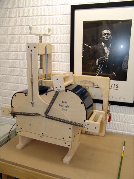

Hesh...WOW!!!....that side bender, what can I say (was it made in the Ferrari workshop?), I guess you will get and nice laugh when you see my first side bender. I have only used a pipe up until my last two which I have made benders for, will post them in a thread for your entertainment. Looking forward to watching your builds.

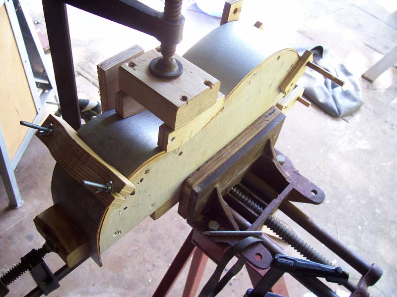

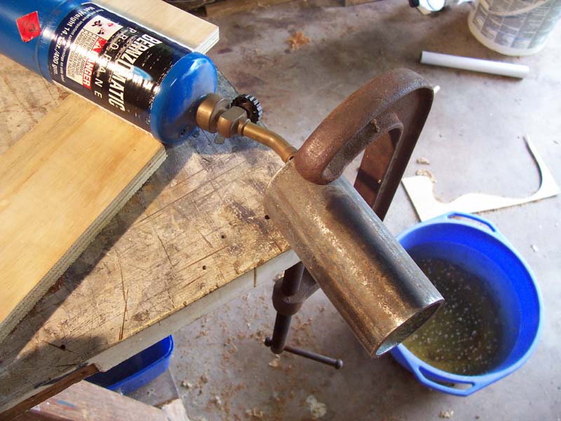

Post by DarwinStrings » Tue Apr 07, 2009 2:59 pm
I keep coming back here to look at that bender of your's Hesh. I have always done it by hand on a pipe but this forum has made me make a few changes.
From this
To this
I don't have one of those blamkets so I just used a hot air gun and it worked fine, the blower does 600 celcius which would be ignition temp for some woods. It was faster than bending by hand.
The next step I suppose for me is to use yours as a model, I assume you use a blanket Hesh, is that correct?
Post by Allen » Tue Apr 07, 2009 4:54 pm
I've got the home made version to Hesh's. It's so much faster, and produces sides with little to no ripples that it's not much fun to have to go back and bend by hand. The blanket for mine came from MEI. They are in our approved vendors section. At the time about $110 AU landed on my door.

Jim my friend knowing how to bend on a pipe is an important skill to have and even though I use my Fox style bender most of the time I still use the pipe at times to touch-up difficult sides that have too much spring-back or for bending other things.
The Fox or Doolin style benders do make things way easier though. If I were to do it all over again I would check out the Doolin style bender and not because there is anything wrong with the Fox style - the Doolin style is just simpler and takes up a bit less space and requires less wood and hardware to build.
