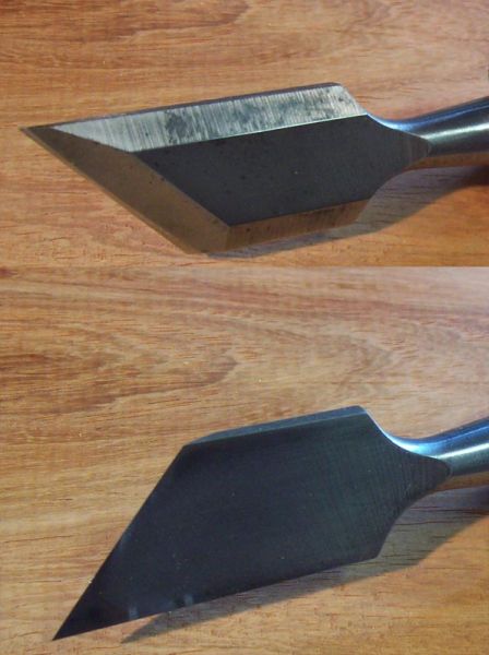

I would like to add my take on neck carving as I use a skew chisel to carve the transitions from heel to neck and from headstock to neck not because it is any better than a rasp but just because I love the feel of using a skew chisel, also they are simple to make.
Just cut the end off a 25mm chisel with one of those thin kerf metal discs on a 100mm grinder then hollow grind on a bench grinder continuing to cool the blade in water as you go, then polish, hone and carve away. Keeping it short gives better control.

Jim, does it matter which way the blade is skewed? Or do you have a left and a right? How long is the handle? This sort of reminds me of the knives I've seen used in shops in Mexico.

You can cut them either way Lillian, mine is right, you could have two but i find i only need one. The handle is a standard carpenters handle of about 5 inches. You can buy them made like this but they tend to be pricey.
