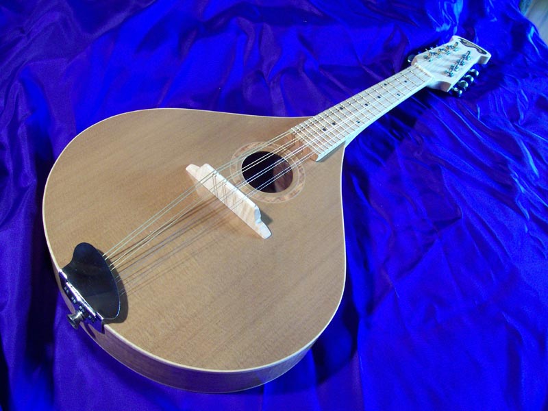

Here is a recently finished Mandolin. Blackwood back and sides, Western Red Cedar Soundboard, Rock Maple Bindings/Bridge, Stainless Steel tailpiece/Neck Bolt Plate and a Rock Maple one piece neck a la Leo Fender.
The Bridge in the photo is different to the bridge in the sound clip, I'll post some pics of the altered bridge later.

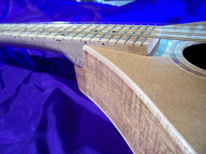

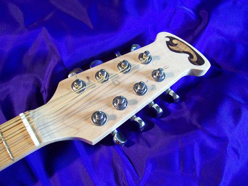

You may notice that I prefer to mark the 9th rather than the 10th as I like the way this method looks on the front of the fret board.
The action is up high as this pic was taken when it was first strung up. I set it high and play for a month before setting it low.

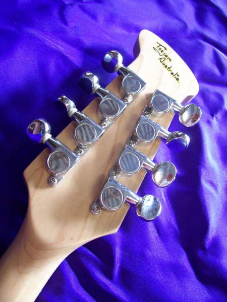

I bought cheap Tuners to see how they were....never again, worth a try though you never know.

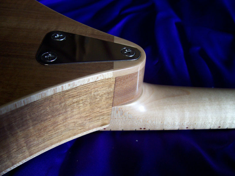

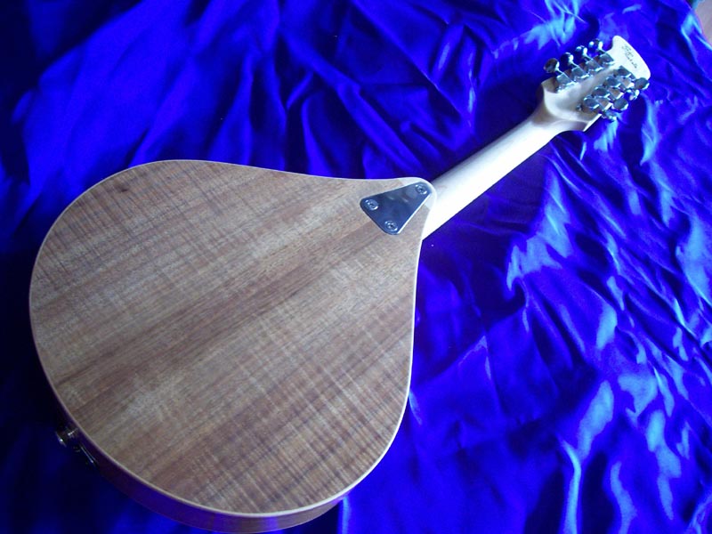

I'm interested in how the neck is being held. I'm assuming that the neck block is fairly large, and that stainless plate on the back is supported by it? Do you use some sort of inserts in the neck for the screws to attach to?

Allen I'm not sure if you missed the YouTube link above the first pic, it has a brief two chord piece, G and Amin my favorite chords. The last 6 or so bars are just one track of the instrument being strummed alone. And the neck to body joint is just like a Fender Electric Guitar, the heel block extends just past the end of the fret board, through that block into the neck is three #12 x 2" SS screws that screw straight into the piloted Maple with the SS neck plate being nothing more than a fancy washer to stop the countersunk screw heads from splitting the block. No bolt at all its just refered to as a "bolt on neck".

Thanks John. It is definitly a Mandolin, that is to say that the scale is 350mm long and it is tuned to G,D,A,E. Mandolas are around 500mm scale and are tuned C,G,D,A from memory. Also it is my design so I have no plans other than some lines drawn directly on my bench top and a 4mm ply template that i use when bending the sides.

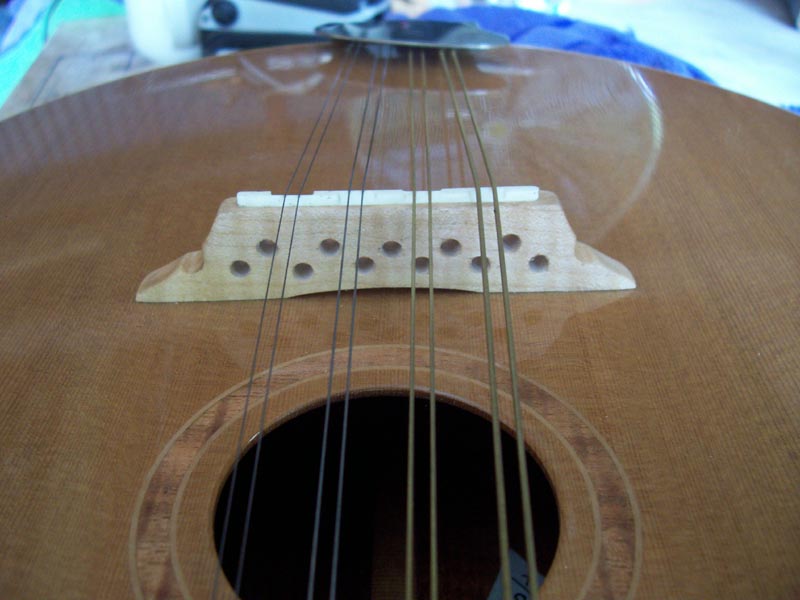

The finished Bridge
Before anyone starts to feel sorry for me because they think the Mastotermies have got to my new Mandolin, stop worrying, the holes were a design by Red Henry. Sebastiaan pointed me in the direction of Reds website so I thought I would give it a try. I did notice a variation in the way the Mandolin sounds but not a huge difference. I will try some of his other designs next time.
