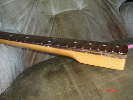

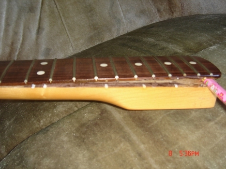

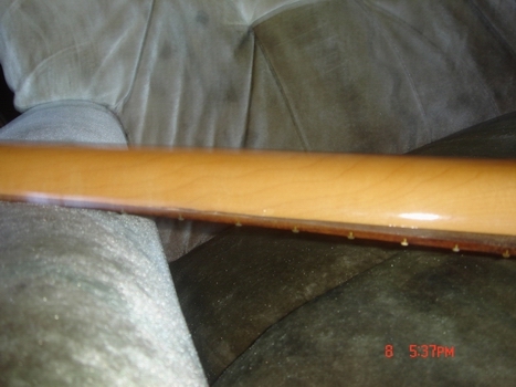

Here are some pictures of the mess I inherited. The person started from the 22nd fret end and it's pretty clean until the 8th fret where he's forced it and there a slight crack. Then he proceeded to hack saw (I presume) from the nut end. What do you all think? Re-glue or replace?
I would replace the board. If the PO has used a saw of some kind the kerf it took is wood lost and for all the futzing around you would face trying to save that mess, a new board would be easier by far. Follow Jim's procedure above and you should be right but don't go damaging the actual neck wood if you can avoid it at all.
Once the old FB is off you can clean up the neck surface ready for gluing the new board with a large sanding board but you will need to go steady and be sure to keep things flat. It is hard to tell from the pictures but depending on the neck itself, it may require some kind of jig be made up to hold things level while you clean up, it all looks kind of nasty.

Wow, the mind boggles, what was that person thinking. Hacksaw a Pao Ferro fret board off SRV Strat, I would like to know why they attempted it, is ther some other problem that can't be seen now like a twist or bad bend. I would do my best to salvage that but it doesn't look good, as Kim said the kerf they took out is a bugger. It is hard to tell from the pics but personally I would still try to salvage it. A couple of points, how much did you pay, if you got it cheap enough then one option is to get on to fender and they will replace it with a neck that is the same, those necks are a oval profile with a 12 inch radius fret board so you cant use any old fender neck of ebay. It won't be cheap though. Again if you got it cheap enough then it will be worth spending a few hundred bucks on to get it repaired. Kim is probably right about the fact that it may be easier to just replace but these models like to remain original if possible, for values sake anyway.
I would like to hear how you feel as it is your guitar, do you want it kept original? and if so what sort of budget would you be willing to go to to fix it?

Thanks for everyone's comments. The previous owner said the neck was twisted or warped but I really don't think it was. I will take the fingerboard off, don't think I can save it. I have a compound ebony board from Stew Mac ready to go on. I'll keep everyone posted. It's real shame but it doesn't look like an easy fix.
