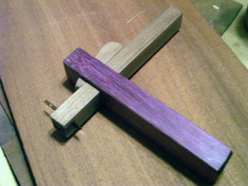

Well, it was a good weekend, all in all. I knocked together a Sylvan/Wells rosette cutter, a gramil for Jake and started thinning a set of walnut sides. The sides have a bit of wild grain. Just enough wildness to cause a some of tear out. The card scraper works a treat but my forearms feel like they should belong to Popeye. They were at .130 when I started. They are only down to about .100 now, so I still have a bit to go. But if nothing else, they are hammering home the fact that I need to get a thickness sander put together. I have all the bits and pieces, but just haven't gotten around to doing it. I think it just got closer to the top of that TO DO list.
Sorry about the photo, the camera was dropped and we haven't gotten around to replacing it yet.

Nice looking gramil.....might have a go at making one myself.
For rogue grained sides I use a scraper plane.....better for removing large amounts of material than the cabinet scrapers and you dont get cooked fingers. Ive got two scraper planes...a flashy new Veritas and my favourite...an old Miller Falls job from the 1940's.

Very nice Gramil there Lillian. The drum sander is the most indispensable tool in my shop now. God knows how you'd ever go without one after using it for even one guitar.

hey lillian, very nice looking gramil :) cant wait to get my hands on it :)

Beautiful looking work Lillian my friend and it matches my cowboy outfit and Dyson vac too.

is there instructions anywhere on how to make a gramil? it doesnt look to hard so i'd be keen to give it a shot

Thank you gentlemen. It turned out alright. The proof of course is in the pudding, so Jake will have to pass judgment on it.
Josh, I don't know of any instructions out there. I copied the one I have, which is made out of metal. If I were to make another one of these, I'd make the body deeper and put the wedge in from the side, or use a thumb screw. It really wasn't hard to make though. When I get home tonight I'll see if I can put together a mock up so you get the idea. The part that made this a success for me was that I happened to have a couple of set screws on hand, which is what I used to hold the blade in place. I used some dense wood that I found in my small scraps box. The rest is walnut and purpleheart. And that was because they were the right thickness already.

I love handmade tools. That gramil is goregeous!

What a fantastic little gramil. Beautifully made ( and I love the Purple :D ) . Above all though , a wonderful gesture Lillian.

That is a very nice looking tool you've made there Lillian. I might just have to make one for myself once my uni exams are finished for the year. Any extra info you could give about how you made it would be greatly appreciated.
