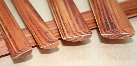

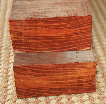

This is a block of 'Rengas' aka 'Borneo Rosewood
Shape it to leaflike profile

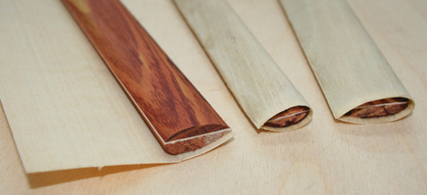

Wrapped and superglued with maple veneer

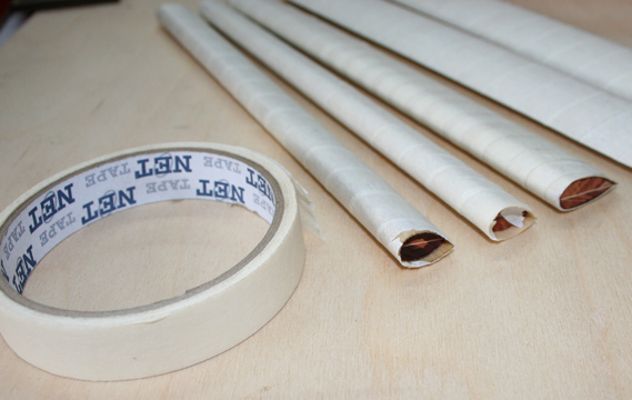

Another layer of masking tape to prevent spilts

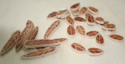

slice it to about 1.5mm thick

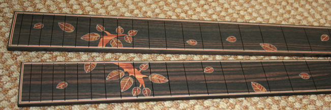

works well with the dark blackground.
