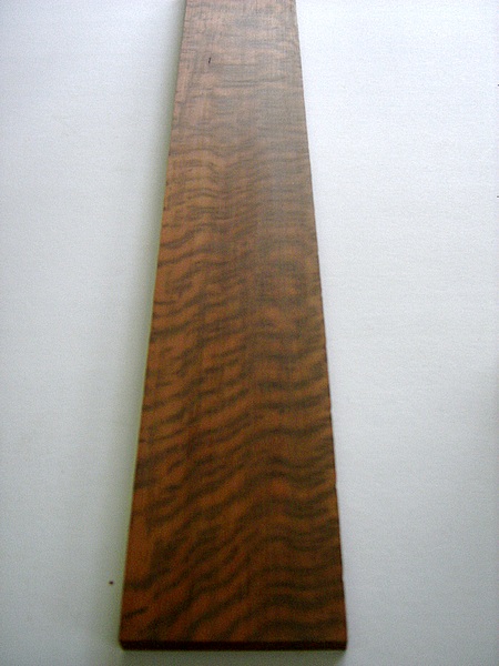

I've managed to get quite a few pieces of Tiger Myrtle off Tim over the last few years. ( Many thanks Australian Tonewoods ). I always weigh my wood when I get it on a gram per cubic cm. basis.
Tiger is usually around .75 to .8 ,and I wouldn't consider it for fretboards normally , but I received a more unusual piece which weighed .93. This is easily comparable with a lot of my Rosewoods ,in fact heavier than some . It's of the darker Myrtle variety
I was attracted to this piece as soon as I received it, as it is the right dimensions for fretboards ,, and being the heavier weight I thought may just suit on my tiger Myrtle project . As a matter of fact I had my heart set on it as fingerboard and bridge , as it would look so cool .The guitar will also have a Tiger neck . Some of you guys have me a bit concerned now
This piece seems to be durable enough . I know my bandsaw had to work when cutting it .
What do you reckon ??? What would you do ??

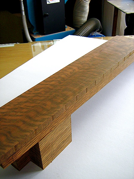

Here's a couple of pics :

I sent some test pieces of various aussie woods to Larry Davies of Gallery Hardwoods so he could run them through his patented acrylisation process.
The wood is placed into a bath of acrylic solution inside a specialized high end pressure chamber. The chamber is then put into negative pressure or vacuum which over a period of time will cause the cells in the wood to give up or expelled any trapped air. The chamber is then switched over to apply positive pressure which refills the wood cells with acrylic.
The effectiveness of this process is largely dependant upon how much a acrylic a chosen species will hold and this is measured by weighing the test pieces before, and then after the process to give an indication of the uptake. Some wood just does not suit the process and with things like ebony and other very hard species there really is not much point anyhow.
But for softer woods, if the uptake is good, then the process is very beneficial, especially for things as pen blanks, which if you add a dye to the acrylic will colour lighter woods like high figure maple etc right through, and of course fretboards. Not only does the process stabilize the treated wood because no moisture exchange can occur with the wood cells now filled with acrylic, but also you get a very high wear factor and the bonus of a finish IN the wood.
The great news is that of the test species I sent to Larry, both Tassie Myrtle and WA Sheoak had very good uptake of acrylic and therefore suit the process well. The bad news is that the AU is crap to the greenback now and the to and from shipping would be a killer.
Still, if you really want to go with Tiger Myrtle, have the luxury of choosing any colour sample you desire, eg a lighter coloured piece with larger black spots that would normally be considered too soft and have no need to worry about those issues mentioned above, it may be worth contacting Larry when he gets back from his diving working holiday on his gold dredge to see what it would cost you to have a couple of board treated.

Cheers Kim, Steve and Sebastiaan . I'm optimistic of a getting a good result one way or another, especially after your link thanks Sebastiaan.
Steve , I was one of those who got his fingers burnt with that Hard shellac crazing earlier on , and I'm not keen to give it another shot ,,,,well at the moment ..... Besides , even though it's a fairly hard finish , I doubt it would stand up to string wear .Thanks for your suggestion though mate.
The Tiger fingerboard I've cut is just too tempting and too cool not to try, and as I said ,it's a fairly dense piece in any case.
Time for some C.A. testing !!!
