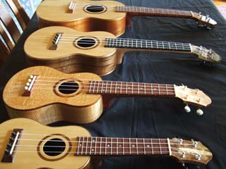

Hey , they're nice looking Ukes you've made there ! :D
