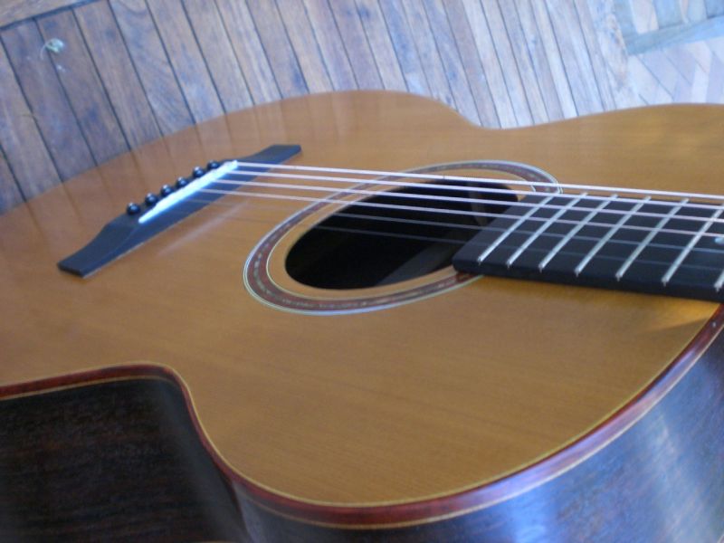

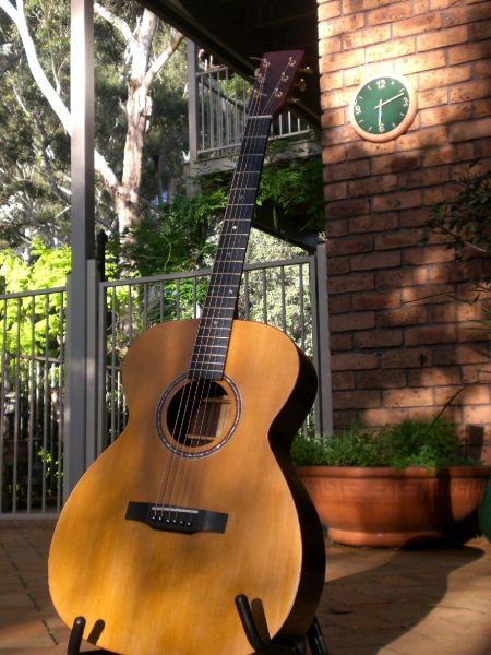

Yesterday Jack (my 17 yo son) and I strung up the OM that we have been working on for about 10 months. Such a great feeling to get it done and find out that something that we built actually plays well and sounds great. Learned heaps along the way - much of it from you gentlemen.

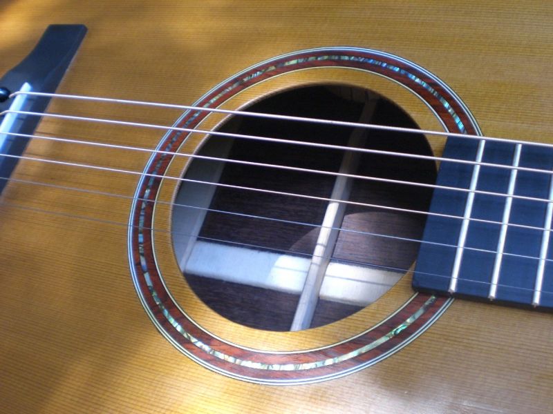

It is EIR and Western Red Cedar that I got from LMI. I am particularly pleased with the cocobolo/maple bindings and the cocobolo rosette. I don't think our Taylor is going to get played so much now. I have already been out to buy the wood for number two - seems like I am hooked on this hobby now.
There were plenty of mistakes but we covered most of them up pretty well. We haven't fixed the alignment of the 6th string tuner yet, strung it backwards for now. The finish of the top also bugs me a bit - my first experience using shellac and it looked pretty good until we tried to get a satin look by finishing with wax applied with 0000 steel wool. It left an inconsistent look, still shiny in some places and cloudy looking in others. I intend to tinker with it a bit more. But overall we are well chuffed.....Image

Great job! I wish my first guitar had come up that well. Looks like you've taken your time and done a top job with the trimming (bindings and rosette). I wish I could give you some advise on getting a good satin look with shellac. I've tried scuffing it up using steel wool and abrasive powder on a soft buffing pad but wasn't happy with the results. I suspect that etching it with some kind of chemical treatment would work better.

That's a lot better than my first attempt. :D The rosette is beautiful. Overall, a fine looking instrument. Isn't it good to know that on your first attempt you can build a guitar that sounds as good or better than a $2000 factory built number?

We tried to copy the neck profile and the setup measurements from the Taylor, and the overall feel and playability came out pretty similar. The action is still a bit high and it hasn't loosened up much yet, but with some more setup tweeking I think it will be good. Do you find that the feel and playability of a newly built guitar changes quickly? We have certainly noticed big changes (improvements) in the complexity of the sound just in the first 2 days.
One dilemma that I feel is how much I should try to correct the errors (like imperfect finish). I guess it is much more sensible to accept imperfections, learn and move on to the next build. A classic error is the slight malalighnment of the tuners which means that the 5th string runs into the 6th string tuner (curse that narrow Martin-style headstock design - no room for error there). We have put the 6th string in from the outside just so that we could get on and play it - but I'll probably want to go and move that 6th tuner some time.

I wouldn't be too concerned about finish imperfections . Particularly as it's only your No. 1. Getting a good finish is one of the most difficult things to master .
Next time , try making a template for your headstock first . This will aid in drilling the tuner holes , and also give you an idea of how the strings will line up.

Looking through the soundhole ,I can see some of your very neat and careful interior work too ! Great effort Mark .! I know you'll both get an enormous amount of pleasure and pride when playing it :cl

I'm a bit late, but none the less very impressed. And for me the bindings and rosette really show off the care to detail that you put into this instrument. They look fantastic.
I've stuffed up the alignment on tuners before too. It's not that hard to plug the hole with a hard wood dowel, then re-drill in hopefully the correct spot. It's amazing how even 1 mm off will draw your eye.

That back brace just south of the waist looks interesting. It looks very low...almost like a patch rather than a brace. What's going on there??

Martin, the back braces were according to a plan which copies the Martin-style. The top two back braces are tall and thin (13x6mm) and the lower two are short and wide (6x19mm). This seems common on Martins, including a D-18 that I have in front of me now. I don't know if it makes any difference? Probably makes it easier to retrieve dropped picks.
