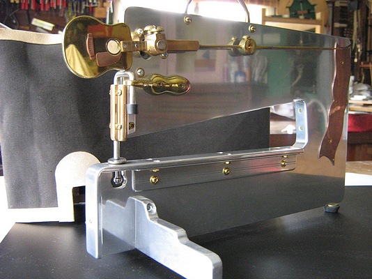

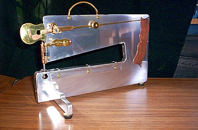

Post by Craig » Tue Oct 14, 2008 9:46 pm
Cheers Allen . These have been posted before , so a lot of you will are probably sick of seeing them .,,,,blame Allen :lol: .

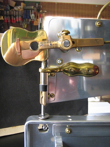

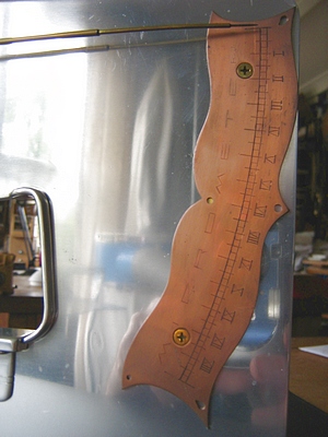

Made of scrap Aluminium , Bronze , brass , copper and steel. It can easily be recalibrated although I've not had to . It's in metric.
The centre spindle has tiny needle bearings ( off an old record player ) . The upper bout of the little guitar becomes the cam. Note that under the probe ,the bottom anvil ( I think that's what it's called ) moves to suit any angle the wood is presented . It's bottom is radiused on the some tangent as the probe's tip and sits in a bronze rimmed hole which lets it move around and seat at any given angle , but remains at a constant distance .
I didn't have any sheet copper lying about, so split a copper pipe , annealed , and flattened it out to make the guage
Cheers guys

I'd never get sick of seeing this, Craig. BBBBBBBBBrilliant !!!!!!

That is unbelievable :shock:

That thing in ingenious. I want one of those Craig.

I remember very well a few years ago when you first posted images of this wonderful piece of art at the OLF. Not surprisingly, just like everyone else who frequents the same guitar building forums that you do, I have never tired of seeing this amazing thing of beauty and have remained in awe of your skills as a craftsman ever since. Just like everything else that you do you bald headed git, this is truly exceptional work 8)

Craig that is one beautiful tool that you made there!!!

Craig, your thickness gauge puts most designs I have seen, mine included, utterly to shame. What a beauty!

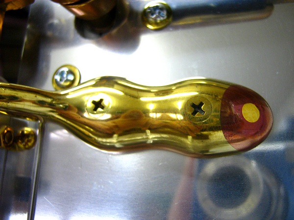

Paul B wrote:Hey Craig, that one doesn't have any inlays does it?
It does have a small one actually . You should know better Paul :lol:
I carved this bracket out of a lump of scrap brass and joined a piece of Copper to it's end , into which ,a Brass Dot .
