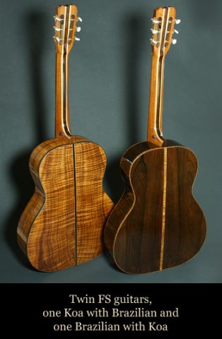

Allen, I've done that. It wasn't for an experiment, but at a customer's request. He sent me one set of Brazilian, and another set of wildly curly Koa from his own personal stash. (And just why can't we get more customers like that?!) I used sequentially cut Sitka tops, identical in every way. Braced them alike (bracewood was cut from same slab, etc.), same shape, everything.Allen wrote: I suppose the next line of experimentation would be to use tops cut from the same plank and braced identically and change the back / side woods.
Who's up for the challenge?
And the sound? Quite different between the two.
The Koa had a real sparkle...light, airy, shimmery.
The Braz was dark, rich, complex, and I'll say it again, dark. It had a sound that would really project, while the Koa was all in your face.
It would be fascinating to me to revist these guitars now, to see what age and "opening up" has done for them; if they've kept their uniqueness, or have moved more toward each other's sound.
Anyone have experience with that? (What time does in such an experiment?)

Ok, let's see if we can get one up:sebastiaan56 wrote: Steve,
How about a photo?
The Koa guitar is trimmed out in off-cuts from the Brazilian body, and conversely the Brazilian is trimmed out in off-cuts from the Koa body.
Even the neck pieces were cut from the same timbers:
mahogany, hard maple and rosewood.
Thanks for asking,

Hi Steve,Stephen Kinnaird wrote: And the sound? Quite different between the two.
fascinating how the visual and audio descriptions of the two guitars match so closely. Lovely guitars
